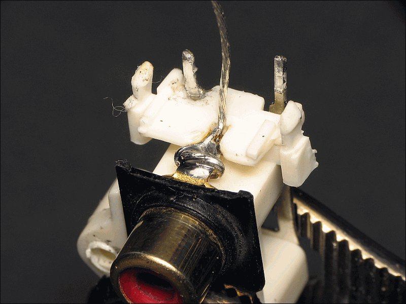

Im repairing a 400a4 rockford amp have found that the rca inputs are bad. I cant seem to get into them to try and repair. Is there a way to repair them? Is there someway to buy replacements from someone?
seankane probably has them.
They can generally be repaired but if you can get replacements for a reasonable price, that would often be the best option.
Ok i was looking at them a little more i may have found a way to solder back connection if i cant i will pm him, thanks Perry
Yes its the grounds that are broke i was gonna try and thro solder on broken joint but thats alot better looking fix i will do that thanks Perry
