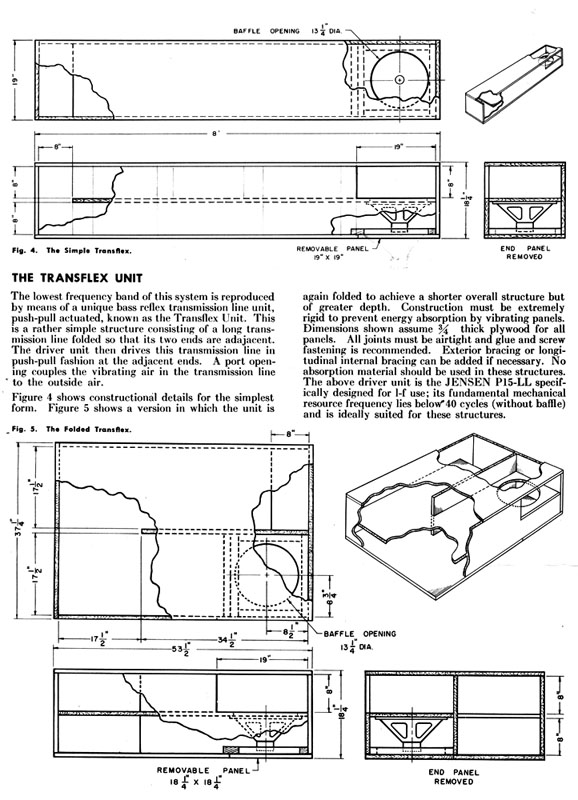

Hardly! I got my first 'taste' cloning Jensen's awesome 1952 TL 'sub' [tapped, though didn't understand the concept at the time] that led me to finding Voigt's patent among others, so it seems reasonable that it and Voigt's designs stoked many folk's imagination also:

You know, I was thinking of the Transflex when I typed my original post, but eventually decided not to include since it wasn't tapered -I've a bit of a soft spot for that box; didn't realise it was as early as '52 though. Thanks for the heads up. 🙂

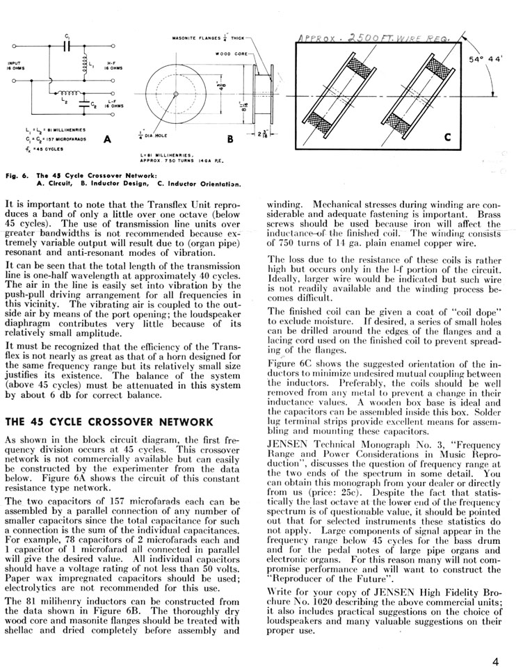

You're welcome! Scans courtesy of FreddyI.
I don't have a copy of the book for the details, so speculating a low 30s Fp assuming a BIB type. Brave indeed for a 3"!
GM
