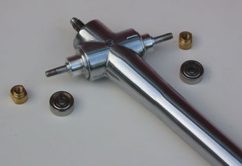

Replacement bearings are about £4 each from RS components and all 4 are the same. do resist the temptation to try high-precision bearings in standard Rega mounts as the location isn't accurate enough for them and the results will be far worse than ABEC3 bearings. The RS ones are ABEC5 which is a bit tighet for this application, so running them in well before installing them is well worth the effort. [/B]

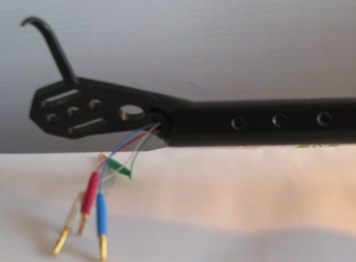

I rewired my RB300 in just 1 hour, without disassembling anything. Mine came from audiogon without wires in it, so I had to re-run a small wire first to pull the new wires.
I used a small wirewrap wire that I ran first into the arm going from the bottom of the toenarm pilar, then through the small hole under the tube (between the axis, the touchy part), then up to the exit at the headshell end.
The new wires were soldered together, then I solder it to the pull wire.
Then I simply pull all the wires back from the pilar entry up to the end of the tonearm tube.
It was easy. Bearing removal is certainly not recommended since you don't have the proper tool to readjust the bearing, etc...
Bye.
Bye.

I've been trying to contact Jeff re his offer to supply his revised RB250 bearing kits but I've had no replies to my emails
. Anyone know how else to contact him?
Jeff: if you're out there, please get in touch

Well, I managed to make it last night. Not that difficult with a Dremel and a masking tape.
BTW, what kind of foam do you put into the arm tube ?
Pascal
Hi, sorry,
I've been away for the last couple of weeks, and I think there has been a problem with the "william-reed.net" email address - I don't have any emails in the "in" box, but I think it's working now. If not, try "jeff.spall@william-reed.co.uk" instead - I know that's OK.
The kits are progressing slowly, I'm working through a set of ten and so far have the materials, the bearings and a set of arm yokes and I'm gradually building jigs to make the parts. It actually takes far longer to make jigs than to make the parts, but when you're making more than one of anything, it has to be repeatable.
I had just realised that, although I've been using Rega arm tubes, my bearing assembly would work with any home-grown arm tube.
Well done with the drilling Pascal, you mst be more careful at this stuff that I am! I've not filled an arm with foam, although I'd always intended to. The main reason is because I'm still experimenting and once an arm is foam filled, you can't get the wiring out again!

The tip is to use first a fine drill then to use the hole as a guide for the final drilling
Concerning the foam, I intended to do something "à la Michell". But the problem is that I have already rewired the arm... So unless I can manage to insert some foam into the holes, I fear it's too late...

jeff spall said:I had just realised that, although I've been using Rega arm tubes, my bearing assembly would work with any home-grown arm tube.
This is of great interest to me. I only resorted to modifying the Rega when my home-brewed arm failed to perfom through lack of proper bearings. I reckon your kit would be just the job.
I'd be grateful if you could let me know when you have the kits ready to sell. I've sent you another email as well, just in case.
