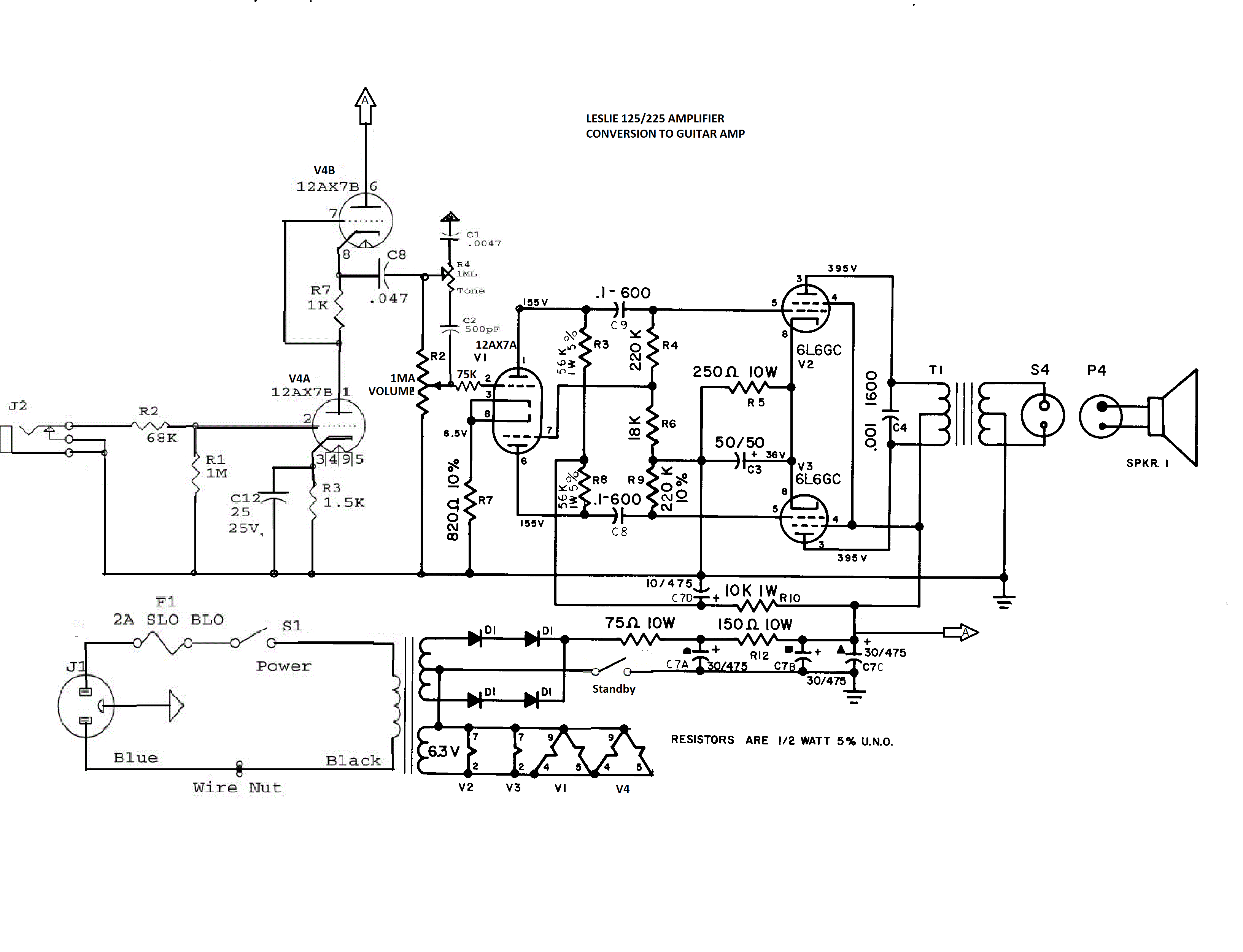

Sorry, just does not work that way.You can not just take the one input to the Long Tail Pair inverter and hook it up to the voltage divider of the Paraphase phase inverter. The LTP is expecting to see an AC ground and the input to that tube comes from the voltage developed across the shared cathode resistor with the other triode. You either use the PI circuit as shown in the Smokin Joe or you use the Paraphase inverter you have.
Sorry, I totally fail to see your point?.
The circuit the OP posted looks perfectly viable to me - the first triode, with an active anode load, feeding the differential amp phase splitter (long tailed pair if you like).
EDIT:
Just noticed a mistake on his drawing, the anode of the active load should go to the +ve of C70.
Is that a mistake on the second, newer drawing i've made?

I have clean amps out the yin yang... i want something different. Whether that's Vox AC15 sorta 'chimey' or whether that's 2x6L6 tweed style 'bluesy' ( which is what i THINK i have right now )....i don't care. It's a blank slate. I just want an amp i can say i converted, and that ultimately sounds and works well. 🙂 ( and i hope to learn something in the process )
The other thing i was wondering about, is that i have what is clearly a Fender Tweed style tone stack. Can and should this be swapped for a more versatile Baxandall tone stack?
ala this pic...by just subbing it in after the bypass cap and before the PI ?

Yes, on them both.

That will probably drop the gain considerably, in which case (and if you're wanting more gain anyway) I would suggest dumping the active anode load, and using the second triode as a further gain stage.
EDIT:
Don't have a problem with the preamp circuit. If you care to explain how that PI will work better than the original paraphase or the LTP I am willing to learn. I missed where the high voltage was taken for the first stage, good call.

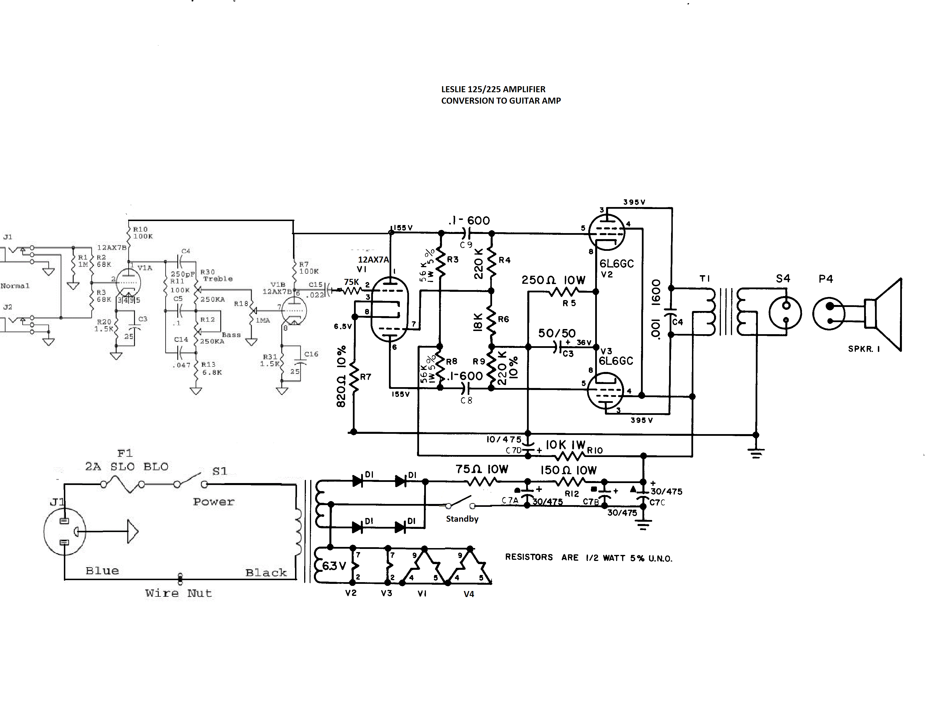

You could try that but I think the previous version would sound a little more different as you already have a good palette of Fender tones.OK, Nigel...i went back to the drawing board, and tried another twin triode / twin gain stage schematic. WHat do you think of this one?

You're still connecting the new preamp power supply to the wrong place, it needs to go to the positive of C70.

AHHH!! I get what you mean, now. I couldn't figure out what you meant by C70... but it's C7. Got it.
See attached changes to my 2nd revision
1) is this new schematic feasible? ( with the obvious needed addition of a plate load resistor in between C7 and the new 12AX7 stage 2)
2) any ideas on the value of that plate load resistor?
3) Say i want to run the PI with a higher plate voltage, but leave the 6L6's alone. That would require adjusting R3 and R8 to lower value resistors, right?
4))And by changing the plate voltage, would i also not have to rebias by adjusting R7 to match ? ( commenting only on the components of the original leslie, not on my bodged on front-end )
Not quite the right place, the other side of R10 (where the existing triode is fed from).
You don't need an anode load for the circuit, the top triode is an active load.
I don't see why you would want to alter the phase inverter voltages?.
Roger on the power for the active load. I think i understand now.
