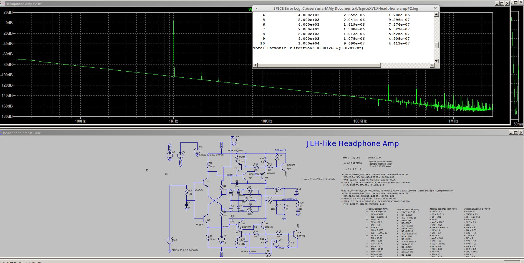

I have referred to my "JLH-like" amplifier design a number of times but haven't shared exactly what differentiates it from the original. So here it is:
The main differences are that the input transistors' emitter resistors are terminated in +/- 4V rather than the full supply rails ( they're produced by a pair of on-board LM317/337 voltage regulators). This allowed me to significantly drop the emitter resistor values, which increased the OLG. In addition to that, I didn't see any reason to use the original design's rather low-value collector-load resistors because the auto-bias feature takes care of any excess current. That also increased the OLG. The 71.5K resistors can actually be eliminated without causing much of a problem. Finally, I added two transistors that converted the output stage into a Darlington-pair. That also increased the OLG. Other than those mods, it's vintage JLH 🙂
While the simulations didn't show any tendency to oscillate, the actual circuit turned out to be marginally stable. Under some conditions it DID oscillate, that's why I added the Miller capacitors. In addition to that, I finally had to insert a series resistor in the input line. Called it a base stopper, damping resistor, whatever terminology that's currently in use. The combination of the high Ft transistors I used and higher OLG did turn out to be a little more challenging in terms of achieving circuit stability.
BTW, Q13/14 are there to explore some ways to reduce the amp's turn-on transient. Due to the 100uF capacitors in the auto-bias control loop the initial idle current in the output transistors is pretty high. It also produces a substantial "thump" if the headphones are plugged in when it's turned on.
