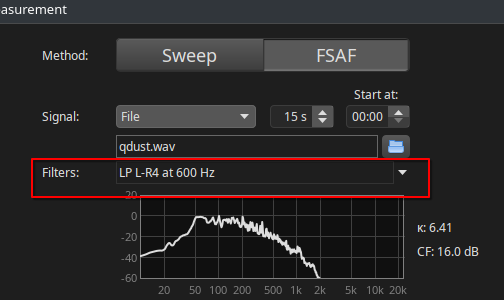

At least for simple filters, the drop down options on the FSAF measurement window should be fairly straight forward.

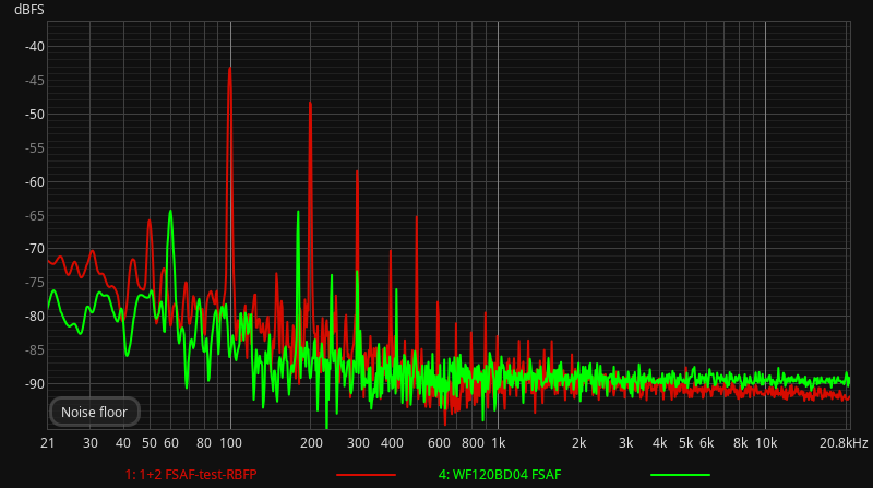

Reviewing @JanRSmit measurement, great to see that you're having some success. I do note that you're reaching 1% (-40dBr) from power supply hum at 100Hz, perhaps a different amplifier with cleaner output would be helpful. That noise comes through in the residual quite clearly when listening. I also didn't use a very high end amp for my testing (and with linear power supply), but for comparison I will provide an overlay of your noise floor vs mine. (yours is the red one)

Thanks @DcibeL , both for the filter option and the mains hum issue. But above all that the test setup indeed works. I have a good amp available so that willl be next mod to the test rig.
What is a good approach to listen to the residual noise? How to increase the level without issues?
The spectrogram i played with, the problem is the interpretation. The mains issue is clearly visible, the issues in the useable range of the tweeter are not so.
