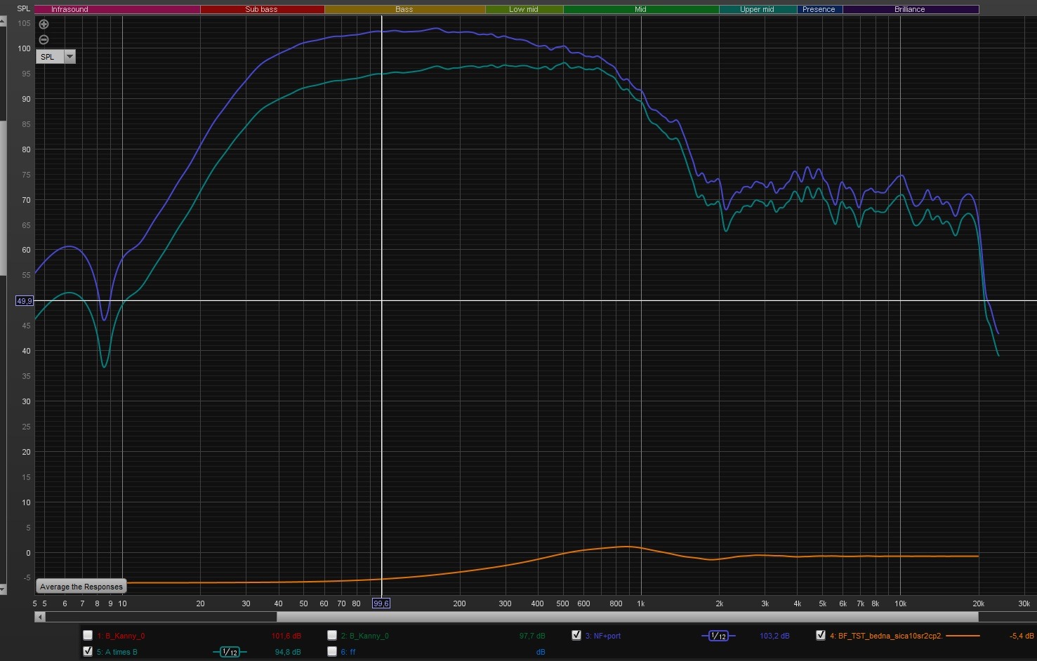

Hi, please I'm completely confused with REW (5.20.13) basic A*B operation result. I'm trying to multiply my response (nierfiled + port) with bafflestep response (generated by Diffraction & Boundary Simulator 1.30 aka DBS). All each freq. responses seem to be ok, as well as DBS .FRD output - see attached pic. But when I make A*B - (NF+port) * BF.frd the result is strange. It's not possible to have more then -6dB difference in final response, but there is more, about -8dB@100Hz. What's wrong here ? It seems, there is an 3dB offset - very suspicious number, isn't it ?

You can see in the response >2kHz where you should see near 0 difference, you have about 3dB difference. Check offset values used. Problem likely in step 4 of the linked instructions if that's what you're trying to follow. Quick fix would be just to adjust the amplitude to overlap original response at 10kHz, however it may be useful to determine where you went wrong in your steps.
The link is a rather silly instruction FWIW, overly complicating what could be a simple process, splitting work between REW, Jeff B's old diffraction spreadsheet, then eventually bring into VituixCAD. All tools required are in VituixCAD and will result in a much easier process. As well, the brick wall window (tukey 0.1) shown is step 3 will result in a fair bit of overshoot on the low end of the far field response as well.
I don't know anymore what to do for that kind of posts. Feedback is ignored and too complex and partly wrong instructions continue forever as sticky threads. REW is needed for measurements and exporting time-windowed far field and near field frequency responses. VituixCAD has Diffraction, Merger and main program which can do the rest in every case. So the process has six phases:The link is a rather silly instruction FWIW, overly complicating what could be a simple process, splitting work between REW, Jeff B's old diffraction spreadsheet, then eventually bring into VituixCAD. All tools required are in VituixCAD and will result in a much easier process.

5) Simulate and export baffle effect response with VCAD Diffraction
6) Load all FRDs to VCAD Merger, set parameters and Save with Feed speaker checked.

Applicable for all baffles for neafield measurement, standard procedure for merging nearfield and far field responses. It's what the merge tool in VituixCAD is for in step 6.
Nerfield measurement provides half space (4pi) measurement data, up to the frequency limitations of the driver size. See auxillary -> near field section of VituixCAD for some specifics on neafield frequency limitations.
