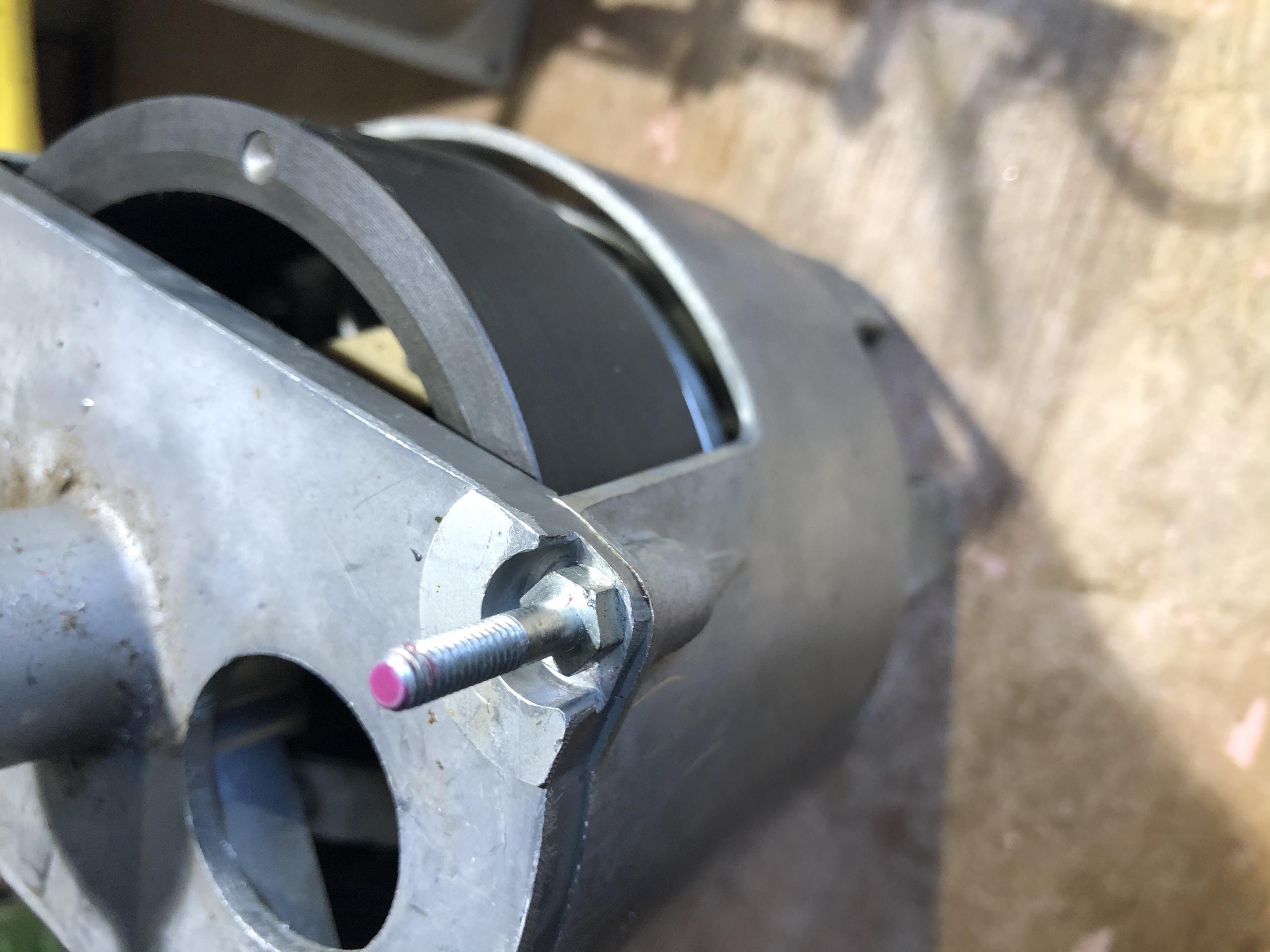

One other question.... I want to clean the old grease from the capstan motors and relubricate it however I can’t find the right tool to take off the 4 studs. What can one use or any tips of what the tool should look like please? It’s not easy to grip the nuts to undo them.

To remove those bolts, I modified an 8mm deep socket. The socket is too thick to fit in the recess, so you need to thin the wall. Easy if you have a lathe. If not, spin it with a drill and file down the end of the socket to make it thin enough to fit.
Be careful when you rebuild the motor and don't overtighten those bolts. They snap very easily. I had to fasion a new one from threaded rod and a couple nuts.

Thanks for the tips. I did think of thinning down a hex drive however I did not try on a lathe as I would have thought that it’s hardened steel and would be a tough job. I was lucky that I managed to ease 2 of them with flat nose pliers at the end... originally I was attempting to carefully undo them by holding them with a grip vice from the thread by applying gentle pressure but was afraid that they would snap.
After I took then off I could see that one could replicate it then with a threaded rod and a nut! I just can’t understand why it’s been manufactured in such a way to complicate matter when it comes to servicing them!
