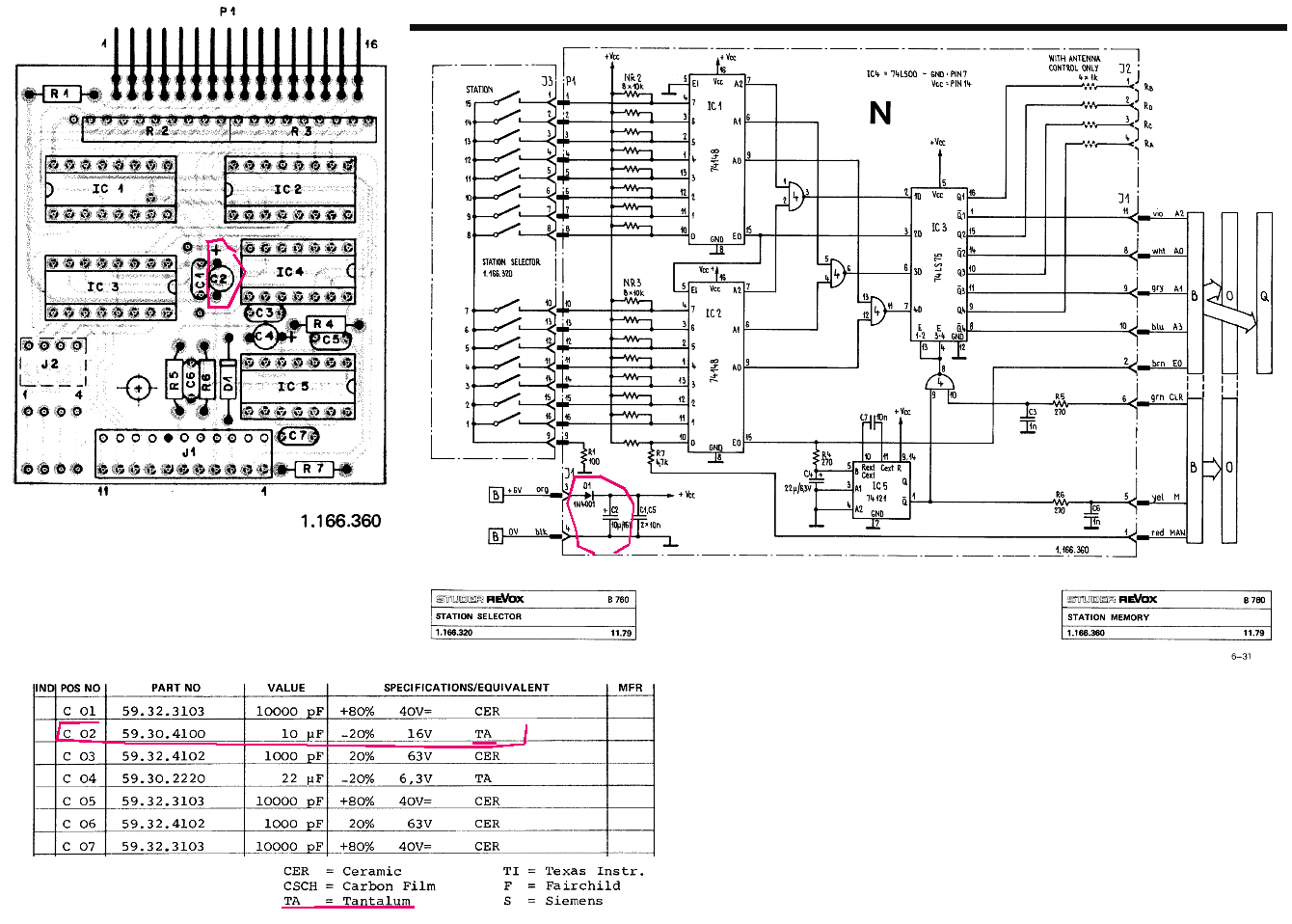

Guys, is there a ReVox B760 tuner expert in the room? Mine is suffering from advanced Amnesia, it just evaporates station memory. When not used for months, after power on, I can program some stations which it will keep for few days. After that they are gone, and cannot be re-programmed at that time. Putting it away for some months, it seems to recover and allows to be programmed. For a day or what..
Familiar with this, please let me know (guess I need some new memory board/chip of some kind..) Voltages are OK, I remember I measured.
The sticky (yes, that awful paint) bastard is of no use right now..

If your tuner can memorize stations for at least some period of time, it means that voltage and register shifters on the station memory module 1.166.370 are OK, but the memory chips, namely IC01, IC05 and IC08, are failing and have become volatile.

Did you replace the battery connected to the Frequency Memory board, under the lid?
There is also a Tantalum cap on the Station Memory board.
