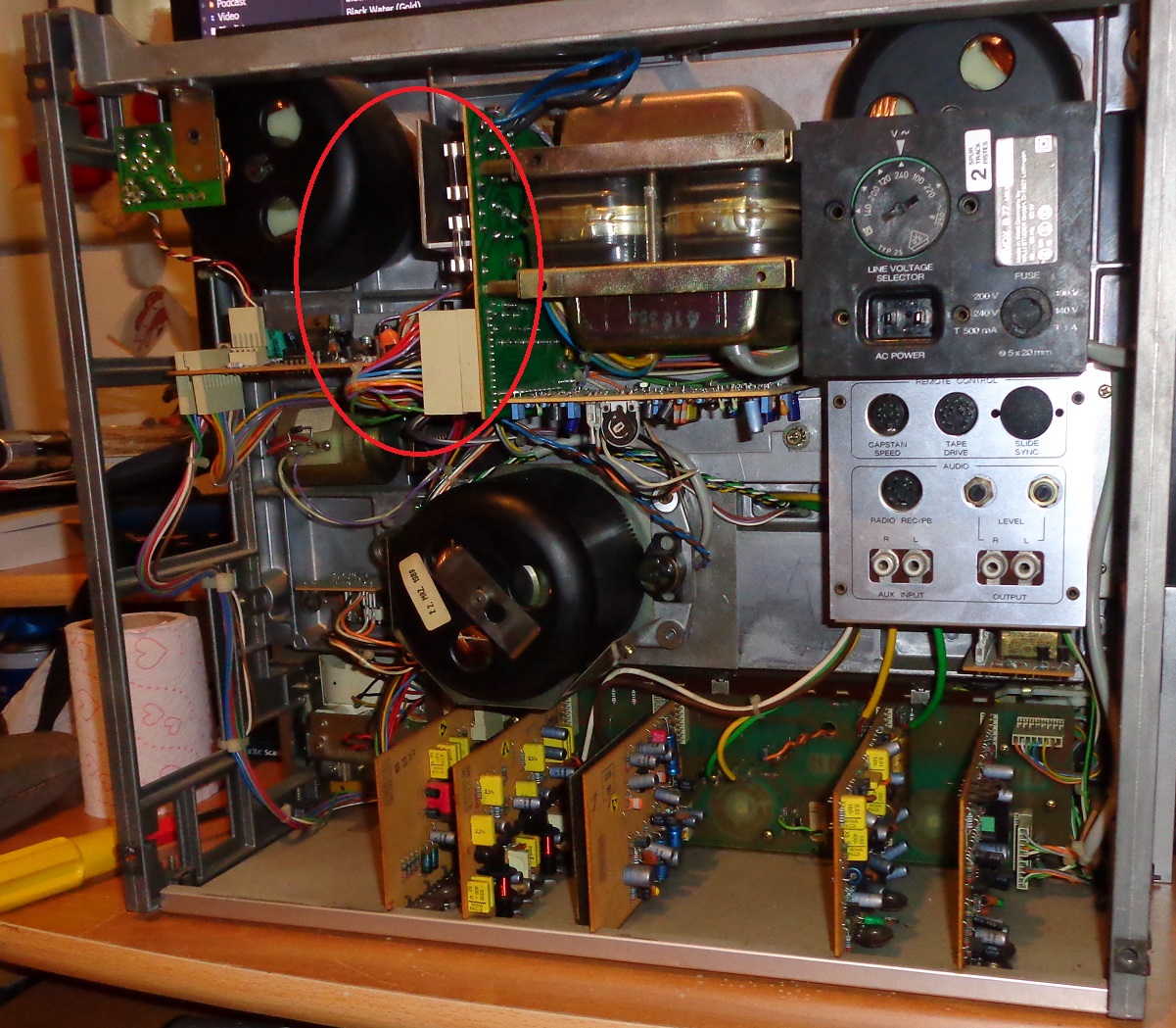

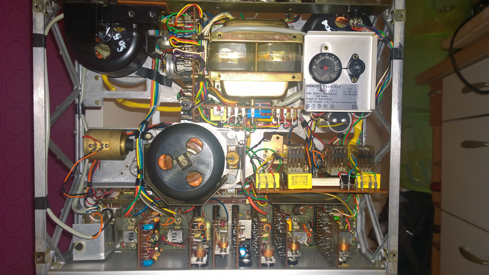

How do I get access to the power supply fuses? I don't know where the fuses are, other than the main fuse in the back panel.
I did not remove the wood case, these photos have been taken by the previous owner.

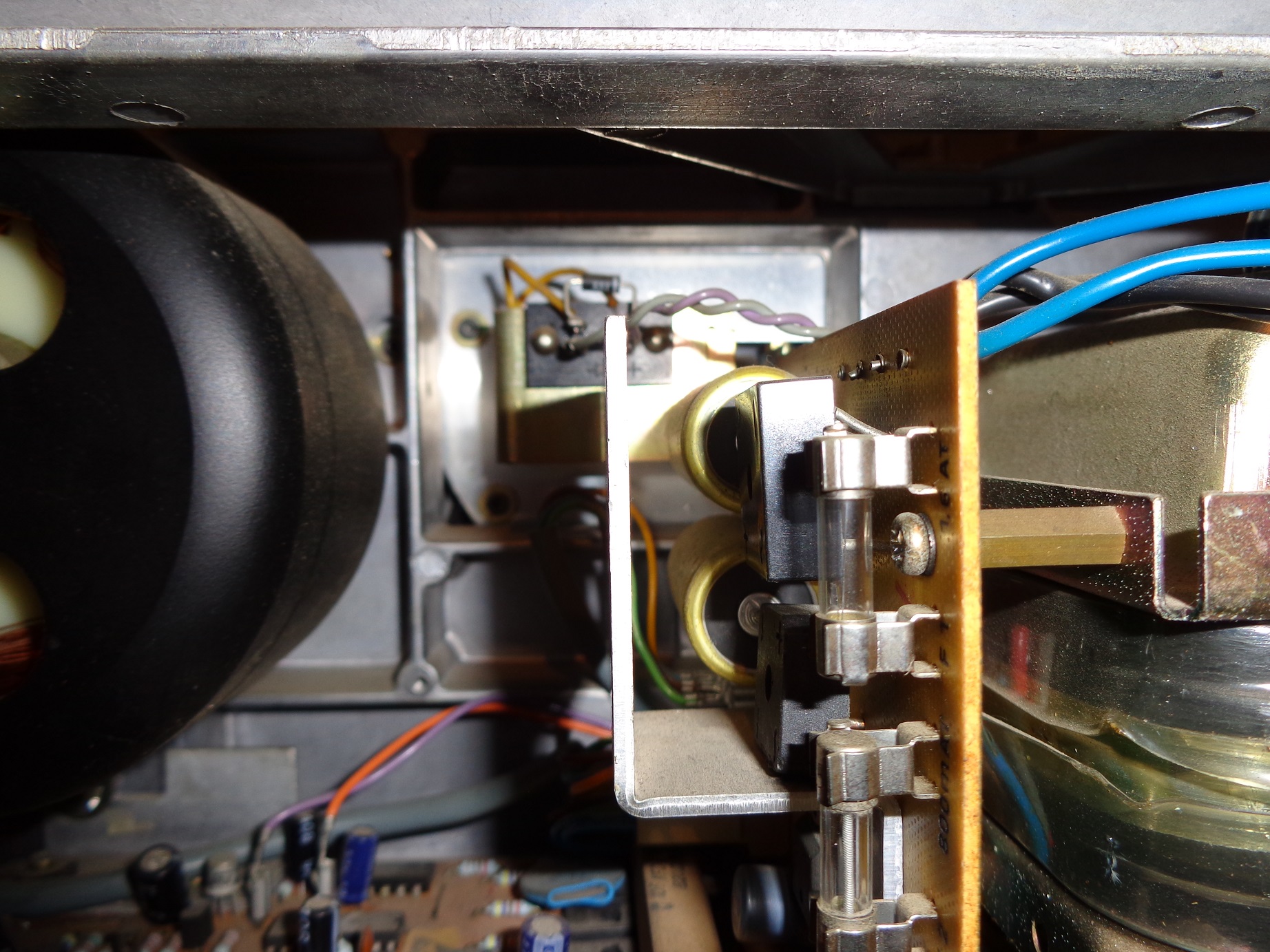

There are three fuses in the A77. Their locations are shown on a copy of one of the photos you submitted. FS101 is pretty clear – it is in a fuse holder right beside the mains voltage selector. FS102 and FS103 are harder to see in your photo, but they are on the power supply board. Fuse ratings are:
FS101: 0.5AT for 220v – 250v supplies, 1AT for 110v – 150v supplies
FS102: 630mAT
FS103: 2AT
[/URL][/IMG]
The location of FS102 and FS103 is clearer in the photo of the power supply board; this diagram is taken from the A77 service manual.
[/URL][/IMG]
