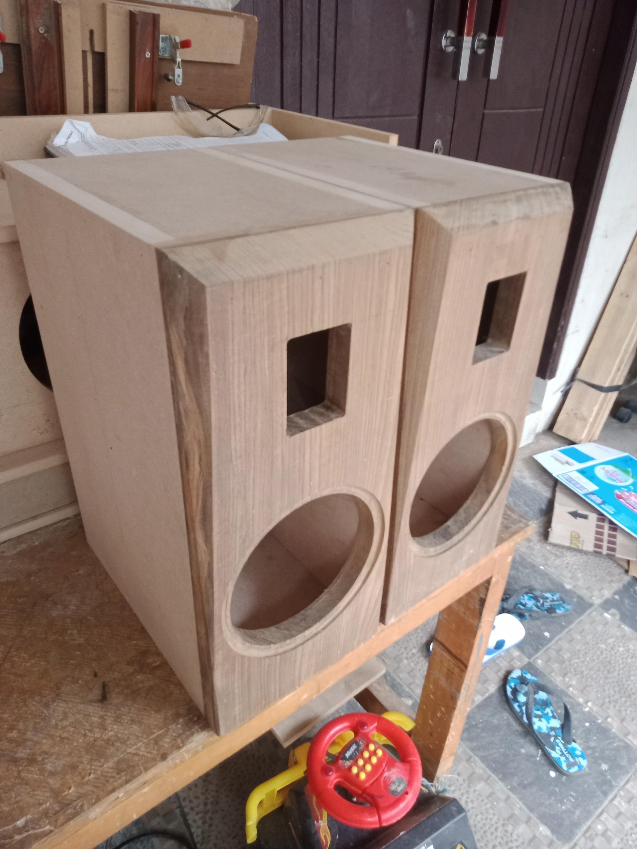

Front Baffle Diffraction Treatment
For the front baffle, which one is better between a 45 degree chamfer, a 1/2" roundover or a slanted chamfer like the picture below?
The oval PR from SBA has only small linear excursion , too stiff a suspension!
And the straight plane segments of the paper cone are easy to vibrate , add a damping pad there on both segments ...
This PR is only suited for low playback volume and not so low tuning frequency!
