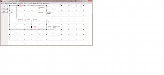

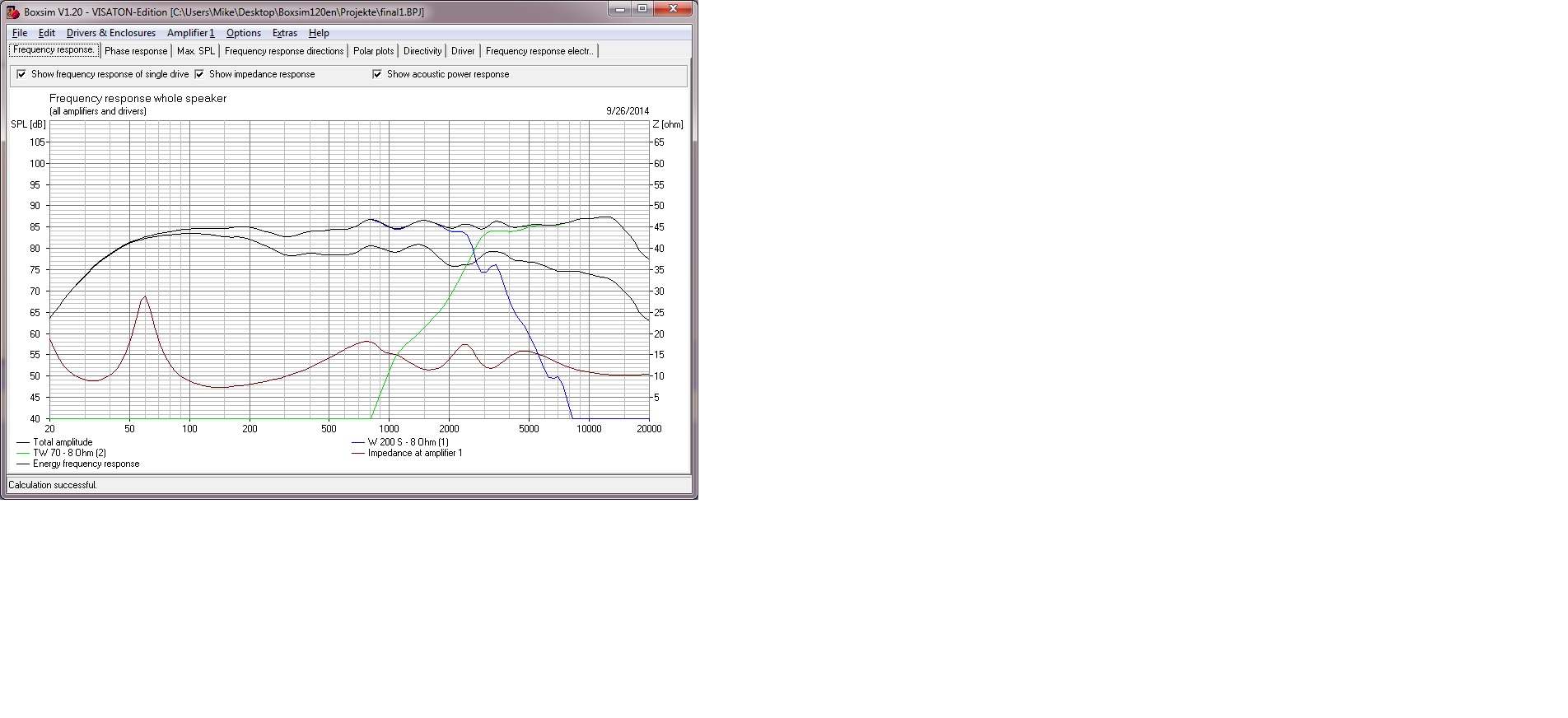

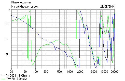

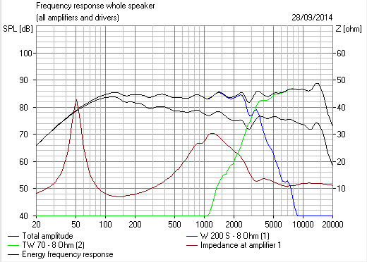

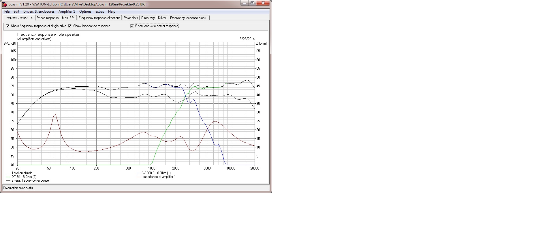

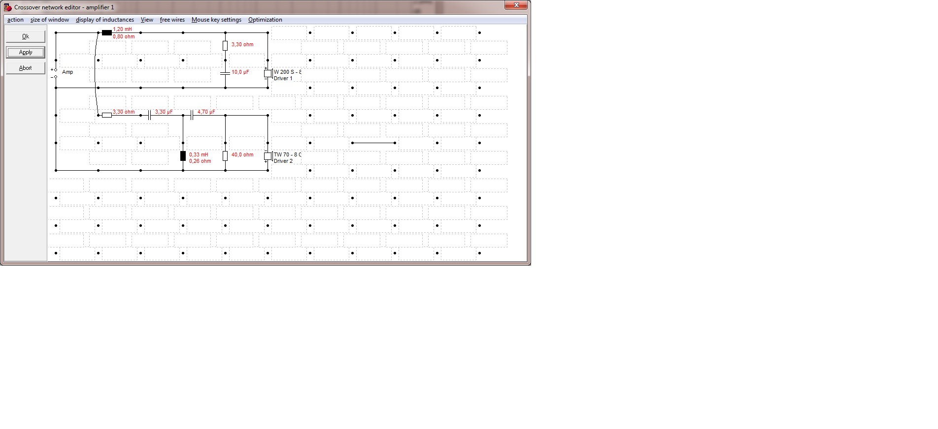

ok modeled the visaton ws200 and the phenolic as best I could. Im concerned because I don't have an impedance graph for the tweeter but here are my results. a 30 ohm resistor across the tweeter pulls the right side of the graph down just a little bit if that is preferred.
I think you've got the hang of it very quickly! That's heading towards an 18dB/octave BW3 response, with the flattish power dispersion at crossover. Phase is quite fiddly with BW3, the theory tells you to get a 90 degree difference around crossover on either tweeter polarity. I look upon BW3 as being LR4 with more overlap between the drivers.
The phenolic ring tweeter is a bit flatter on frequency response than the TW70 in my estimation, but electrically it must be very similar. Probably around 6 ohms DC and 0.15mH.
Although they are different looking and sounding animals, because they have similar electrical and frequency response characteristics, these two tweeters are interchangeable without mod to the crossover.

Because the SEAS is slightly smaller voicecoil inductance, the bass shunt resistor could however be a bit smaller.
If you take the crossover lower than 3kHz, you will run into phase problems. The negative polarity solution will then need a recessed bass, which might not be practical here. It's all about the half wavelength.
FWIW, a rising slope on the bass sounds bass light. Flat or a slight downward slope gives a more balanced presentation. A slight rise at the top end on the tweeter is no bad thing with cone tweeters, because their dispersion and power response is worsening.

Ok looking for you final stamp of approval to go ahead and purchase the visaton driver and the phenolic tweeter and that you approve of the values for the crossover. One thing I'm not clear on is the necessary wattage rating I need for the resistors. is 20w for the woofer and 10w for the tweeter sufficient? amp is rated 100w.
I threw the dt 94 in to see how it changed my model. the dt94 would actually be a better fit to my box as the phenolic is slightly to large and ill need to shave the hole larger. The only thing about the dt 94 or the tw 70 is the dip in response at the 3khz xo point from the woofer.

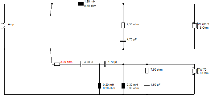

Inevitably you have to adjust tweeter level to personal taste. I like them quite bright personally. The below circuit is my current thinking. The second tweeter coil is optional, but does something IMO. I have the modelling and FRD and ZMA files for an XT25 somewhere, but that is not my current interest. As it is, the similar phenolic ring tweeter should behave well enough here. This is a very good sounding speaker.

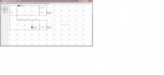

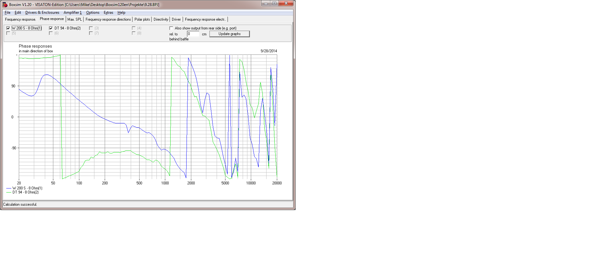

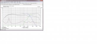

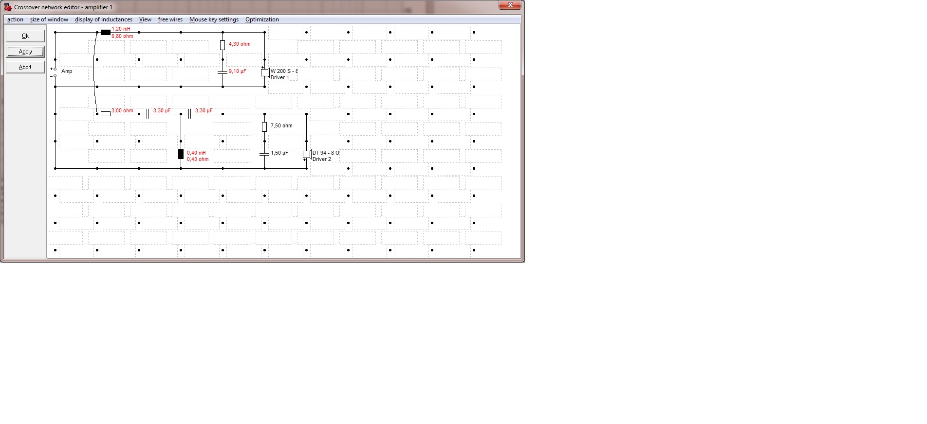

OK so I've opted for the Dt94 as it fits my box without modification. I'd love to do the LR4, but I'm already over my budget so I'm gonna make do with the bw3. I've attached images for what I hope you think is an okay setup.
I don't know what to look for in the phase graphs at all so let me know if anything is out of wack.
Finally I'm still unclear on the necessary wattage rating for my resistors. is 20w woofer and 10w tweeter sufficient?

I still like the near LR4 circuit here, with or without the second tweeter coil: http://www.diyaudio.com/forums/multi-way/262335-reviving-vintage-jbl-cabinets-3.html#post4072225
But it is all trial and error IMO, and I've never built something that didn't evolve a bit with time. For some reason your modelling is coming out very slightly different to mine. I never use more than 10W wirewounds. But I do have a feel for how much power is going through most components. Most of the power is at the low frequencies, and once you get into the midrange and treble, power dissipation is minimal.
I've accumulated a lot of components and swap things around a lot. Is that because I don't know what I'm doing as sreten unhelpfully says, or perhaps that it's all quite a subtle business and you always want to try things? 😀
For sure, the crossover makes or breaks a design. Aligning phase and dispersion around the crossover point makes for good driver integration. You should be unaware that there are two drivers behind the grille when you get it right. Getting the bass balance right is important too. Little peaks in SPL at certain frequencies are quite annoying, since certain notes then jump out at you.

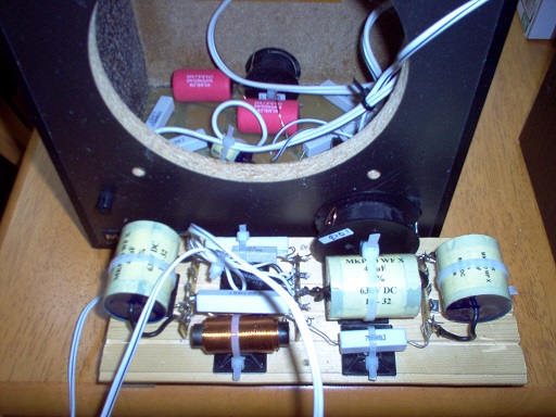

I could go on, but won't. Welcome to our hobby, which by definition is "An interesting waste of time". Here's a few pictures from system7 labs. Onwards and upwards! 😎

Its slightly different because I'm manually inputting some values for the components that match whats available through parts express so I can get everything from a single purchase. Thanks for all your help. I'll post back with pictures and the final result. wish me luck heh.
