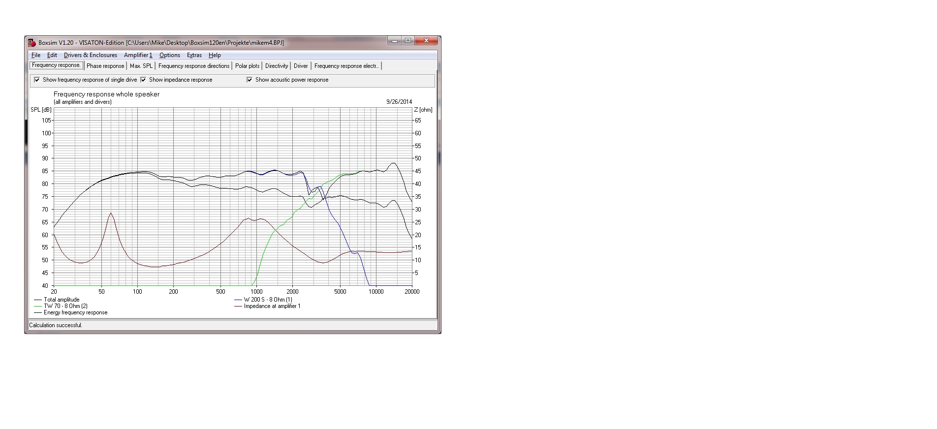

Let's do a proper job here. Download this; Downloads.

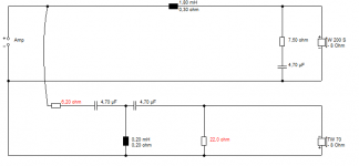

Now try the below circuit in a suitable cabinet (which you set up) with the following drivers:
Visaton W200S-8 8" Woofer with Treated Paper Cone 8 Ohm
Phenolic Ring Tweeter 8 Ohm
Your reflex bass loading will be 33Hz on 50L:
W 200 S - 8 Ohm
It'll look a bit like the below photo.

I don't know why you're at a loss because that's not exactly worlds apart. Scales matched, overlayed, stated invalid portions of each cropped off:I'm really at a loss

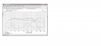

Ok I toyed around with boxism and its def cool, but I don't have any measuring equipment. this is all best guess. That parts express driver isn't listed in the visaton drivers obviously and I don't even have all the values to try and input my own data such as fas. I looked up a visaton tsweeter but its vas was like 1900 and didn't seem to match up well to that visaton woofer you posted.....
so I used spl trace for a crude representation of my drivers and put them in boxism. my crossover is much simpler than the one you showed. can I email or otherwise get the project file to you? the frequency response is fairly flat, but I'm sure theres more to it than that. I did not upload an impedance file though. I also had to guess at the tweeters excursion as it would not do anything without a value there. I used 1.0 as the visaton was 1.1.....

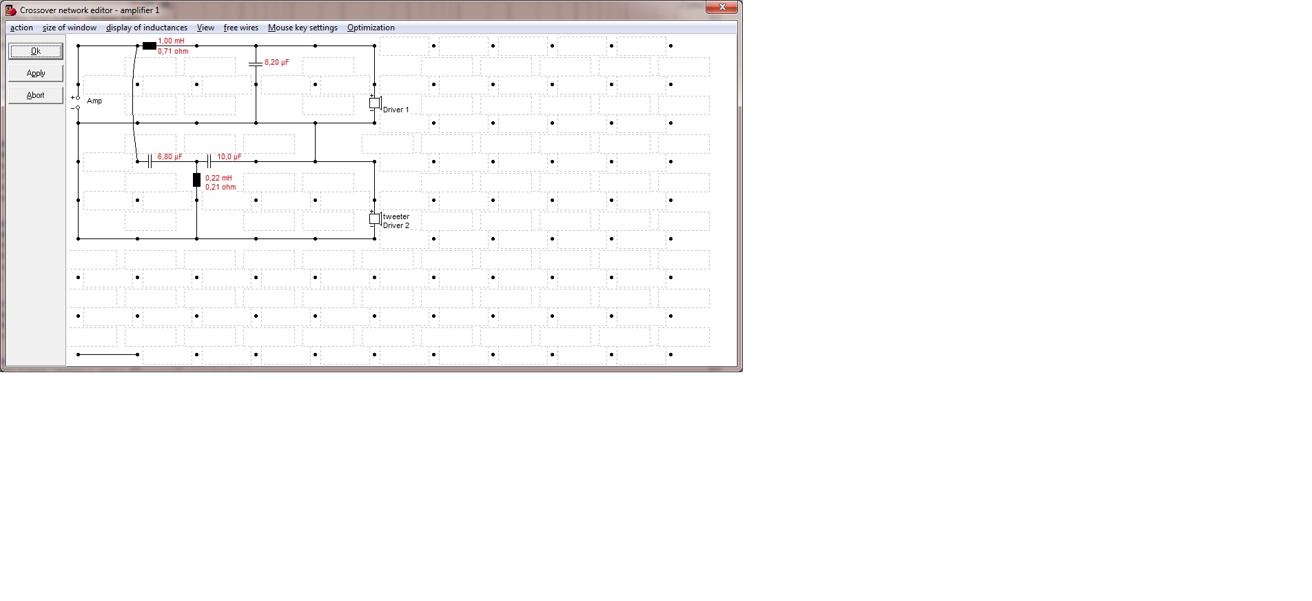

I uploaded a trace of the impedance graphs also. Another concern is the modeler lets you choose ported enclosure but does not have you put in any parameters for the port? I can give you the project file if your willing. pay no attention to the wire connection between tweeter and woofer. I must of somehow put It there when copying.

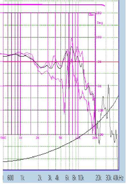

That's a nightmare. Have you looked at the frequency response of the 8" metal woofer? I wouldn't have a clue how to get it working, except it'll be extremely complicated. 4th order 2kHz crossover with a notch at 6kHz, I'd guess. But basically a horror. Even if you filter it right, it'll sound like poo. 😀

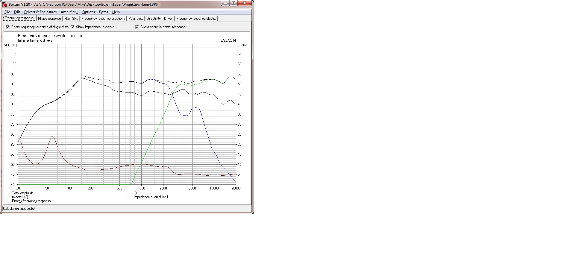

I must be doing something different. Using the sample xo you showed before and using the visaton test drivers without changing anything I get a graph like the one attached. was the xo you showed supposed to be appropriate for the ws200 and the tw70?
Flip the polarity on the tweeter. 🙂
