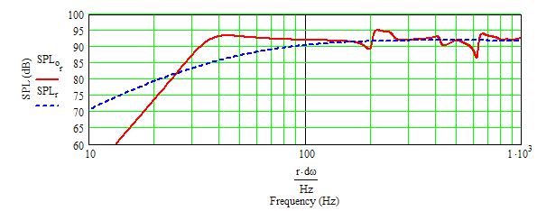

With such a low Qts, it won't do bass with any authority without being either coupled to a matching impedance amp (DF = 1) or a huge BLH, so short of a few pipe organ symphonies and movie LFE, I doubt you'll feel the need for a sub system.
The Petite is a severely under-damped alignment designed for a high output impedance amp, so while it could work well with a sub it would ideally need both its cab and vents heavily damped, so might as well build a sealed cab of the same size and paint vent slots on it.
The 614 is tuned higher, so not as under-damped, but its 4th order roll-off means an XO point around an octave above its ~42 Hz Fb, so a typical 80 Hz XO seems OK.
A typical 120 Hz XO could probably be used with a max flat sealed alignment, so if multiple subs are used, then this is probably the best choice overall.
Anyway, 'best' is a floating target depending on the needs of the app.

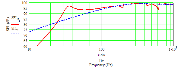

I'm right either way depending on how one chooses to view it and/or use it to make a specific point, but without a response plot it is confusing and frankly had forgotten having already mentioned it.
Anyway, it's over-damped in that the cab is tuned low enough that the driver's low Qts governs its roll off slope between F3, Fb with a critically damped 0.5 Qts being the line between over (< 0.5) and under (>0.5) damped.
It's under-damped in the sense that the cab is much too large to maintain its over-damped state to Fb, i.e. it has a huge peak at Fb that will 'ring' due to excessive high Q group delay if some form of series resistance isn't used to 'pump up'/flatten out its response.
GM
