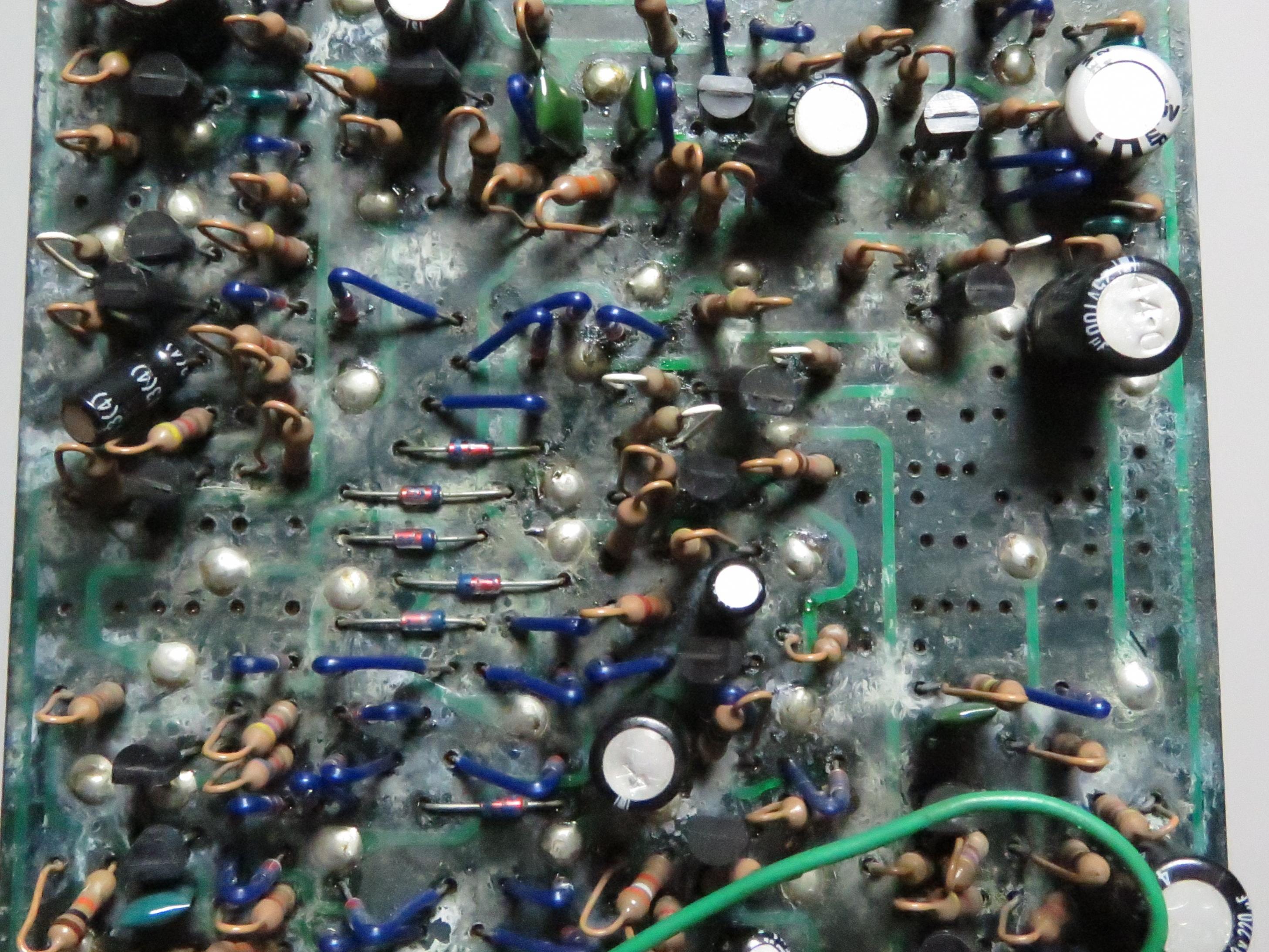

I've cleaned it up a bit, it was all pretty grimy inside and showing its age. Boards are a bit sticky, and cleaning with alcohol leaves a cloudy white residue once the liquid evaporates. I don't know much about very old boards or what is causing that, so I'm not sure if I can do much about cleaning in a way that's going to help the board. I've taken out only the touch panel board and the system control board so far, and there's no evidence of corrosion on electrolytics, nor do any of the transistor legs look corroded.

Before I do any replacement of parts on PCBs, I wanted to get the boards somewhat clean. I haven't been able to do anything about the white residue though. It disappears while there is liquid coating the board, but returns quickly as the board dries. Wiping dry with a rag doesn't seem to get better results.
So far I've used distilled water, isopropyl alchohol (76%), and then went for a longer cleaning with the board immersed in a sink of water with some soap added. I used a soft toothbrush and a paintbrush for the water wash, then rinsed it off several times before drying. There's really not much difference in results though, because the white residue returns as it was before. The attached photo is after the sink wash.
Any ideas what to try next to get rid of the white crud?

To answer my own question, the solution (or not, as it were) seems to be 100% IPA.
I received a 1L bottle of the stuff yesterday. One going over with that and the hideous looking board in my photo is back to a lovely shade of green. Very relieved, as none of the other cleaning processes worked for me. Now I know what to do, I can move on to more of the boards. If I get around to it, I'll post a better quality photo of a board before and after cleaning. The difference is amazing, and the process is pretty fast too.
