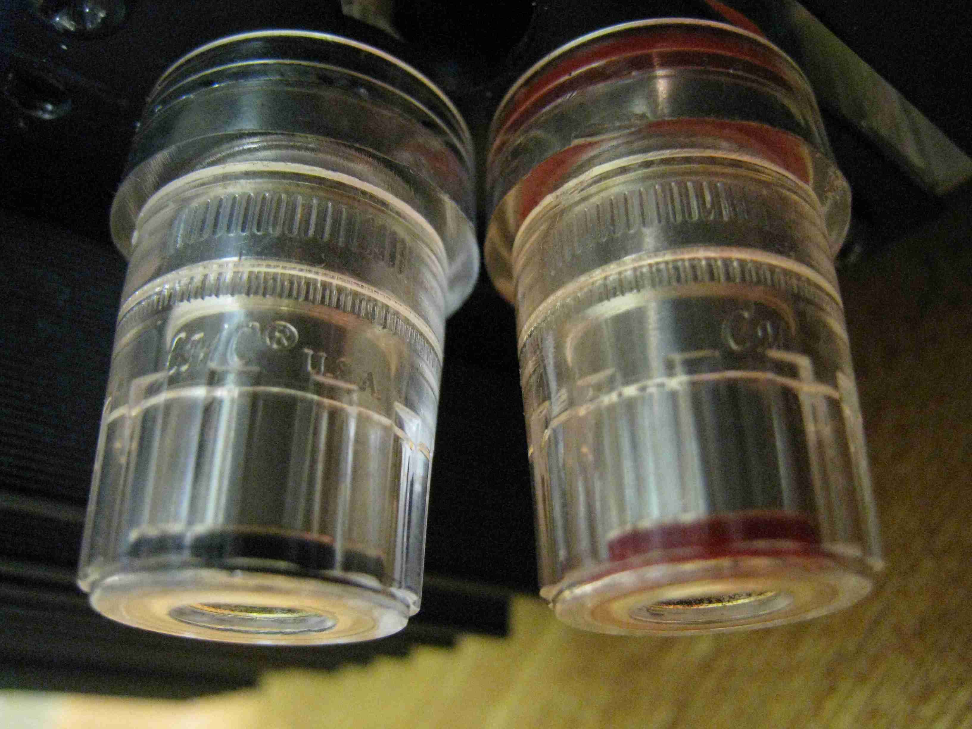

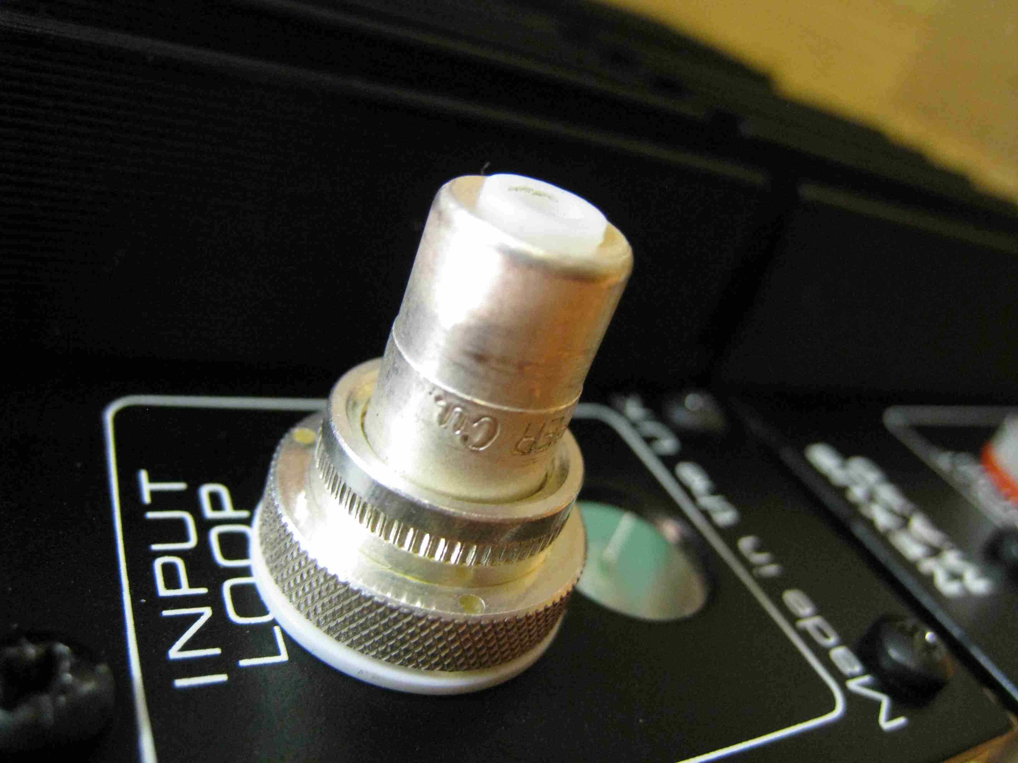

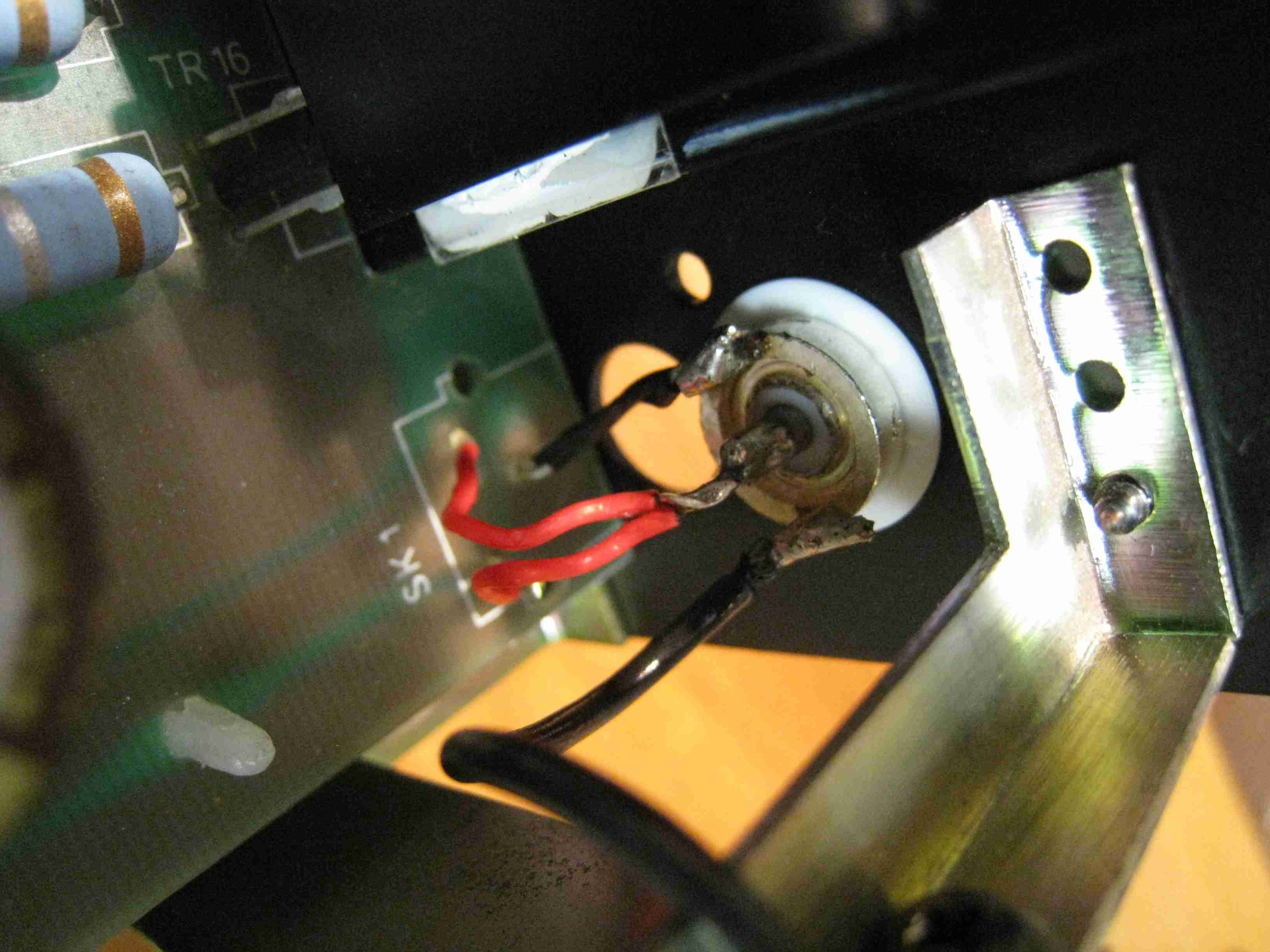

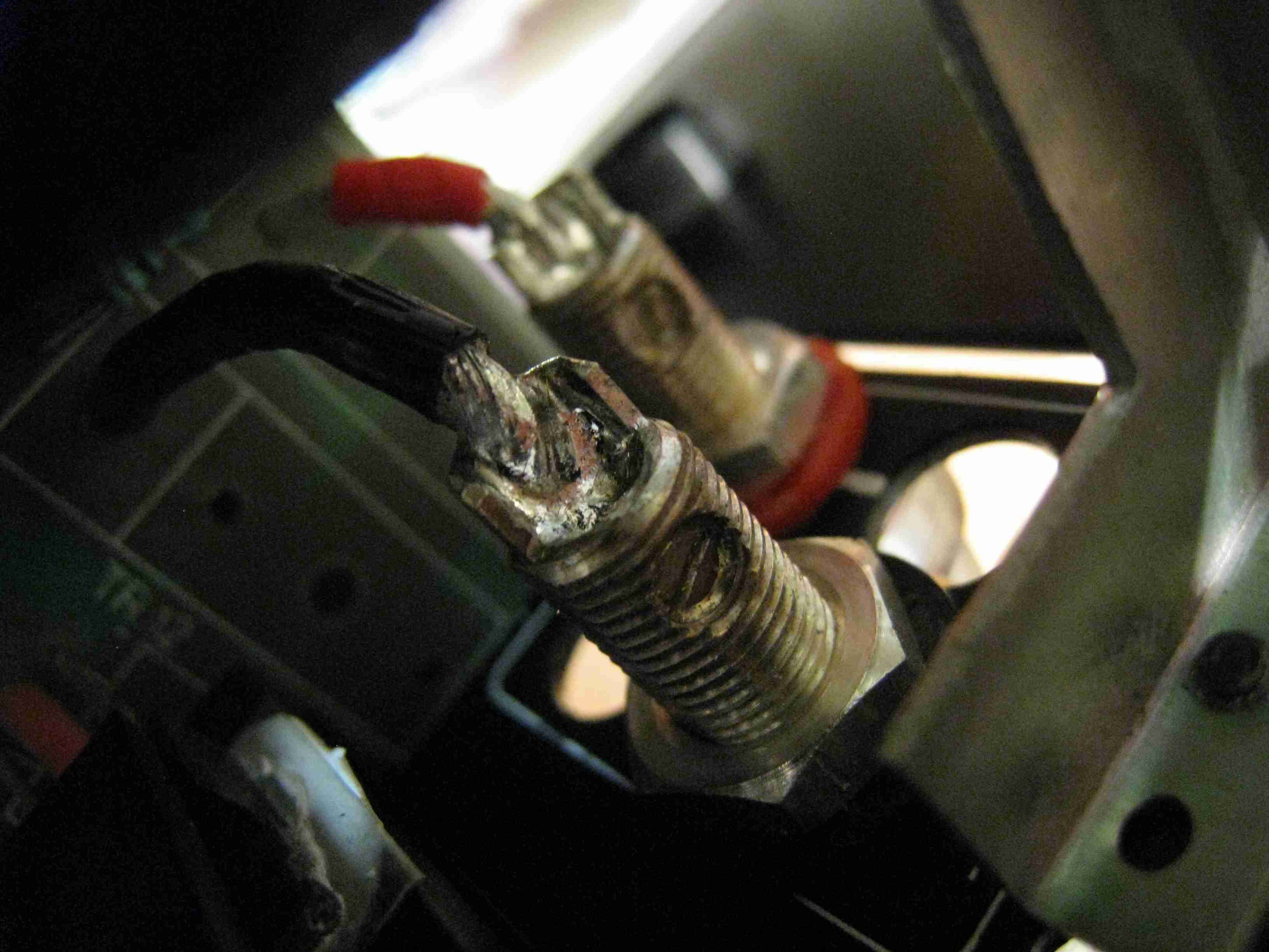

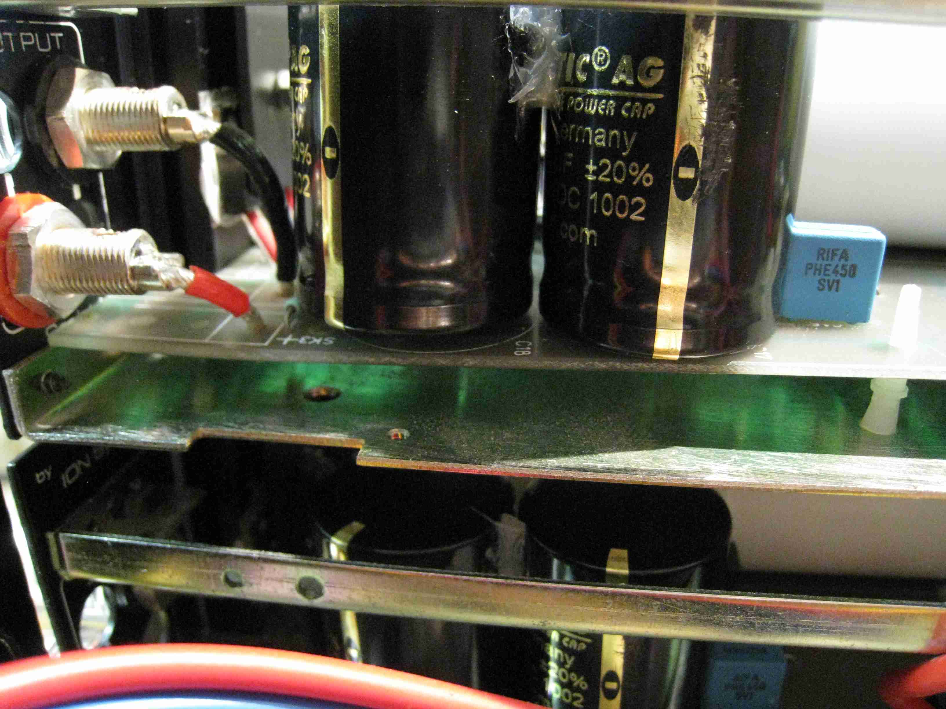

FYI I just settled for RIFA PEH at the 22000 and Mundorf MLytic for the output 10000 and a mix of Silmics II and Nichicon MZ for the signalprocessing, new trimpots from Bourne and a fresh bypass caps from RIFA (0.1uF). To finish off I will also change the input RCA sockets and the speakerterminals with silverplated real copper ones. It will be exciting to hear the end result! Pictures will come!

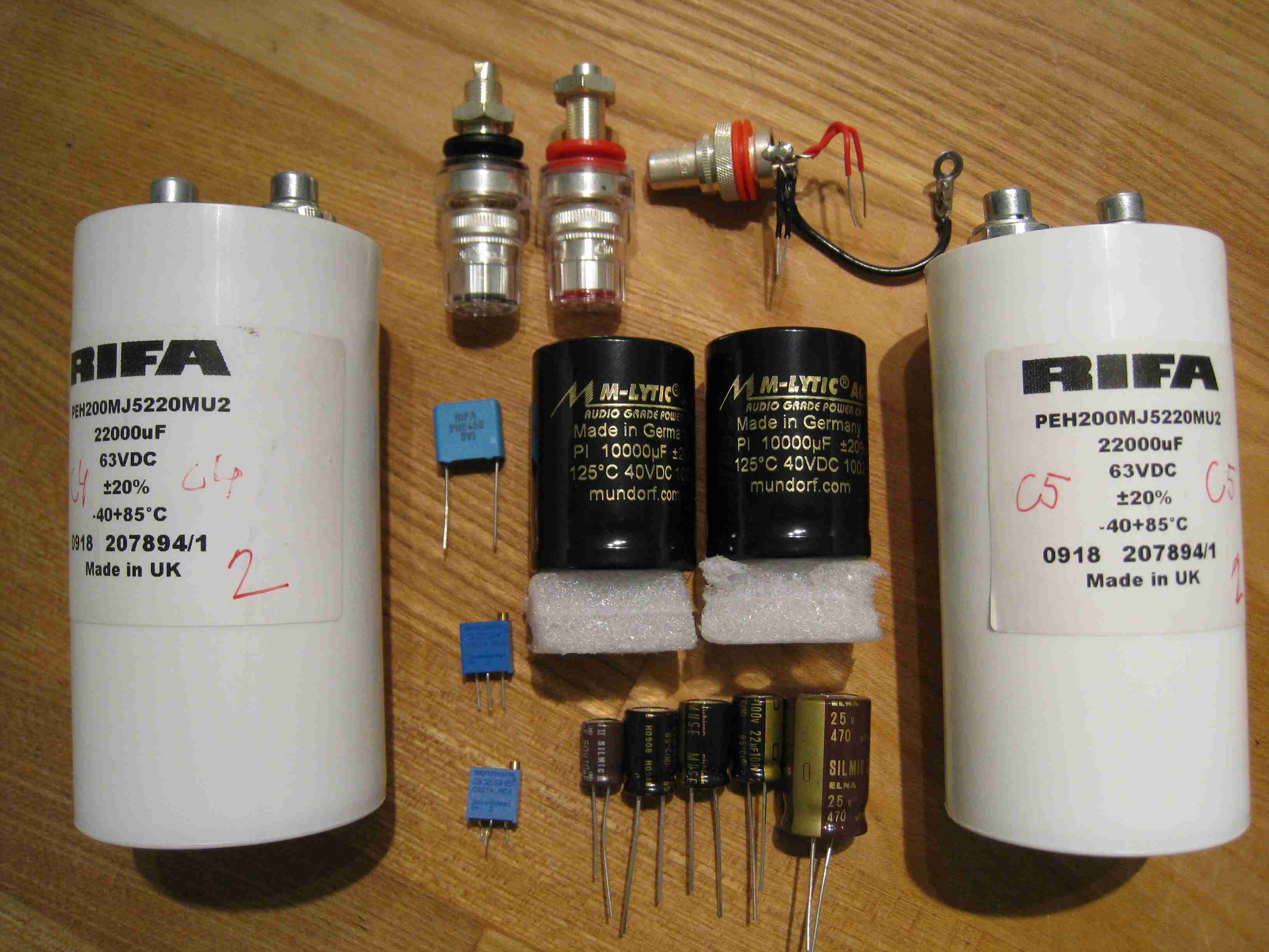

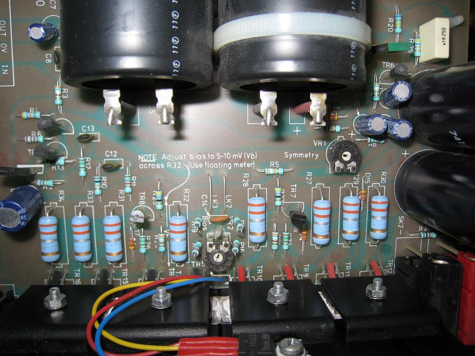

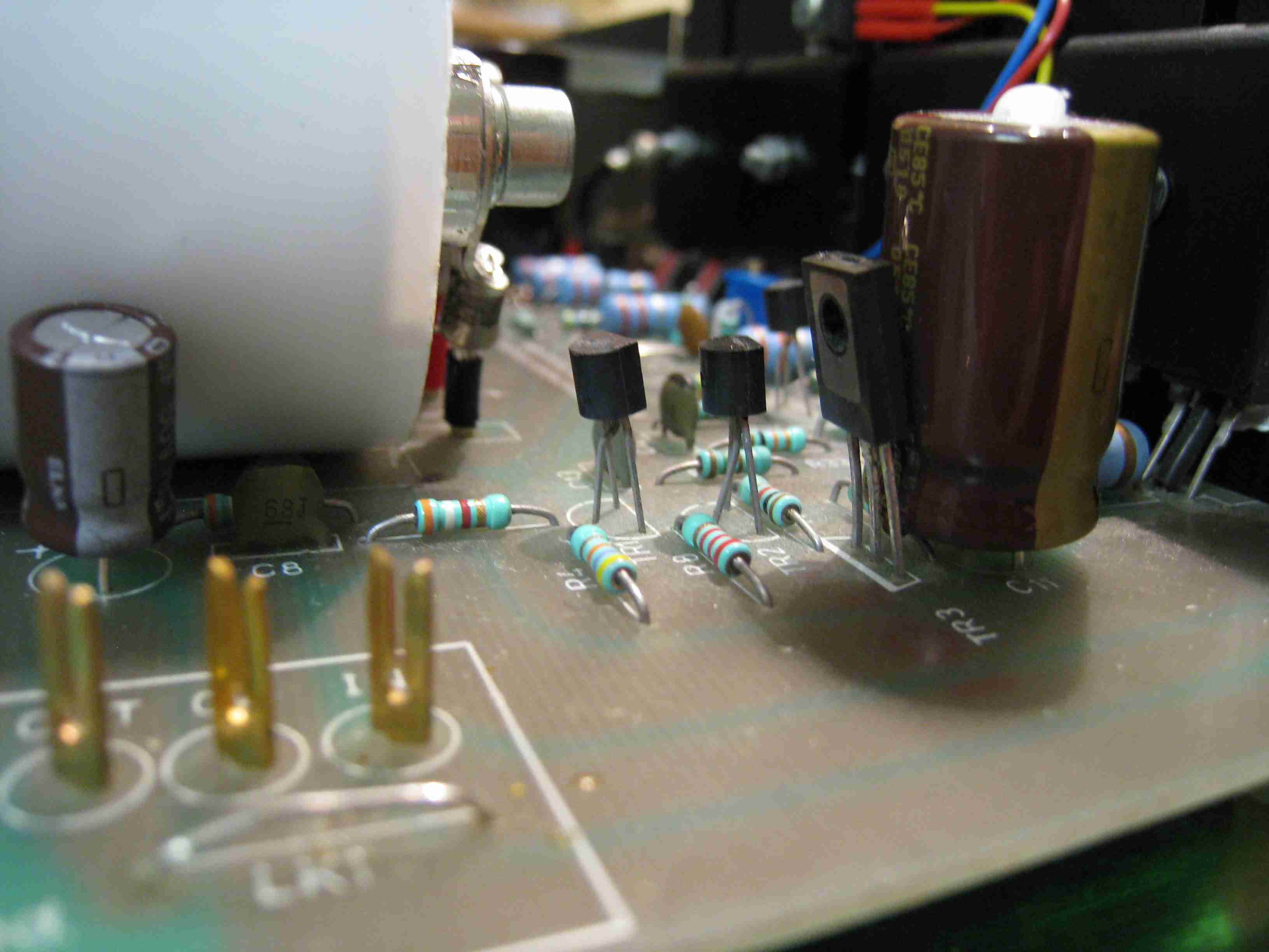

So I finally managed to get the parts in place. It is an amazing lift in overall performance even from start but I guess it will be better after some hours of settling in. Same character as before but now dynamics, bass, ambience etc etc is so much better, can't stop listening. Have a look at the pictures/Mike
