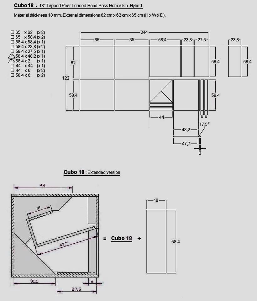

Over on a subwoofer design group on Facebook, one of the members recently drew my attention to the Cubo design, specifically the Cubo 18 Extended. He was not happy with how they sounded and while it was claimed that they have a range of 40 Hz to 120 Hz, he was getting basically 60 Hz and not much else.
Now, I had come across this design a few years ago, and I didn't really give it much thought at the time, primarily because there were no real performance measurements (impedance curves, frequency response), but mostly because a cursory glance at it layout suggested that it would not be possible to sim it in Hornresp because the horn expansion looked a bit off, and I have a "sim before building" rule that's become more and more strict as the years go by.
However, the member did indicate he would be interested in if it could be improved, so I decided to have a further look.

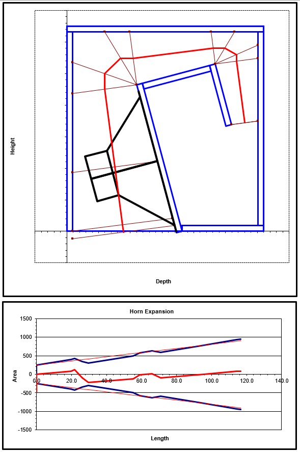

The original Cubo 18 Extended
The attached shows the original plans for the Cub 18 Extended bass bin. If you take a closer look at the layout of the horn's path, it's easy to see that there's a "discontinuity" in the upper left section, as the csa at the start of the last section of the fold is greater than the csa at the end of the previous section. The overall path length also looks a bit short.
...and here's where I tried to emulate the original Cubo 18 Extended in one of my BOXPLAN workbooks. As you can see from the "Horn Expansion" graph, it's not a smooth expansion - there's a discontinuity in the first bend (starting from the throat). The reason for that is clear - a single expansion is used for the horn's path, and the baffle board for the driver is too long to support a smooth single expansion in the box, given the box's dimensions.
This suggests to me that changing the design to a dual-expansion type and running the design through my usual "optimization" process might produce not only a smoother expansion graph, but perhaps even better results.

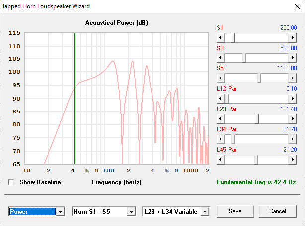

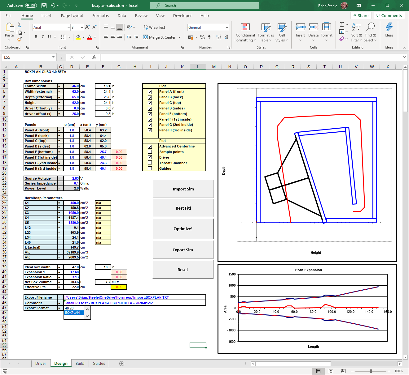

So, I put together a BOXPLAN Optimization workbook around the design and this is what I came up with. The "improved" version now features a dual-expansion fold and extends the first segment (starting from the throat) to improve the low-frequency performance of the Cubo. And of course, now that the layout is all described by an Excel workbook, it's now possible to try out different external dimensions for the box and "re-fold" the horn using the optimization routine.
Note #1. There seems to be a very minor volumetric calculation in the workbook (the corresponding Hornresp sim seems to be slightly bigger than the calculated net volume of the box). I'll eventually find it, but I doubt that it would make any noticeable impact on the sim.
Note #2. A few assumptions were made about the Vtc/Atc and S1-S2 range of the TH sim because of the layout of the Cubo. Because of this the actual response above about 120 Hz or so might differ from what the sim suggests it would be, but who uses these things about 100 Hz anyway? 🙂

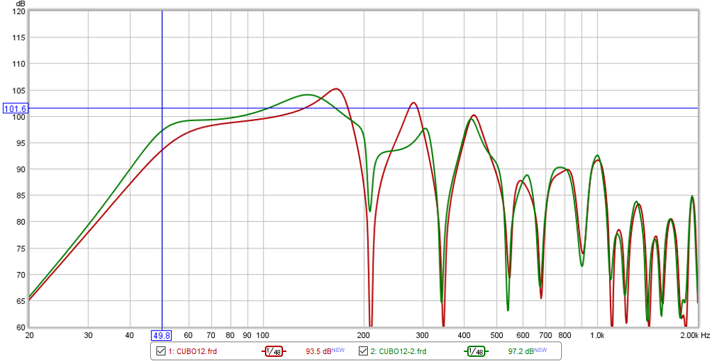

Well, I found the dimensions of the original Cubo 12 and, at 45 cm x 45 cm x 48 cm, it's just too small to get Fb down to 40 Hz. 50 Hz looks more practical.
FWIW, I compared the predicted response of a 50 Hz capable modified Cubo 12 with my POC6, which is a 50 Hz MLTL. The Cubo 12 is 97 l gross. The POC6 is just slightly smaller than that, at 96 l. The Cubo is a bit more sensitive above 50 Hz, but the POC6 matches it at 50 Hz. The Iron Law remains intact 🙂

An extension to the Cubo 12 will improve its response at lower frequencies and Fb is lowered a little. I've attached an example of what the predicted response looks like if an approx. 32 cm extension is added to the front of the modified Cubo 12.
