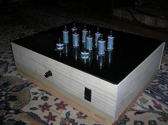

Being that I have limited high voltage experience, I am going to perform the mods on my amp under the direction of my EE/HAM father-in-law. I figured it would be the safest way to go, plus he could help me figure out anything if I get stuck. I don't have time to do it until a week and a half from now, but I guess I'll just have to be patient.
I know I'm going to install the first mod (.01uF cap) and maybe more, but I'll cross that bridge when I get there.

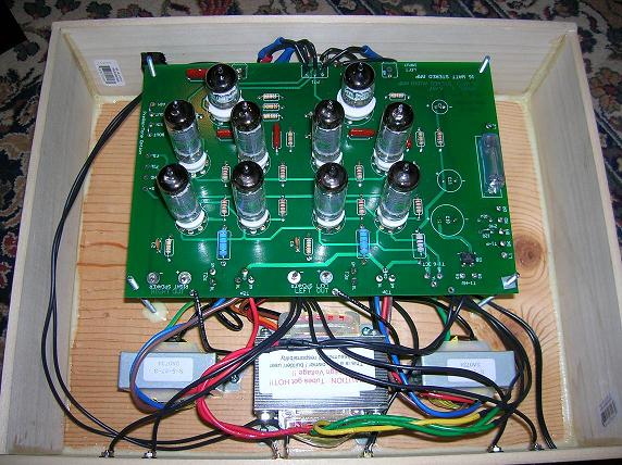

Hi, At the present time I'm on a DC heater kick. All the projects for the last year or so have DC. The one exception is the K-12 mods. I stuck with AC there. It could be done rather easily though, I just didn't think it would be worth the effort. The quickest and easiest way would be to use a 12 Volt SMPS. They run about $18 from several sources. I would want to (if possible)scope the output for switching noise. If not possible, a simple pair of RF chokes and a few small caps would be in order to be sure the was no trash getting into the amp. I have used similar supplies and find them trouble free. The biggest problem doing this with a K (other than a K-12) amp is rewiring the heaters for 12 Volts. The reason for 12 and not 6 is that 6 volt SMPS are scarce and more costly.
Hi, It looks pretty good to me. It is rather difficult to get the wires to transformers and jacks to look neat. I sometimes use small nylon wire ties to bundle some together. Don't bundle input and AC wires with anything though. It will cause noise and hum pickup. Nice woodwork, what is the top made of?
