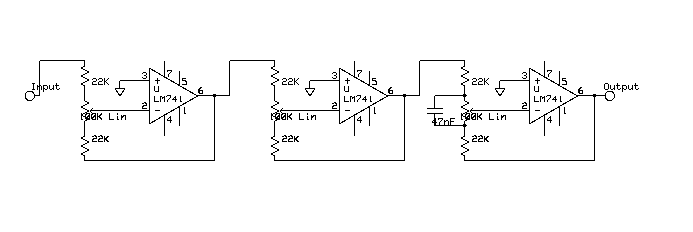

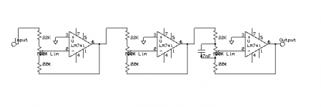

Schematic: See attached. Ignore the type of the opamp, I just grabbed one from the symbol library. Note that all 3 pots (6 for stereo) need to be ganged.
Its operation is quite simple: 3 cascaded +-15 dB stages, the first two are frequency independant, the third one is the bass half of a standard Baxandall tone control. Note that the third stage pot has to be wired "upside down" compared with the first two, to reduce the bass gain as the main gain increases.

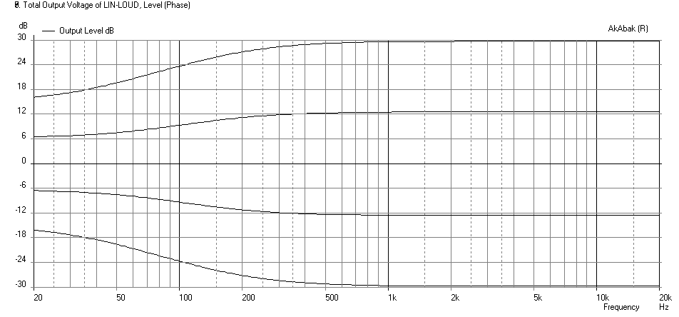

Frequency response: see other attached.
I used 2 gain stages, you can get 30 dB boost/cut in a single stage but the control law doesn't match that of the bass boost/cut stage. It might be possible, but opamps are cheap.
This is still proof of concept, waiting on finding some suitable high quality digital potentiometer chips. Also, the time constant of the bass control stage is not finalised. I'm in the process of recalculating the ISO E-L curves into more conventional bass cut curves to calculate the capacitor value required.

Hi Don, I don't believe you need such a complex circuit to achieve what it is you need to achieve. A single stage parametric shelf would do what you want, and since you know the speakers you are using the frequency and width controls could use preset pots with the last control, the gain, linked to the volume with two simple gears, one on each shaft. This sets the slave pot in reverse. Simple is often better.
Terry
It may be simpler, but is it going to track? That is, when you reduce the main volume by (for example) 10 dB, is it going to reduce the gain at 20 Hz by 5 dB? (In other words, will the parametric EQ provide 5 dB of boost?) That's the problem I ran into - trying to match the parametric equalisation law to a log law(*) volume control.

I'm starting with a general model, that will work with all speaker systems without modification. LF shelving to suit specific speakers can then be added on a case by case basis. In many cases it will only require changing the value of the capacitor in the bass gain stage, but you can use more complex networks instead of just a single capacitor if you want a specific curve. And you can add a complementary output for a powered sub, so that it progressively takes over the bass duties from the OB as you wind the volume up.
Interesting questions! I don't think any system will track in such absolute terms. The question is do you really need them to. Generally we listen to music at certain listening levels e.g. background, normal, loud and 'rock the planet, I love this song'.
If you use 'real log' pots then is it simply a matter of using identical pots with one in reverse? In my experience these systems work quite well. I don't sit on the volume control while listening, it defeats what the sound engineers designed the music to be like.
I suggest you may want to sit down and think what you want this control to do in the real world. List the must haves, and the would be nice to have, and then the silly things (also refered to as marketing hype). See what you come up with.
Terry
Even if the laws don't track exactly, you still need to have them track in a predictable and desired manner. You effectively need to be able to set / specify equalisation curves for each of the range of levels you normally listen at, then arrange to automatically switch between them or smoothly transition from one to the next.

But even if you use log and anti-log (or geared log) pots, you still have a control law problem. Take a look at the graph of control resistance versus rotation for log and anti-log pots. Log pots have most of their resistance change at the anti-clockwise end of their travel. Anti-log pots have most of their resistance change at the clockwise end. They don't "track". in practice this means you'll get too little bass boost at low volume, and too much bass cut at high volume.
I've thought very carefully about what I, personally, would like this control to do. I'm also trying to keep Jamikl's requirements in mind. So far, it looks like I can meet his requirements as well as mine with variants of one basic design.
