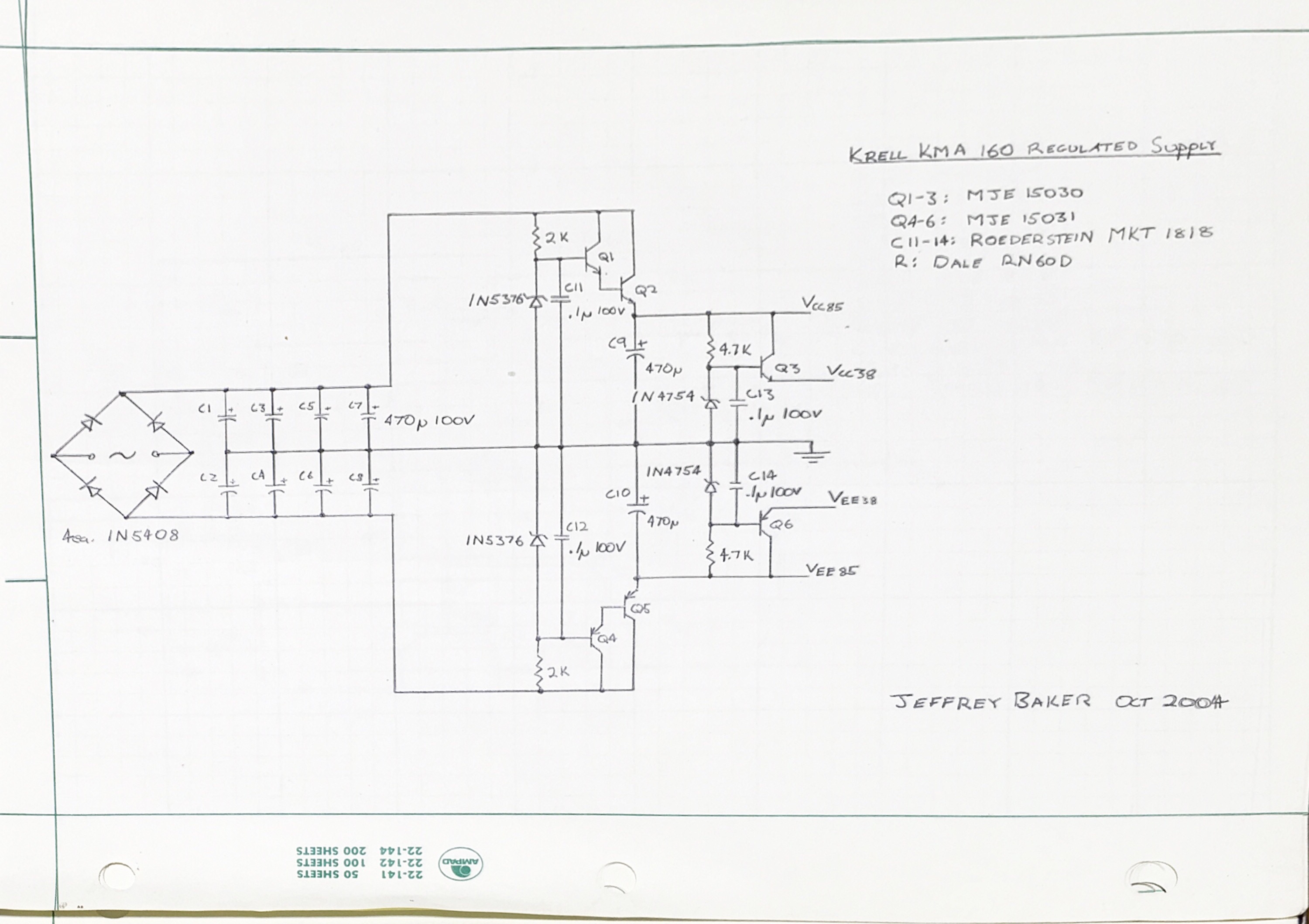

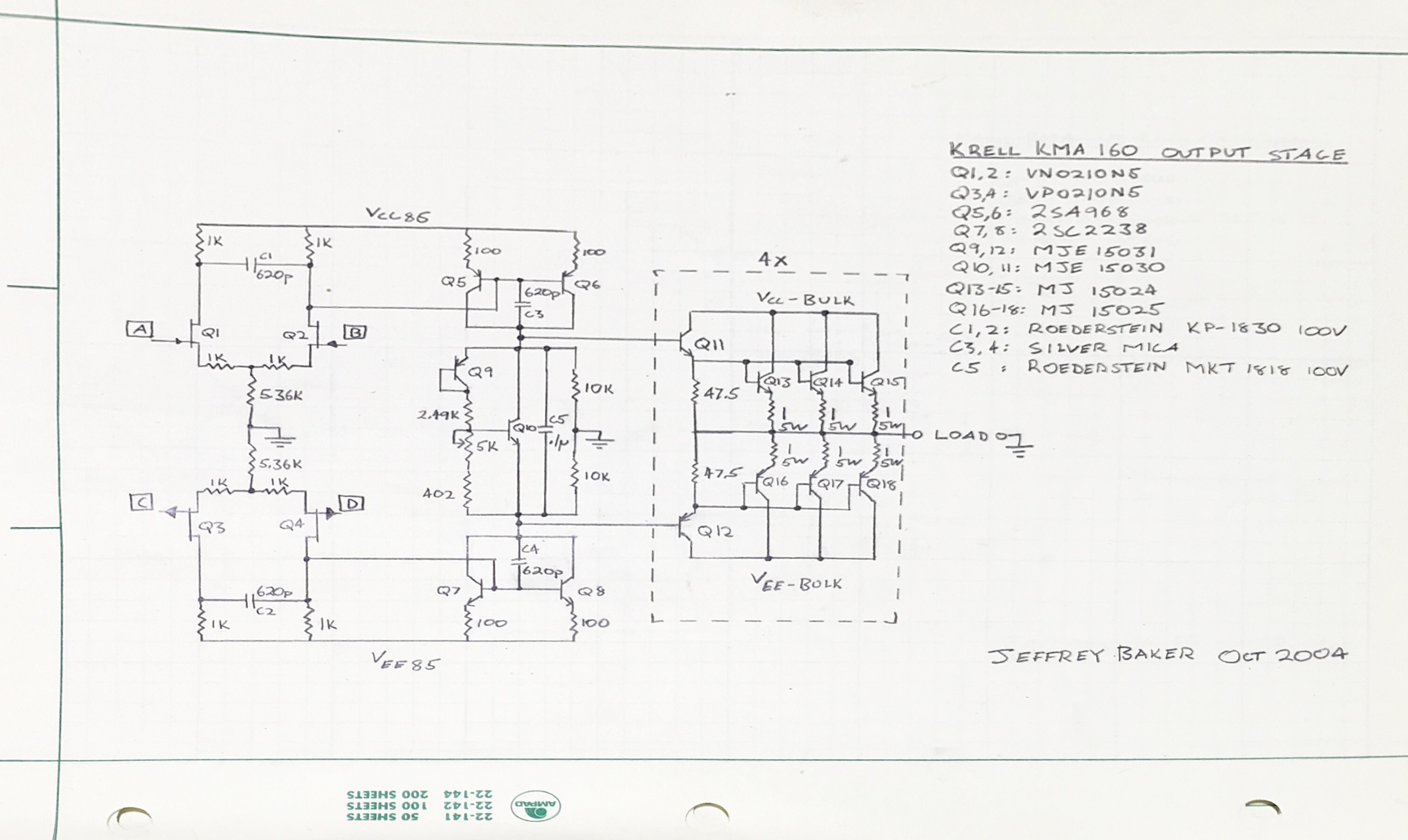

Hi everybody. I was going through some old notebooks, and I found my original pencil drawing of this amplifier. I know some of the images on this thread are broken, so I thought I would upload those here. I hope it helps somebody.
- Reverse engineering Krell KMA 160
