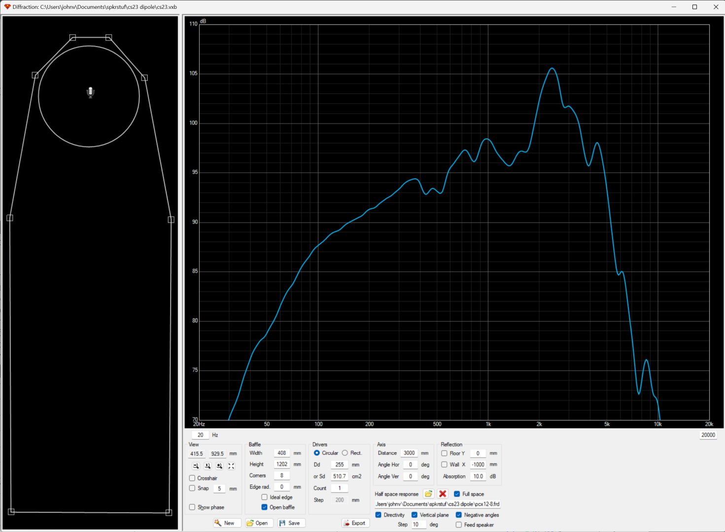

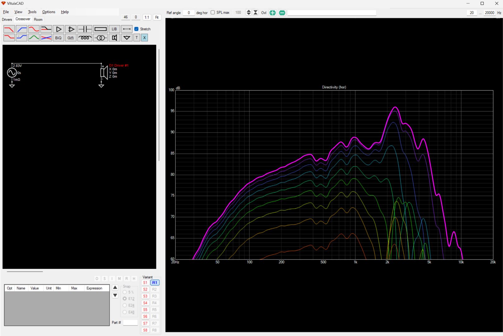

Attached is a sim of the midbass from the Emerald Physics speaker (the newer one, that's triangular-ish)
Here's some things I notice:
- It's kinda amazing the bandwidth that it maintains directivity control
- I thought a twelve inch prosound driver was overkill for a home speaker, but I didn't really grasp how much SPL you lose with such a narrow baffle. I've built dipoles before, but generally used wider baffles. At 500Hz, the output level is down 10dB compared to an infinite baffle.
- It needs to be crossed over by 1000Hz or so, because it begins to beam, due to the diameter of the radiator
For this sim, I used the Dayton PCX12-8 instead of what Emerald Acoustics uses (which appears to be Eminence in the first Emerald Physics CS2.3, unknown in the second CS2.3)

Beaming to the point of being destructive to consistent directivity won’t be an issue til around 1.4khz and the absent dustcap is where a typical woofer does most of its beaming…….and if i as a designer were faithfully relying on the cone to act as the most stable waveguide possible, I’d say the minimum high pass would be around 500hz……more of a filler driver application than a midrange.
They most likely moved in this direction toward coax from the disappointing performance of that round waveguide used in the earlier design…..that thing is god aweful from the profile to the terrible flimsy construction and resonance.
A large dipole AMT is the path fwd here for these designs…..and for those that complain about vertical directivity, well…..take a seat…….that’s how music is truly enjoyed.
