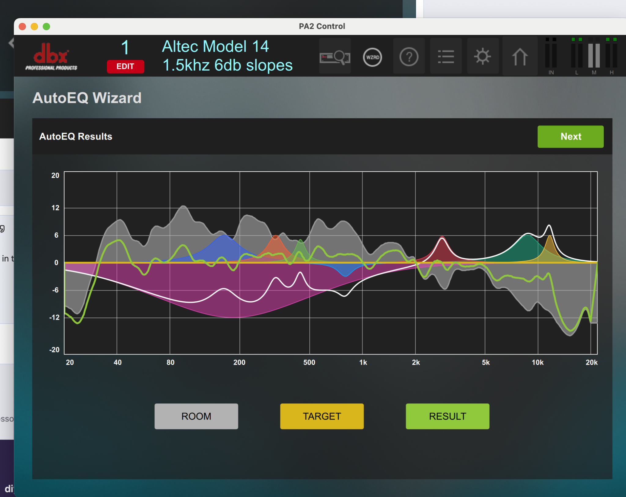

I'm able to run Auto EQ in my DSP to more or less flatten the response at the xover. The various parametric EQs applied are shown and adjustable.
Is this what you mean to focus in on the xover listening? I can also manually EQ for the room with it's RTA

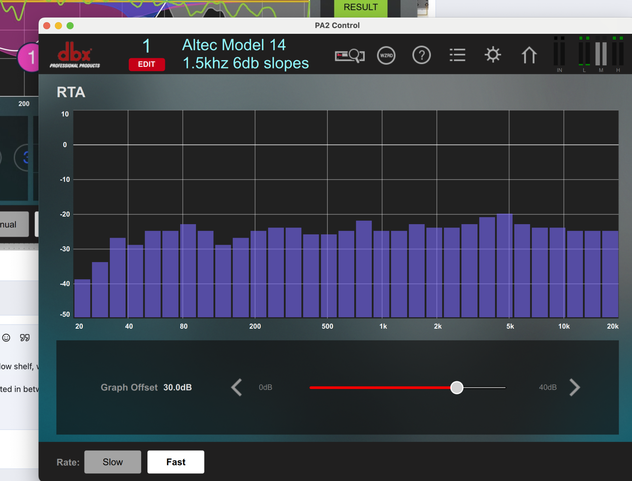

Here's an RTA shot of the 6db cross with low shelf, white noise - no Auto EQ
Measurement mic is 3' from speaker, pointed in between the woofer at tweeter.
& PInk Noise
& PInk Noise

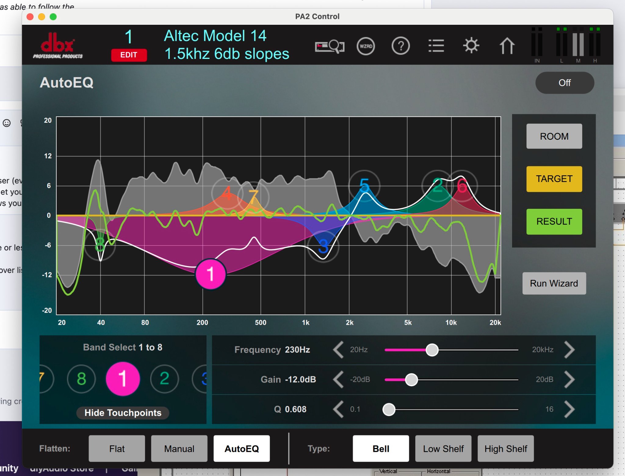

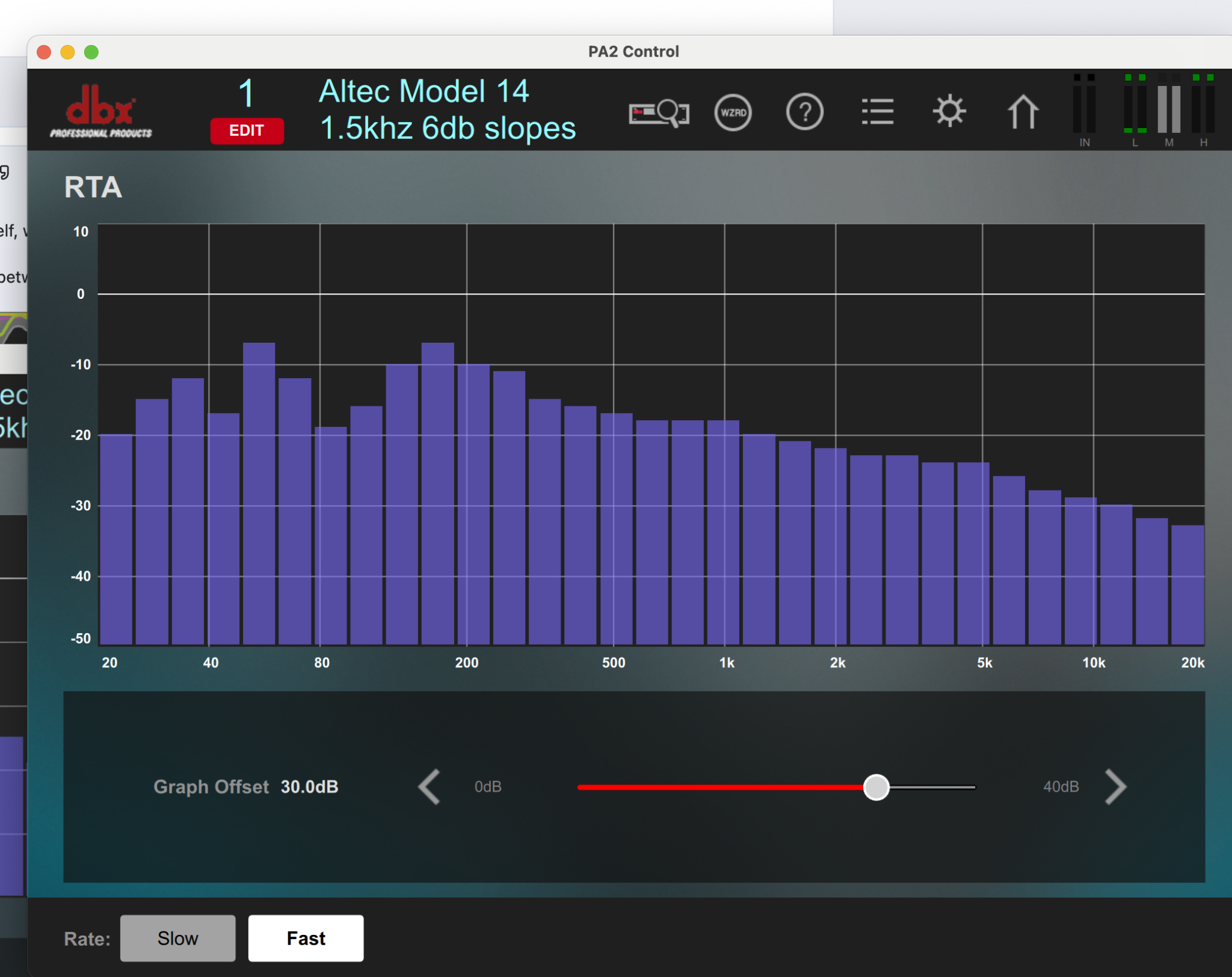

Here's a re-measure of the Auto EQ with the mic in the same position as above:
6db cross - HF gain reduced -15db
I'll run a 12db LR cross next

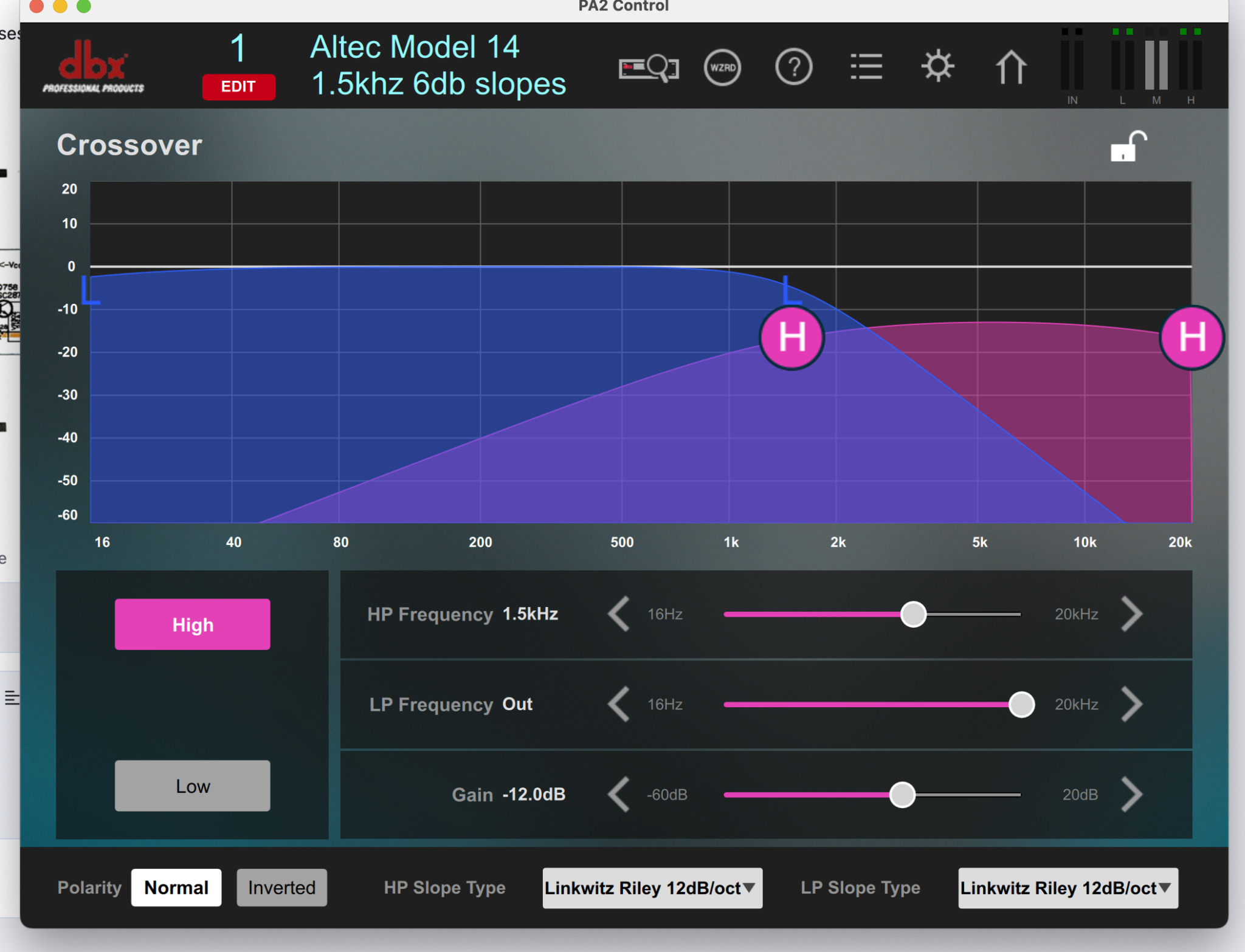

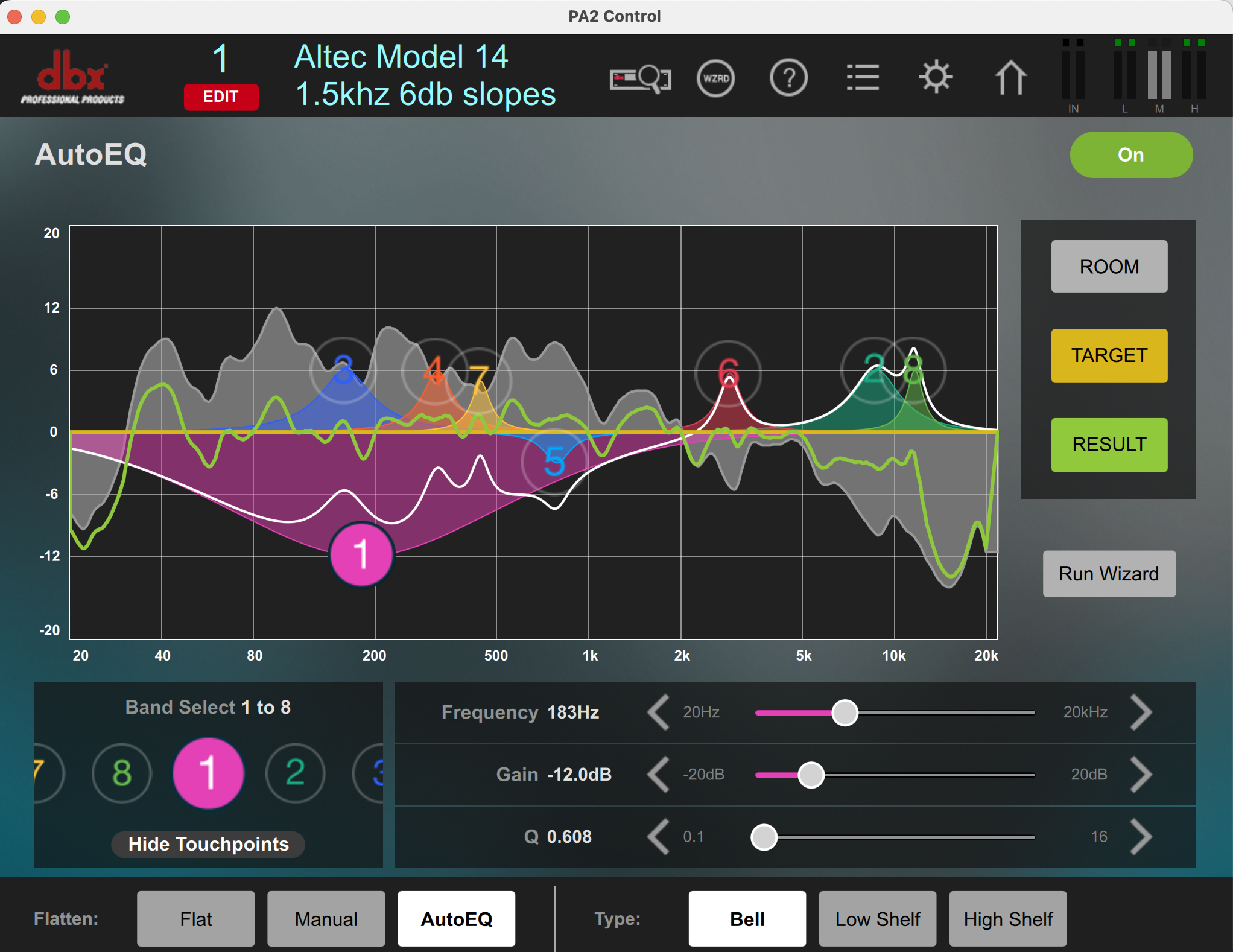

Here's the xover config I'm trying with 12db LR on both ends - normal polarity. Upped the gain on the HF to -12 instead of -15 looking at the above sweep to bring the top end up a bit.

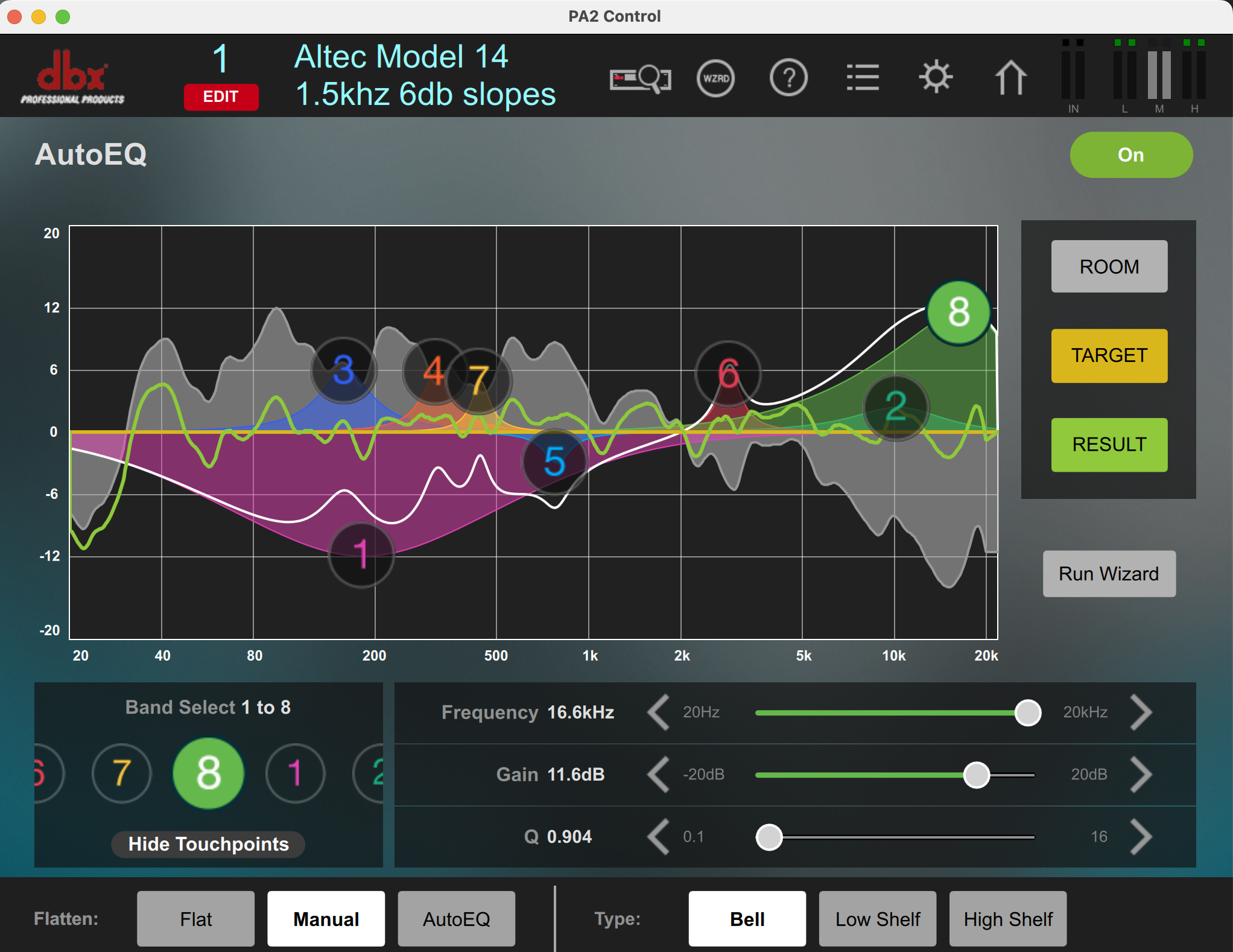

& the result - ignore the title as i didn't take the time to save it under a different profile. Looks like I can bring up the highs a bit more & happy to reverse polarity on one of the driders and try again. I see the 'room' response in grey still has that ~3k dip ~-6db before the auto eq, which appears to have fixed it with the #6 peak. (clicking on it shows 2.9Khz + 5.7db with a Q of 6.26.
I believe I can also se the target curve to a harman model instead of flat to see hot that sounds.
Open to suggesions on what to tweak or polarity changes that might help reduce the gain required at "point 6"
Manually tweaking the #8 and #2 filters, I can get pretty flat within +/- 3db. This is 12db LR slopes, Tweeter attenuation and the below parametric EQing.
Will listen to this for a while and see what parametric adjustments I might be able to eliminate or combine. Maybe also, I'll switch over to a harman target curve and see what happens. Also, it seems I may have some play in increasing the HF gain as it seems the 1st parametric filter is bringing that all down 12db (pink #1, 183hz, -12db, Q .608)

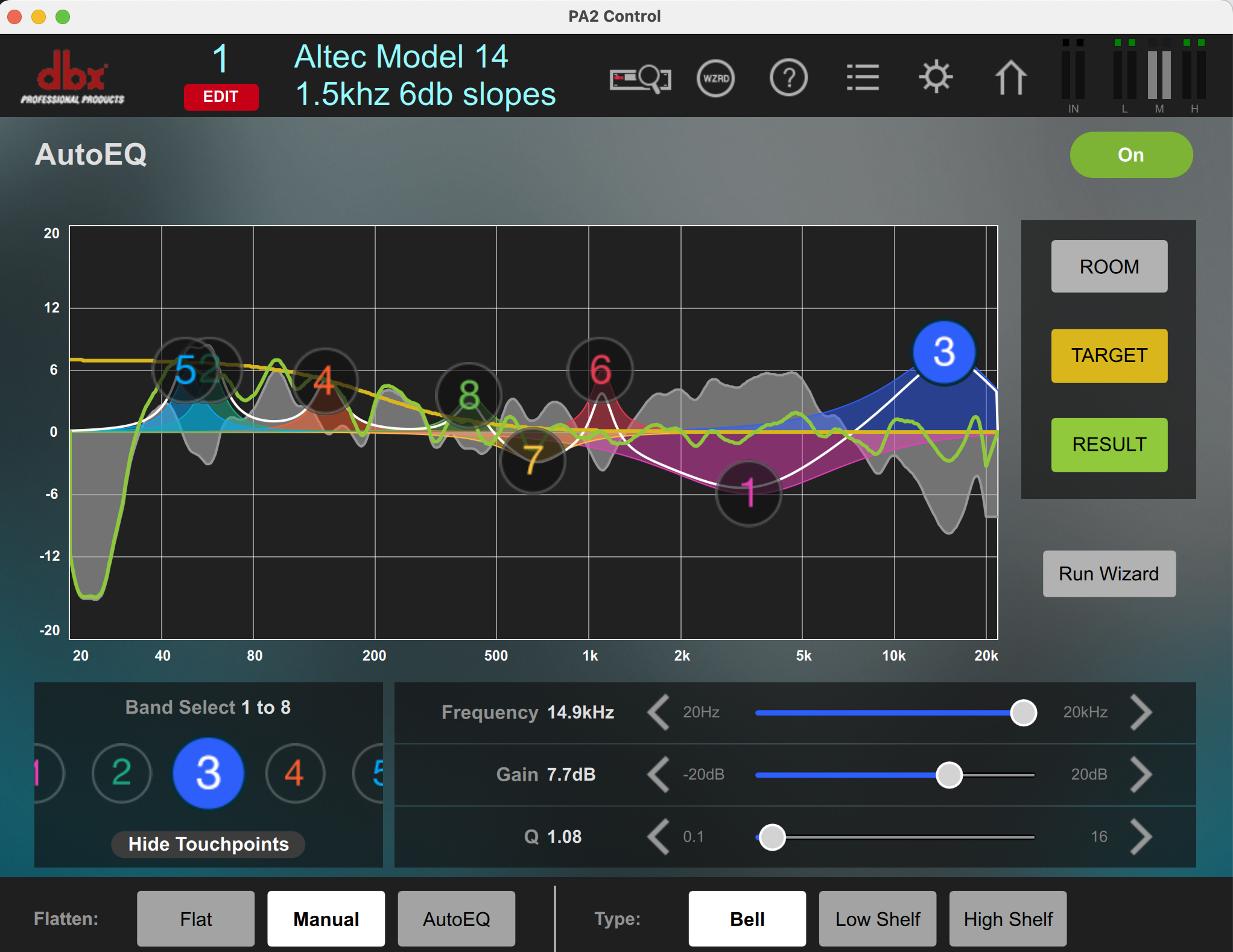

Setting gain equal seems to help a fair bit. Same 12db slopes but harman curve target. Will listen to this for a while and play with polarities at the seating position.

Thanks, I've found the same and switched to a Harman target. Also, I manually EQ's to improve the response and get closer to the curve and reduce the number of EQ points
I suspect the dips/peaks below at 2, 3 and 8 are room issues. Perhaps #8 is suckout where the cross is, I can verify by playing with the xo point and overlap to check.
I suspect the woofer and tweeter rolloff (addressed by low shelf #1) on the low and high end (addressed by #5 bell curve) and the 1.5khz to 5hkz peak addressed by bell curve attenuation #7 are the speakers inherent qualities. Below is the 6db butterworth on both ends.
