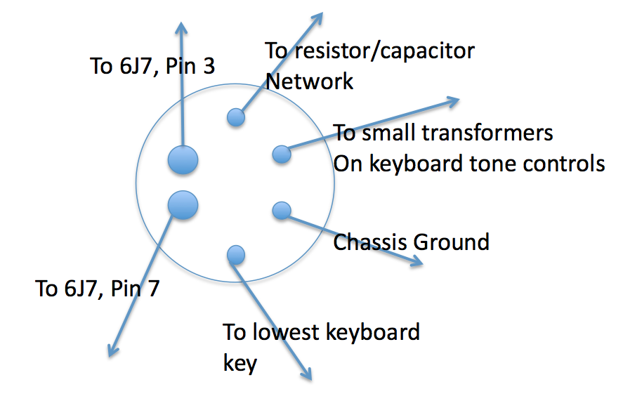

I recently purchased a Clavioline keyboard -these were sold from the late 1940's through the mid 1960's and are famous for being used on 'Telstar'. These came originally as a set with a small amplifier -usually a Selmer or Gibson- that, through a multi pin connector cable, powered the keyboard and carried the output signal to the amp. Unfortunately the keyboard I bought didn't come with the amplifier or cable so I have no way to power it and play it.
Here's what I need help with: I want to make a breakout box that will power the keyboard and use a regular 1/4" instrument cable to run the output signal to an amp. There are 4 tubes in the keyboard -a 6J7, 2 6SN7 GT's and a 6J5 -I am thinking this is the preamp section and wants 6 volts, so two of the pins provide this. Obviously there is a ground so a pin connects amp ground to keyboard ground. There's also probably 2 pins for the output signal. I'm guessing the 6th pin is for a tremolo or some other effect switching between the amp and keyboard.

probably 2 other of the pins provide B+ (high voltage) and power supply ground (chassis). You can determine what voltage this should be by looking the tube datasheets up on triodeelectronics.com website and keeping the voltage under the maximum. You can look for the B+ to connect through resistors to the plates of the tubes. You can look for the 6 VAC to connect to the heaters of the tubes.
From a capacitor attached to the plate of one tube, should be the voltage output. It might go through a level setting potentiometer, first.
People figure stuff like this out all the time hooking leslies up to organs. Some organs got the B+ from the Leslie, some vice versa, some the B+ was independent and the only links were AC signal, on-off, and 120 VAC.
Look in your keyboard to make sure there is not a 120 VAC to heater and b+ transformer. It would be near large capacitors (10-40 microfarad, mf in 1960) at B+ voltage, IE 300-400 VDC.
If you don't have a multigang cap near a transformer, you might have a single element 10 mf @400V cap for local B+ stablization.
You'll have to trace the circuit out, at least on the power side, to determine what you have. Expect any electrolytic caps, that is ones with + on one end or circles moons and triangles near multi-terminals (all plus) to be dried up and potentially explosive. The rubber seals deteriorate from oxygen and the water leaks out.

I think it's keyed by having two fat pins out of the six. Don't have it in front of me to check though. In the interest of safety I'm going to find some one local with the right equipment to test everything and help me power it up the first time. Anyone in Oakland want to earn a few bucks?
I hate to assume it's the same, but... all the Claviolines were made under license so... probably the same or similar enough. Here's where the pins go. Looking at 6J7 specification, I don't know which is heater.
