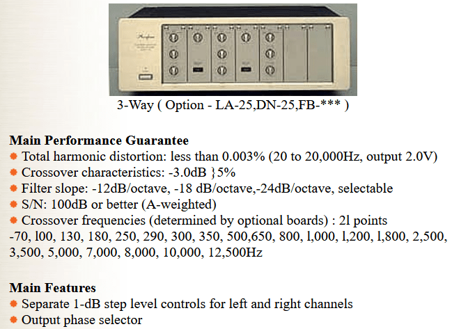

perhaps this one https://www.accuphase.com/cat/f-15en.pdf came with customer selectable xo board modules.

Hi Juhazi, it is an Accuphase F25. Finding a FB-2500 (frequency board) or FB-3500 is almost impossible. Maybe I can try to replace the components on my FB-5000 to get to 3000 Hz. Indeed, 350 to 5000Hz is challenging. I was just curious if someone else had a better idea on how it was used. I agree on the odd frequencies.

That's a crazy piece of hardware! Maybe the original owner used the 350/5000 crossover points to replace the factory crossover of his speakers and the 150hz to cross over to a sub? Odd choices for sure. Looks to me like you can run it in 3 way and just not use the 150hz.

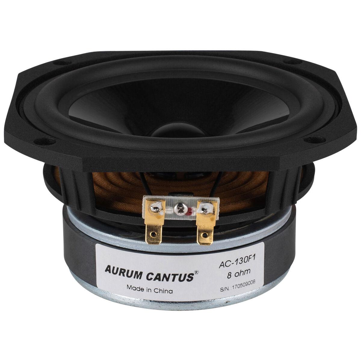

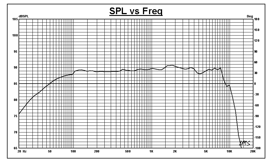

If I had crossover with 350-5k points, I would use aurum cantus ac130f1 mid with some nice ribbon on top. Below 350Hz i would use good 10-12" woofer. Just a suggestion from the time i played with 3way crossover. 4way is just one extra 15" below 130Hz 🙂
Seems all doable to me.

Something like a woven carbon fiber or glass fiber, or doped paper or poly 4" would be a good spot from 350 to 5k, something with minimal breakup. The right prosound 4" or 5" might even work. 150 to 350 I would look at prosound 10 or 8 inchers, as they can be dynamic and don't need or have the extension and do great midbass. Maybe the B&C 8P21 or similar. And a solid 12 or 15" for the bottom to match.
