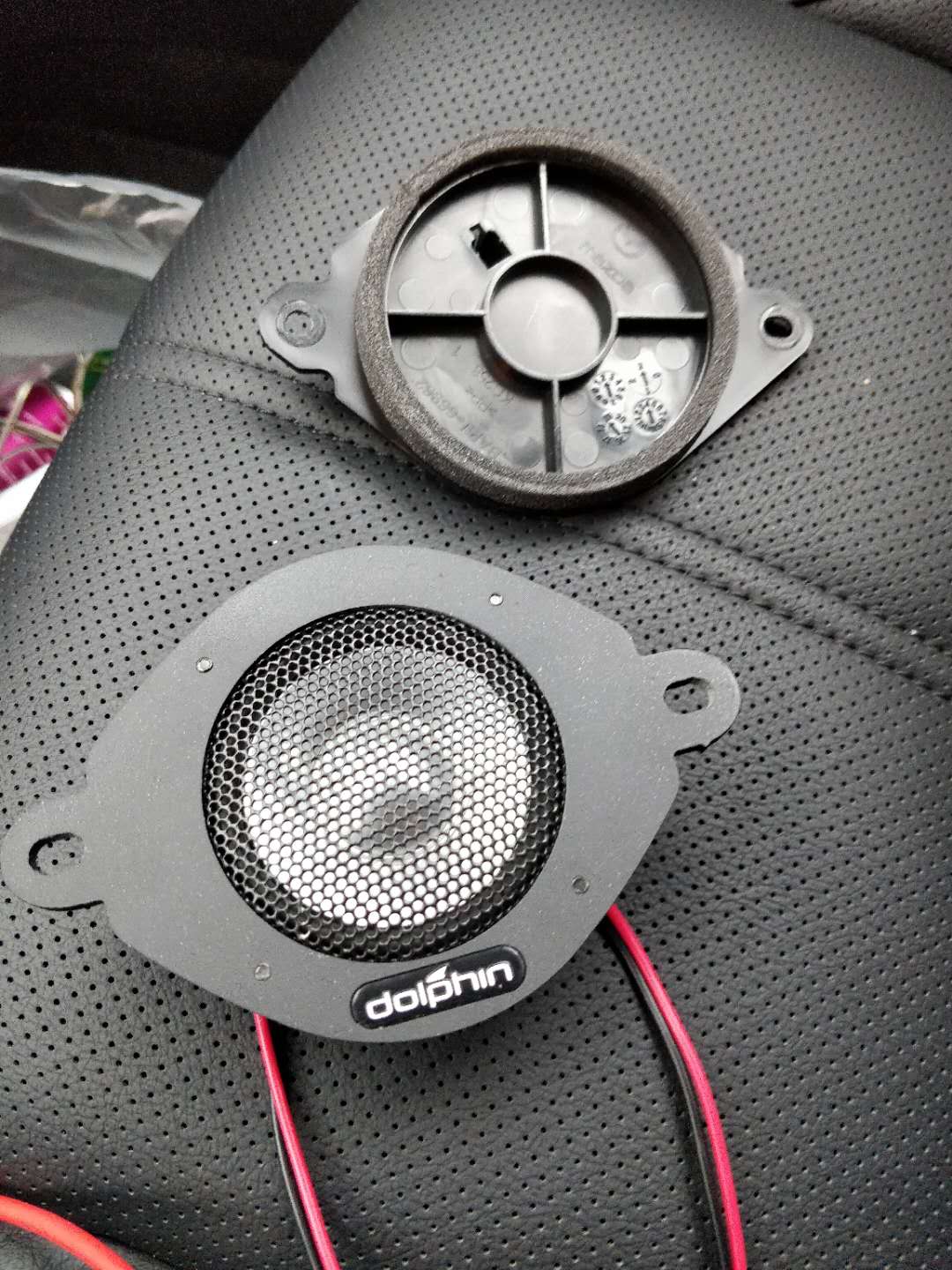

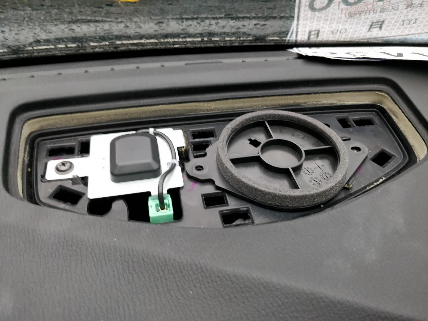

Ordered a center speaker. I'll feed it from the original unfiltered tweeter lines. There is a dedicated spot in the dash for it that has been vacant. 800-18KHz with dual coil fed from left and right channel. This should fill up any mid gap and give me some more vocals.

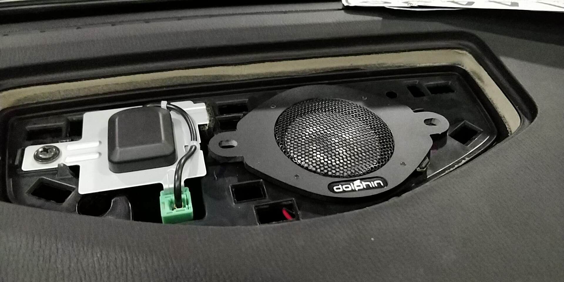

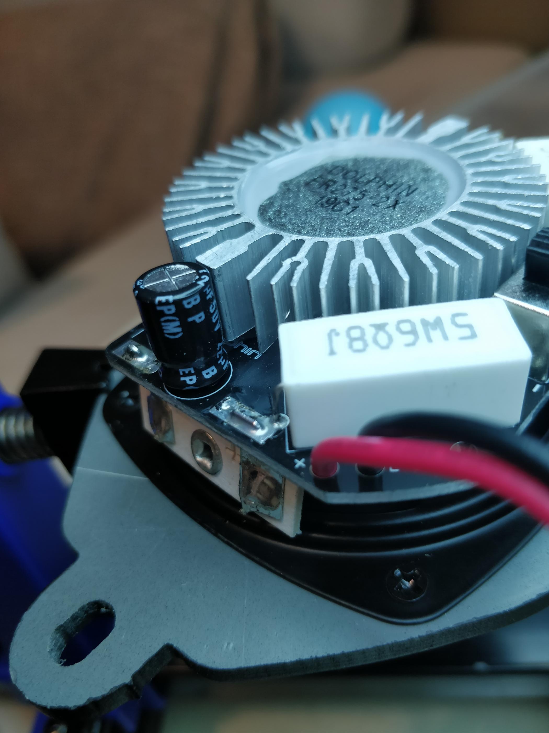

And I added a center speaker which opens up the soundstage a lot and adds nice detail and more vocals and snare instruments to the music. It came with some Chinese cheap *** 22uf apacitors and I'll replace them with some Muse BP caps just to be sure.

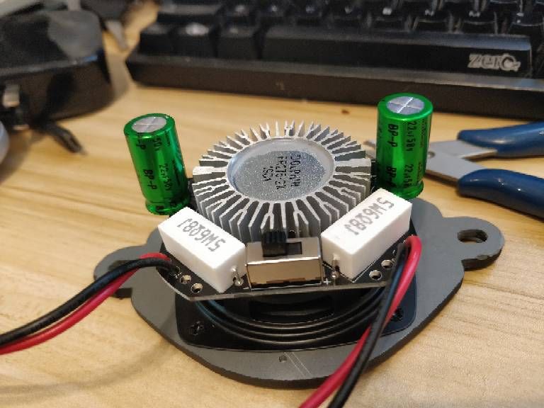

Those Muse BP-P caps are freaking huge but sound very clean. A little more harsh than the previous black caps. but I think a few hours of running should take the harsh edge of. From my experience with new caps they smoothen out a bit after a few hours of load, especially bigger ones. I know everyone holds his own opinion about cap burn in time. Not to start that discussion here.
