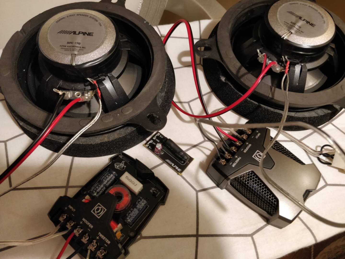

Hey guys,
I'm finetuning my car audio setup and replacing the standard crossovers with something more capable.

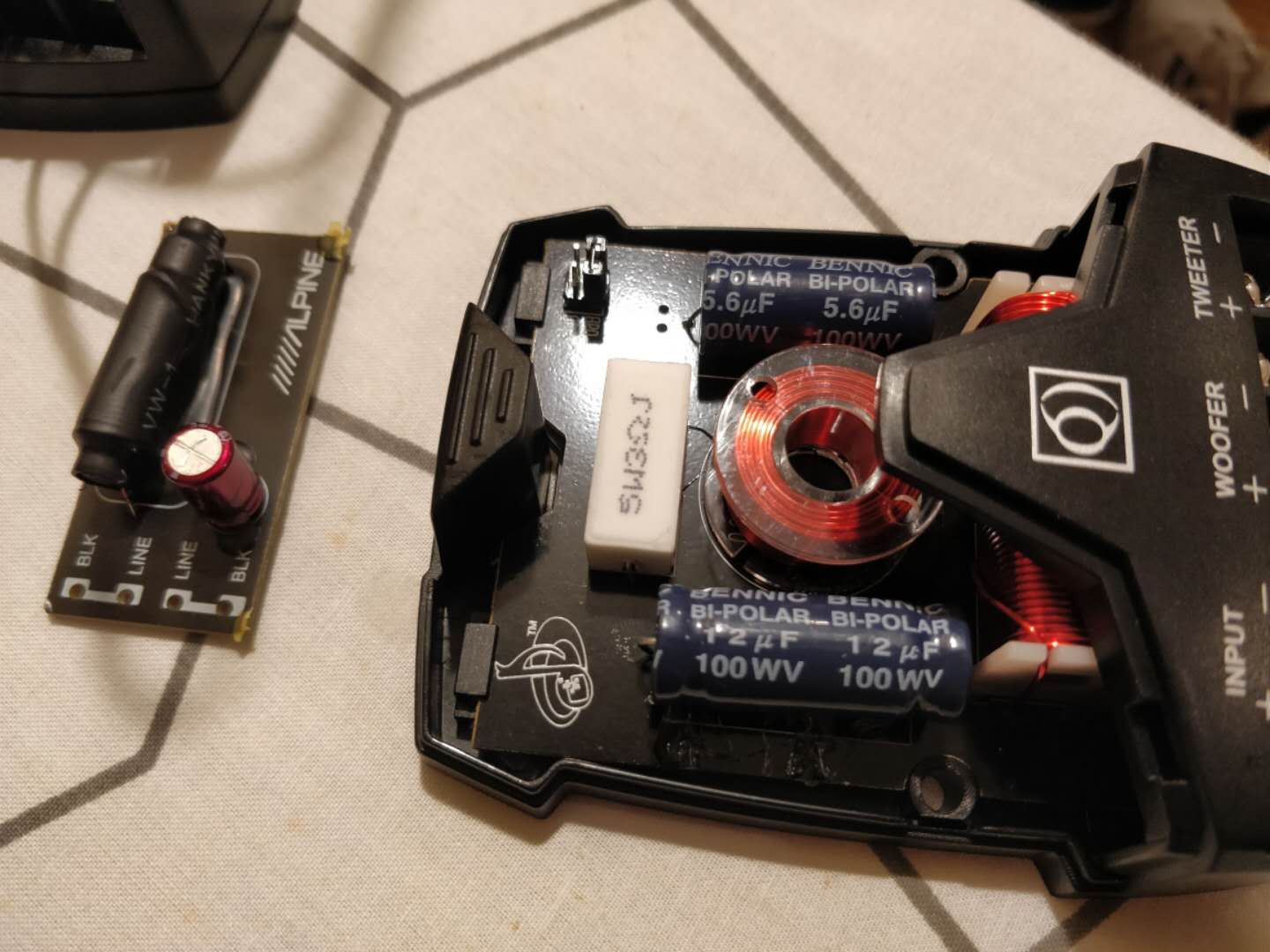

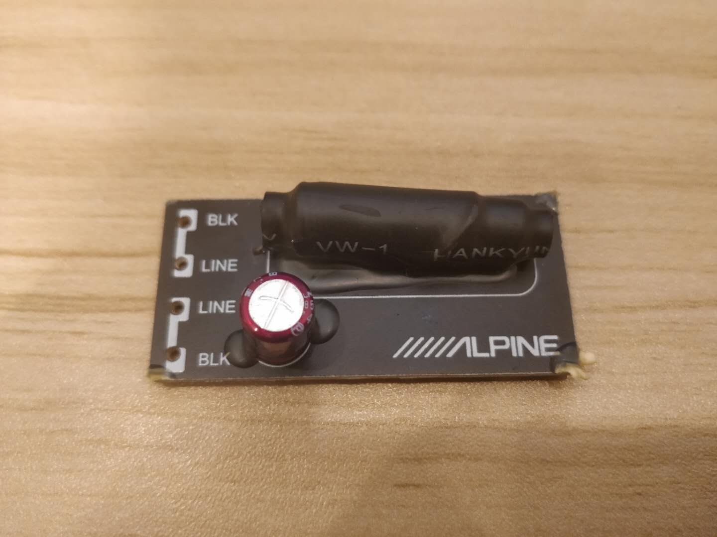

The original crossovers where a simple inductor and capacitor in line with the tweeter and for the rear coaxials it was just a simple 4.7uf capacitor on its own.
I've asked Alpine for the specsheets of the woofers and tweeters but no response. I can't find any usable info on the frequency operating range of the tweeter so I'm kind of in need of reverse engineering the provided crossover to have a guess how low the tweeter can go and design the new crossovers.

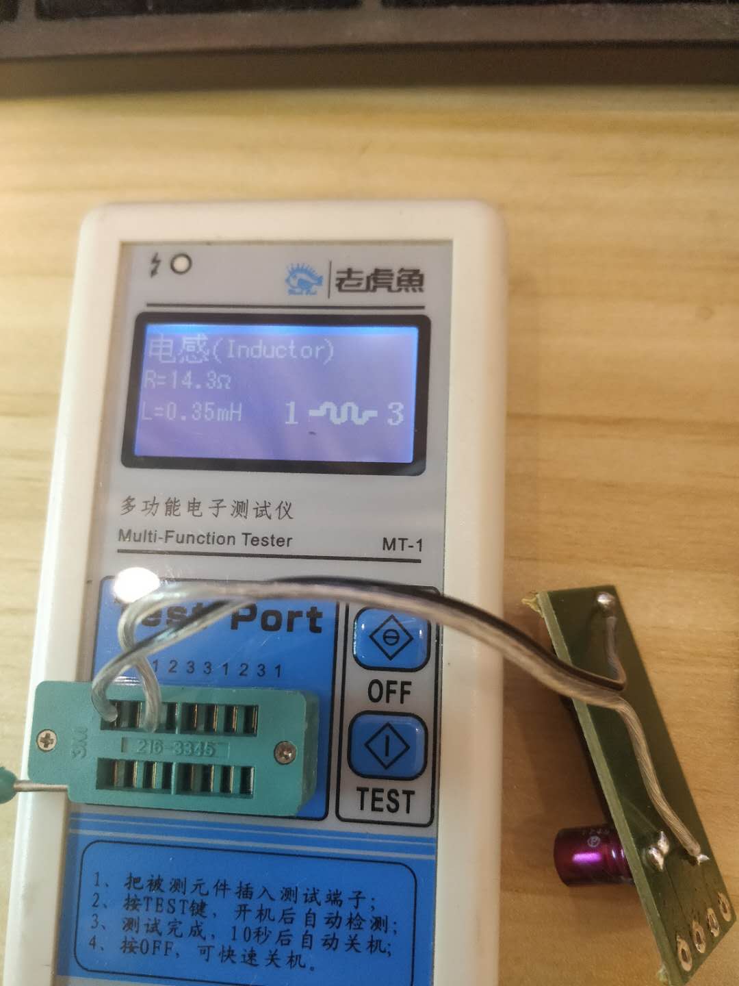

Point is. I have no idea how to simply reverse engineer them. I don't know the inductance of the tweeters. But I guess there is something I can do with a resistor instead to measure. But I'm not 100% sure how to do it.
I've got a Fluke multimeter and a device to measure parts by putting a current through it like transistors and in this case the inductor.
The inductor measures 14.3ohm and 0.35mH
The capacitor is 4.7uf
I'm pretty sure this should be enough to figure out the intended crossover frequency of the manufacturer. But not sure how to calculate it reliably.
Can anyone point me out in the right direction?

There were no crossovers on the woofers and it sounded horrible.
I used the DSP to filter out lower frequencies but hearing the woofers try to do the higher frequencies was just horrible too.
I already installed new crossovers at 12db 3.3KHz frequency which sounds alright to me. But there is 600mhz difference with your calculation. Would it be dangerous for my tweeters?

Let's say I want to raise the crossover frequency a few hundred Hertz to let's say 3600. How would this translate to changing the 12uf and 5.6uf capacitors in my crossover?
The 12uf and 5.6uf provide 3.3kHz with a 12db slope by specsheet of the crossovers. I haven't measured the inductors yet.
Choose one component (L or C) for the new frequency. Use the formula in post #2 with 3600, to find the other component.
How it behaves depends on whether you reduce the inductance (increases the Q factor), or the capacitance (reduces Q).
