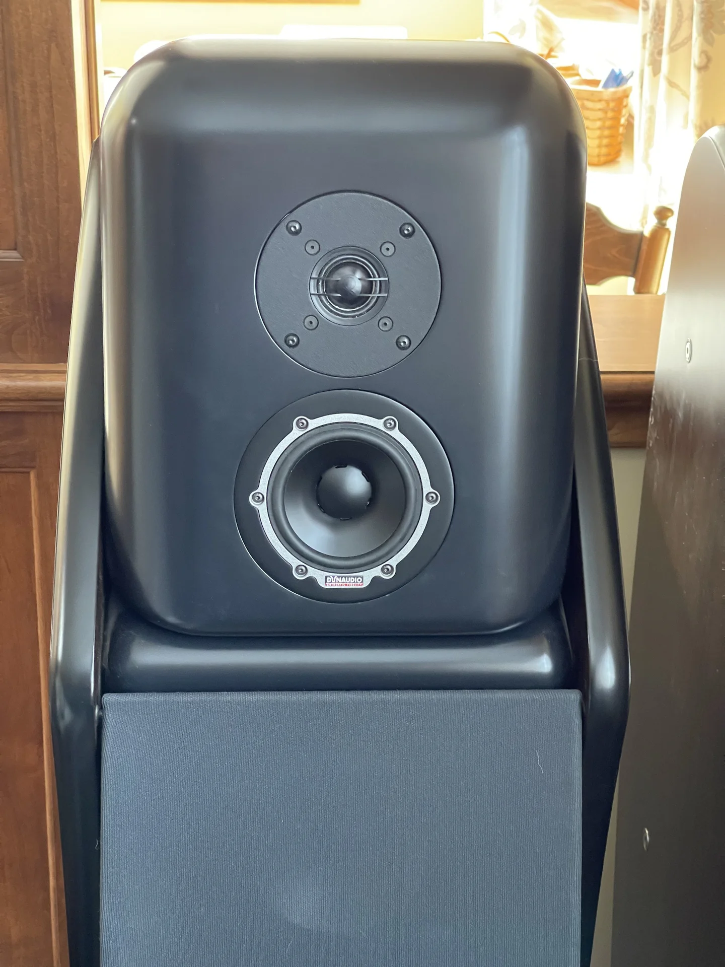

Not cheep and easy fitting, but Dynaudio Esotar 430 supouse to a good replacement for the 4 inch.
The new one is here:
https://www.woofersetc.com/p-9307-e430-dynaudio-35-esotar2-series-midrange-speaker.html
But try to find a used pair of the first modell.
https://www.hifishark.com/search?q=dynaudio+esotar+430
SB Acoustics is 96% cheaper and 2mm bigger. Might fit: https://www.madisoundspeakerstore.c...2cacs25-04-4-white-ceramic-cone-woofer-4-ohm/

View attachment 1403564That is crazy expensive.
Aren't we missing something? This is a replacement midrange driver on a $16k speaker from 2000. Feels like putting a $50 tire on a 1960s E type jaguar. I would rather find a higher performance driver in the $400+ range. No?SB Acoustics is 96% cheaper and 2mm bigger. Might fit: https://www.madisoundspeakerstore.c...2cacs25-04-4-white-ceramic-cone-woofer-4-ohm/
Here’s some measurements of the revel: https://www.stereophile.com/content/revel-salon-loudspeaker-measurements
Revel used to use SB Acoustics:
https://www.sensibleaudio.dk/2022/05/27/what-drivers-do-they-use-revel/
YMMV but I would personally prefer to replace a metal coned driver with a metal coned driver, not a tupperware driver.

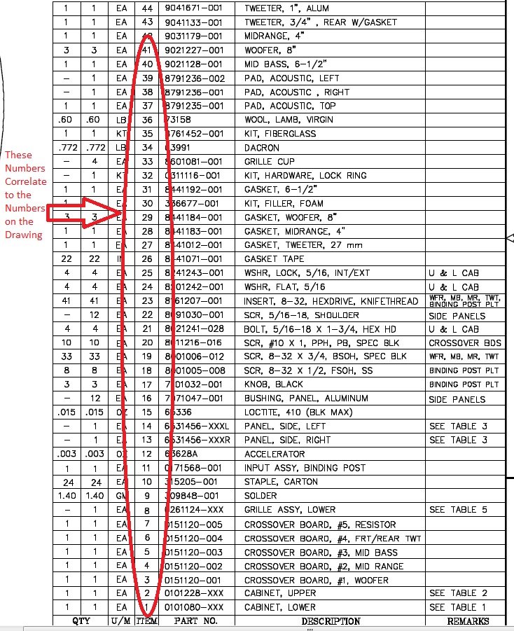

I am afraid your concern is unwarranted. You need a decent driver of appropriate sensitivity covering
400-2,200 Hz range. It is likely you would need some x/o filter mods to blend the responses smoothly.
I am quite confident Revel has a solidly engineered filter around a basic drive unit.
Have you studied the original x/o filter?
Yes indeed!I am quite confident Revel has a solidly engineered filter around a basic drive unit.

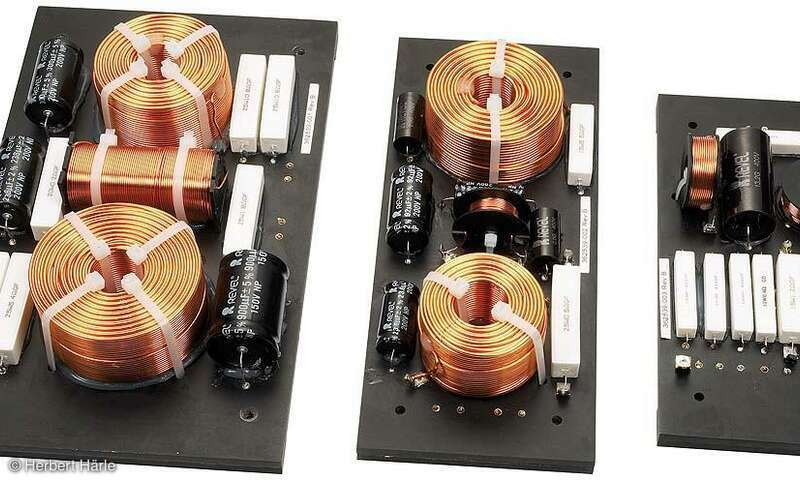

Burn a tweeter coil when i had the Salon´s 1 20 years ago.
All xover was like "a painting", but a little thin bobbin thread on the tweeter for my listeningslevels.
I made a new with the same mH and DCR

I just replicate the 0,53 rear tweeter coil, but all the Salons xover have a high standard.How difficult was it to replicate the crossover? What was the quality of the crossover?
Sorry, not have them.This thread is great info! @jawen - do you by any change have the same drawings for the Revel ultima Studio - ideally all the crossover ones? Thanks
What i know is the Salons and the Studio the same, exept Salons extra 8 inch woofer.

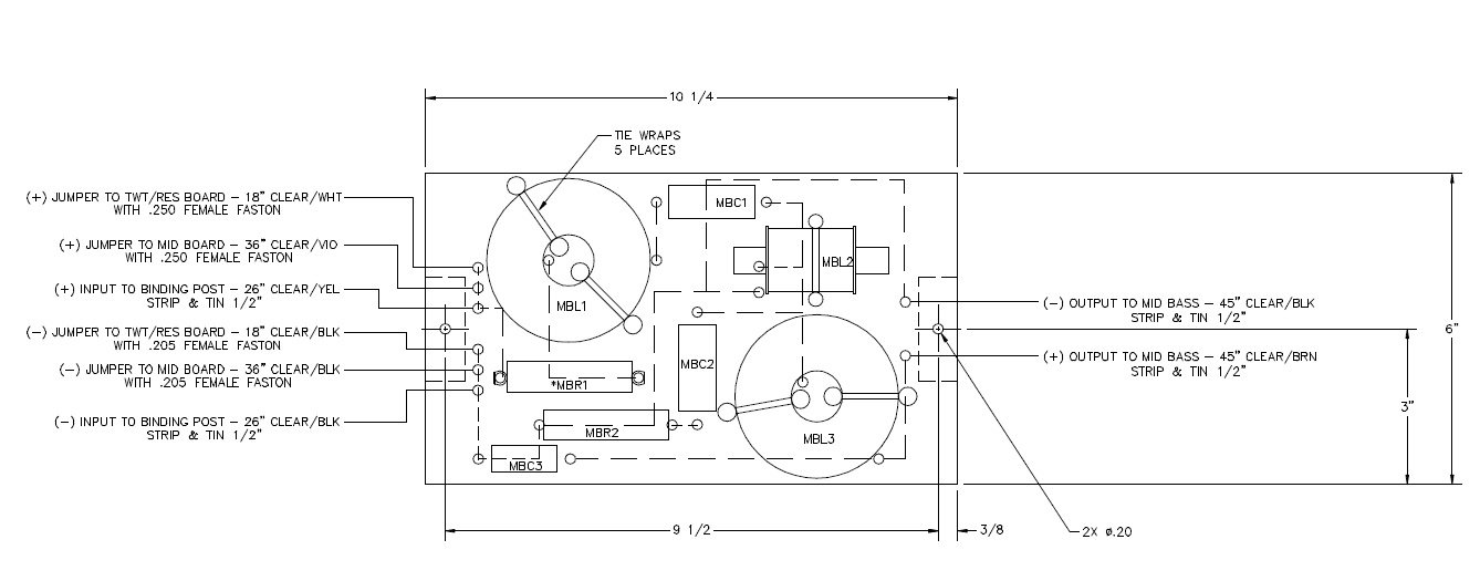

Herevis a pic on Studio 2 crossover
@jaewn- would you have a picture with more resolution so I could read the resistors, as it would make it easier to build the xrossover. thank you
and the salon1 has a 4 inch midrange alonside the 5.25 inch midrange and an extra 8 inch bass unit, when compared to the studio
Sorry i haven´t@jaewn- would you have a picture with more resolution so I could read the resistors, as it would make it easier to build the xrossover. thank you
