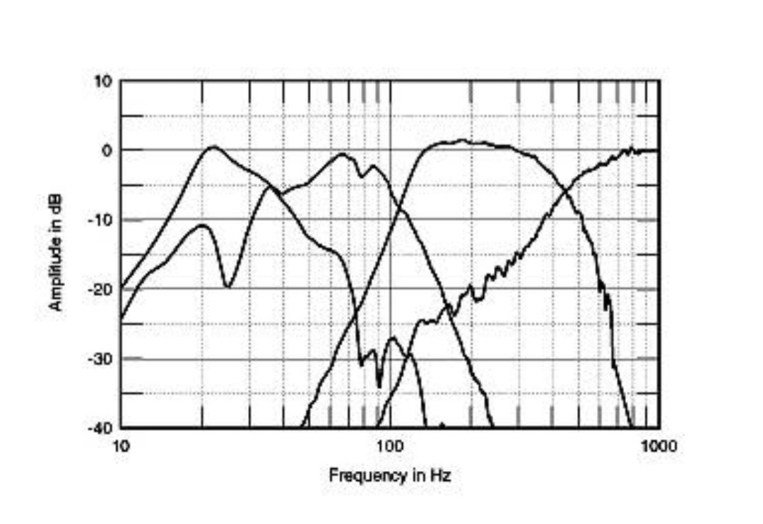

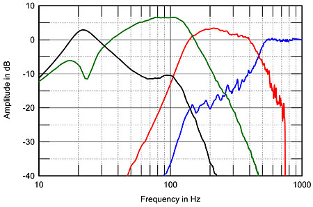

The mid is crossed pretty high in the Revels, about 450 hz and goes to roughly 2.2k. You'll likely need to pad most cone mids down in level.
I do remember the VC glue joint failing at the diaphragm junction, so repair wouldn't be simple if even someone experienced tried to fix it if the VC didn't measure open.
Here are the individual driver FR and xover points -
