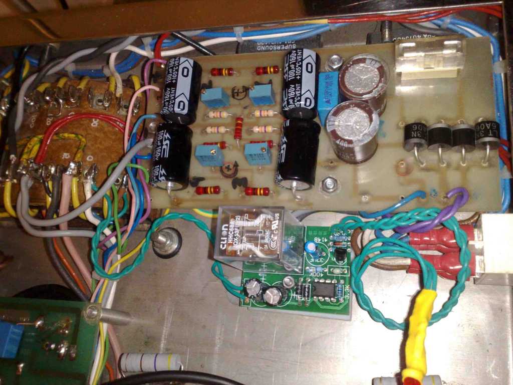

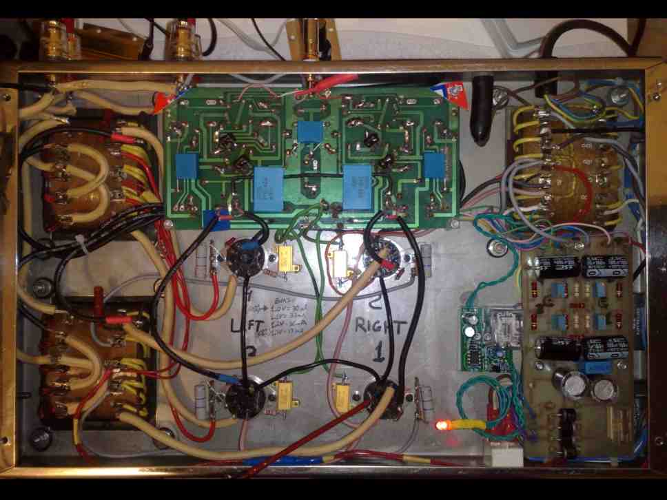

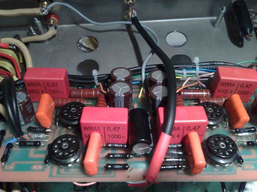

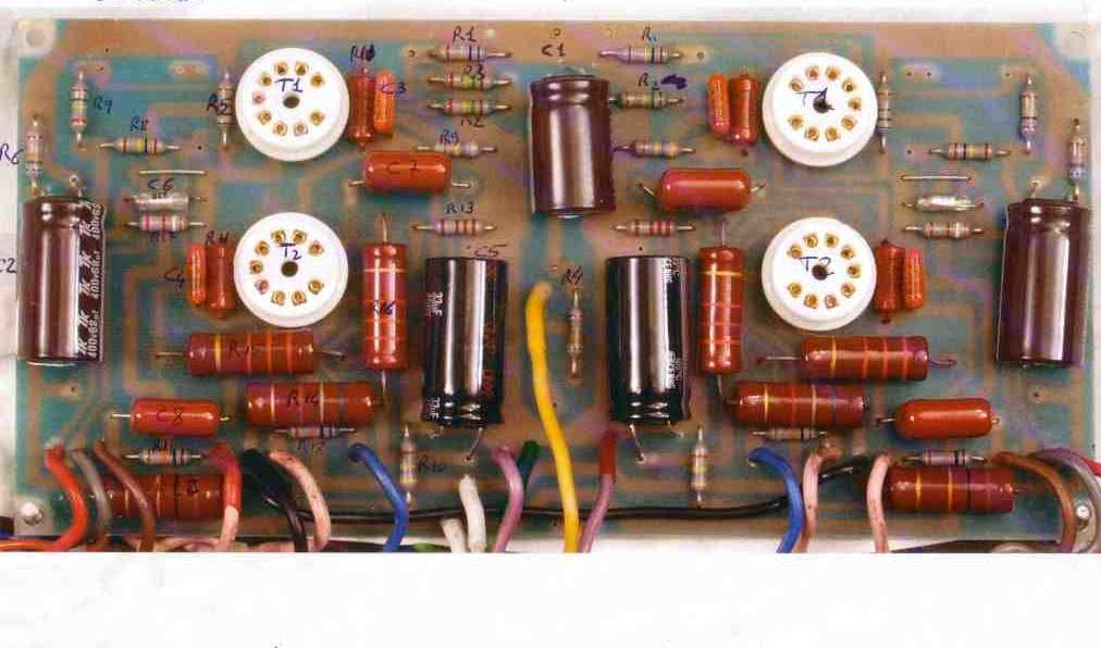

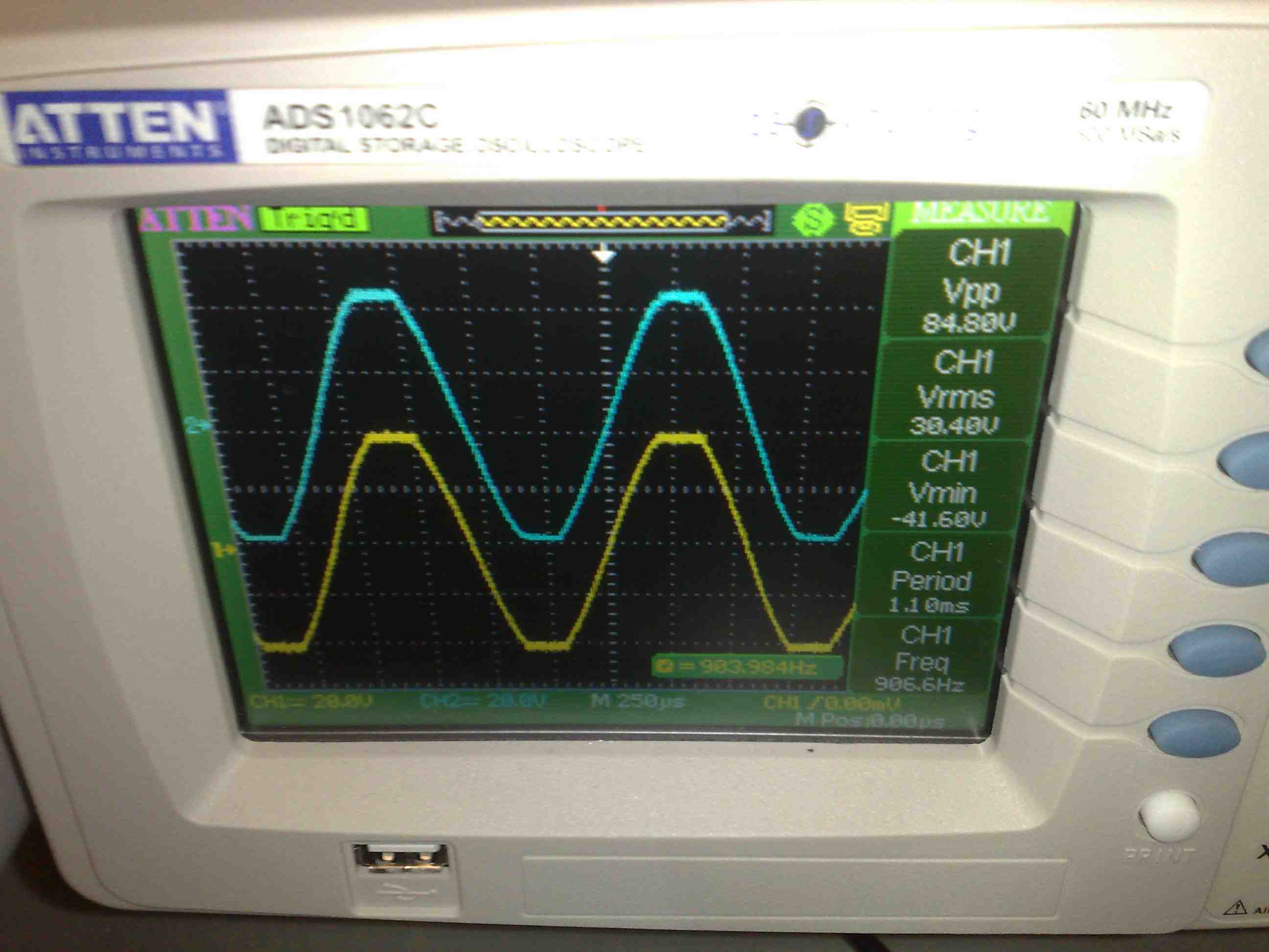

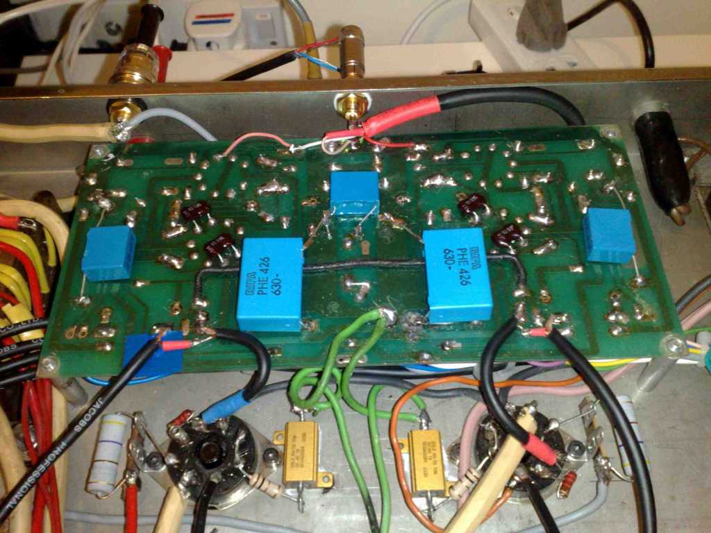

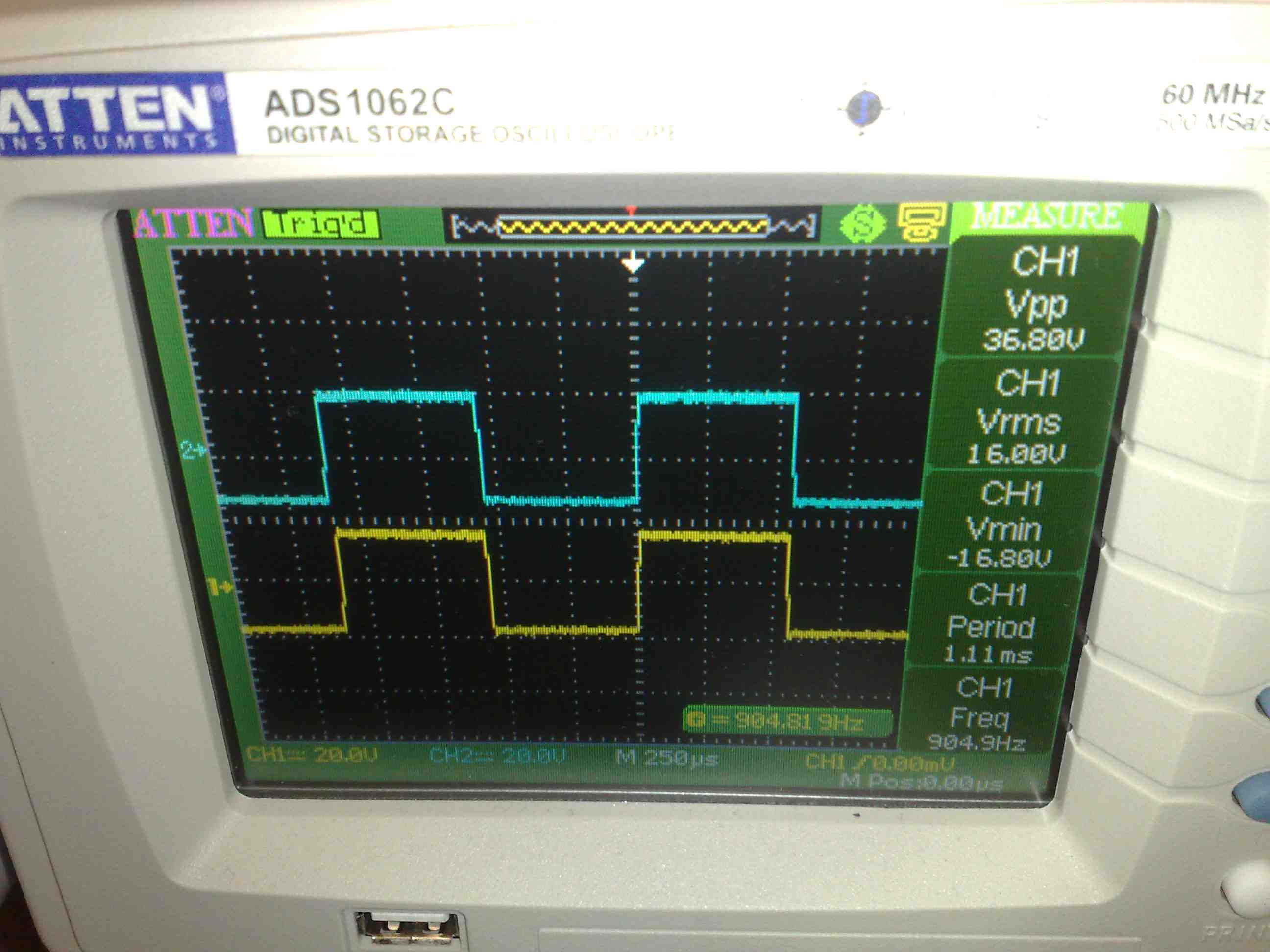

I have been requested by a few members to post about the revamping of my TVA-1 (which I did in 2009 - time is fast...), which is still working very well, so I attach the narrative and a few photos.
I am available to provide additional photos and/or information / clarifications if necessary.

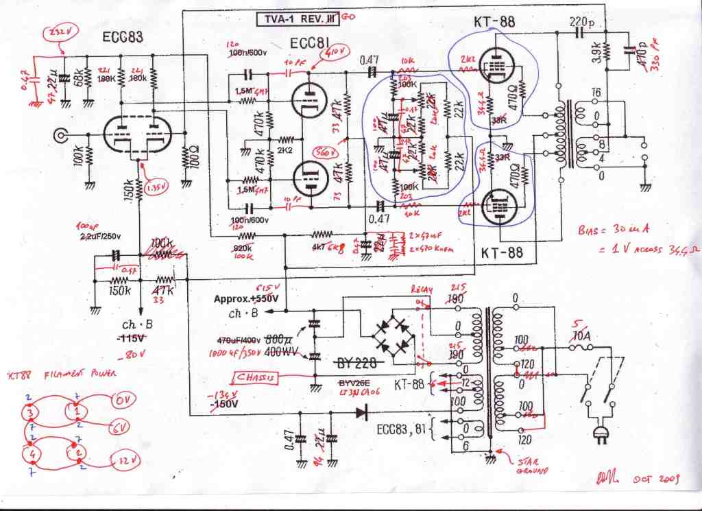

Hello Giovanni,
First of all thank you for the TVA-1, Mentmore pictures and your precise description of the changes you did make after receiving the amplifier.
As I own one erly version of the TVA-1(before sold to Mentmore) which was received with major changes in bias as well as ground wiring, I got the same hum problems described by you.
The only thing I really would like to know :
Where did Anthony Michaelson and Kevin Austin originally make the chassis ground ? The TVA-1 has a 2 mm thick polished steel chassis . Did the two gentlemen make the ground close the the RCA connectors on the rear panel, or close to the large PSU capacitors?
Do you have a schematic of the ground wiring from your Mentmore 100, Ind.?
Really appreciate your help on this.

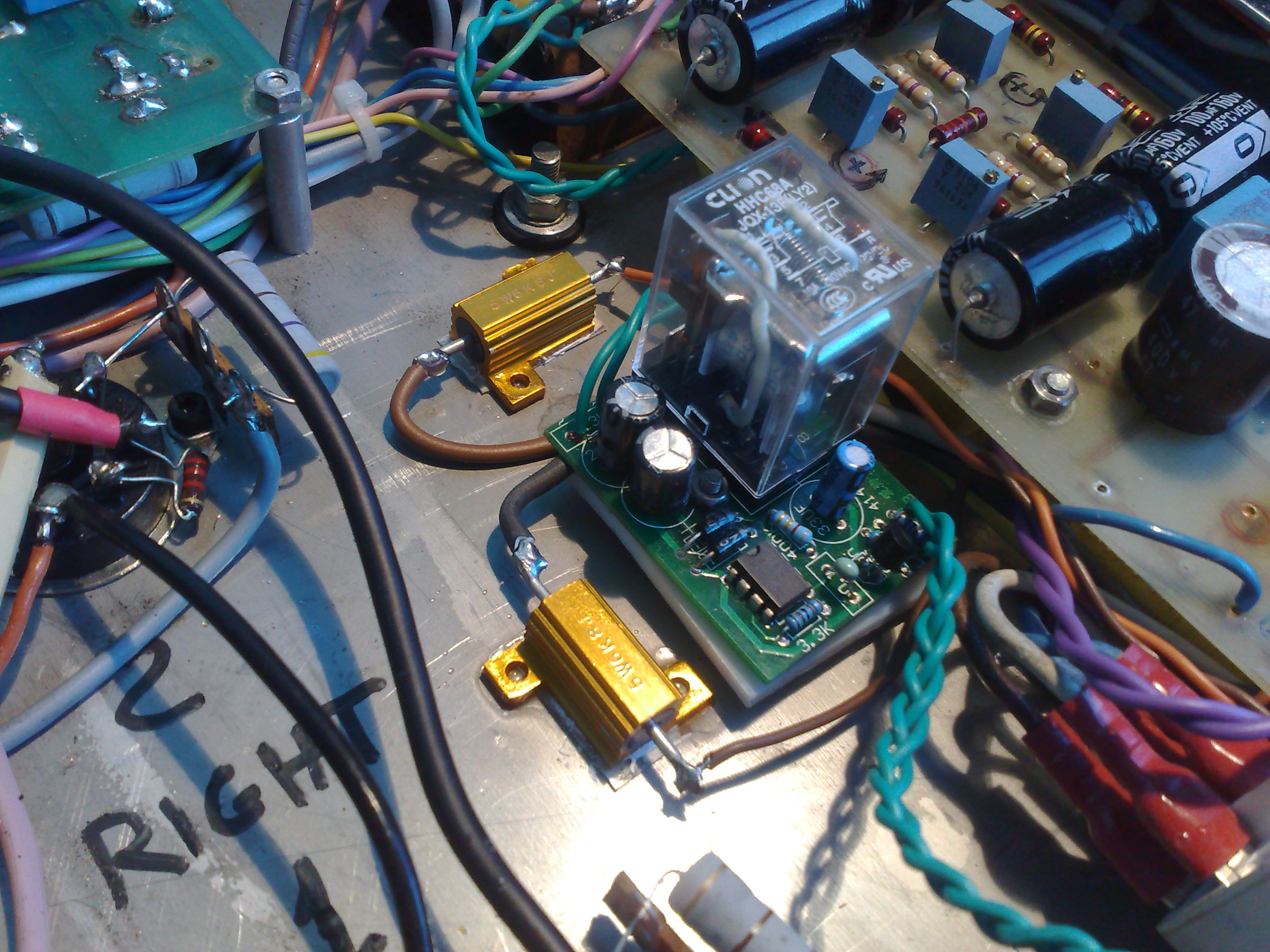

Forgot to say that some secrets of the older TVA-1 is visible on TUBEAMP
Could you explain the function of the little relay circuit on the pictures? is it high volt delay?
rgds
Hello Gudmund,
the chassis ground connection is on the power transformer, where the Earth connection from the 220V socket is connected to the central pole of the transformer (you can see it from the first picture, in the low left corner).
The little relay circuit is to apply the High Voltage with a delay (about 30 sec.) vs. the bias and filaments heating. In the final version I added 2 resistors (see the picture attached) such that the HV is gradually increasing, so to treat even more gently the tubes. I put 6k8 resistors, a better value is a bit lower, say 4k8.
I don't have an M-100, so I cannot articulate on this.

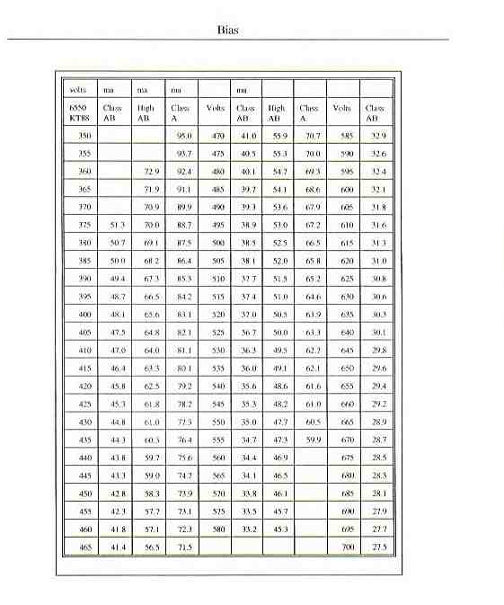

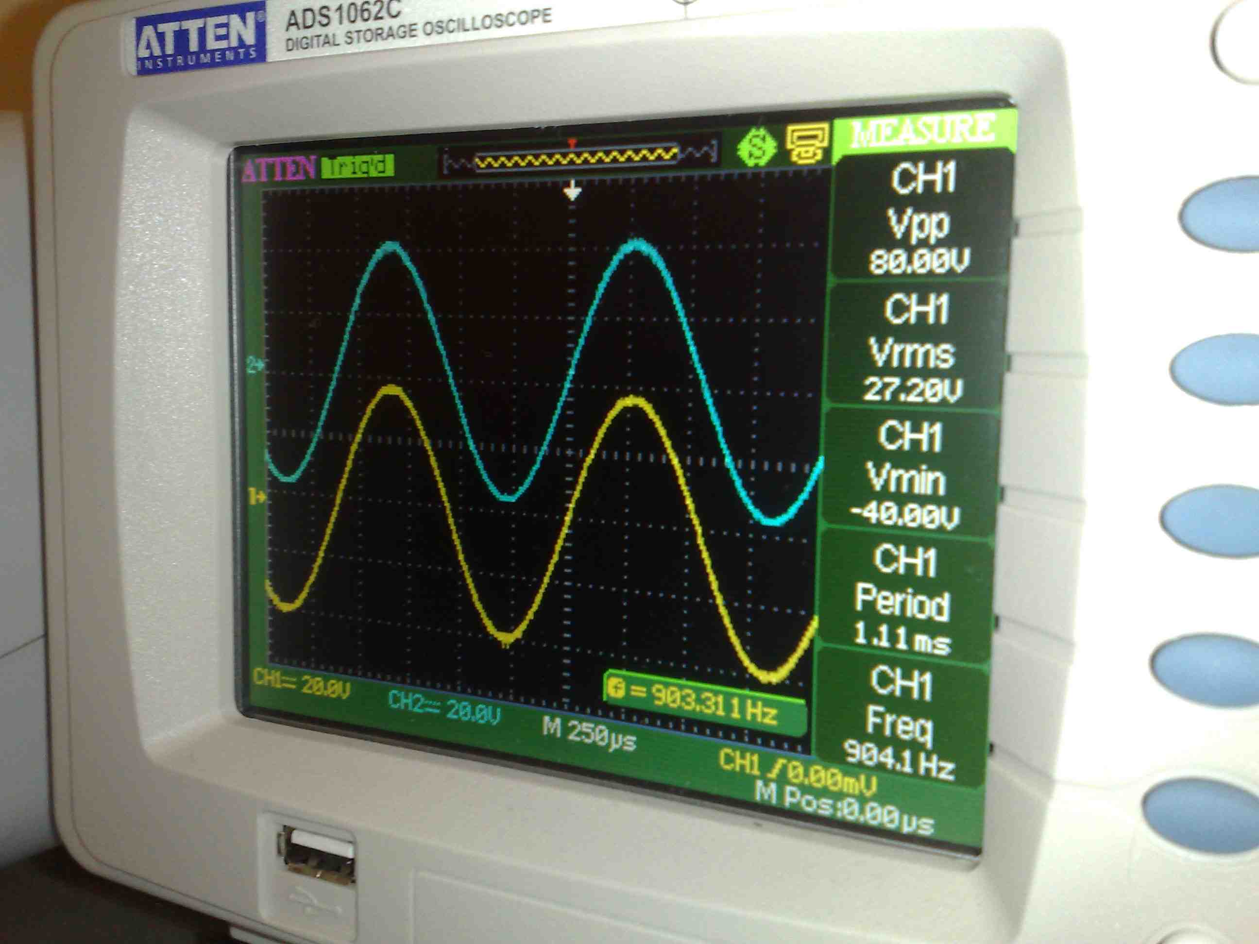

Finally, I take the opportunity to post a few more pictures, including some oscillograms which show the max. power and the clipping.
Giovanni

Hi Giovanni,
Yes - it's possible to see the black wire connected to the zero voltage central point between the two 190Vac tags on the powertransformer . This is the erth connection for the incomming AC...which could be 220Vac ....depending on the countrys local AC supply.
It's the signal chassis point I am looking for...after the two 1000uF/400V caps ....and the ground wire from the driverboard. Where are these two wires connected to the steel chassis on your valveamp? Normally the chassis do only have one central connection for all internal ground wiring....the amplifier do not have floating ground..or?
All my DIY amplifiers has a central ground point, where the RCA screen connectors ,zero voltage wires from PSU caps and ground wires from the driver board mets in one point only (starpoint). I think the TVA-1 is made the same way?
Gudmund
Gudmund,
I don't remember having seen these grounding connection anywhere, I looked at all the pictures I have and there is no sign of such connection.
The next time I open the amp I'll search for it.
Giovanni

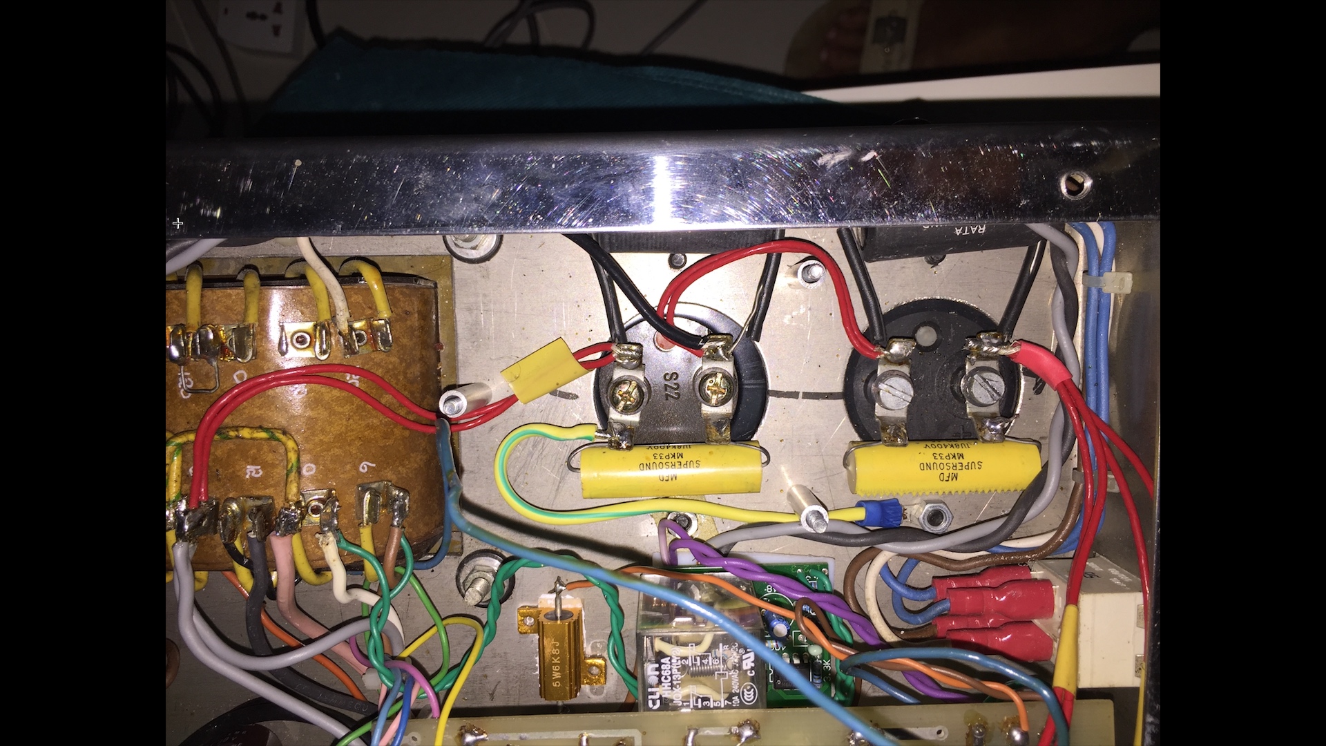

Gudmund,
I finally re-open my TVA-1 for a bias checking (all ok after 6 years of moderate use) and to replace the big filter capacitors with bigger ones (2200 uF each instead of 1000 uF), so I took the opportunity to take a picture of the chassis ground connection (posted here below), which is the yellow-green cable and is as per the schematic diagram. Hope this helps.
Giovanni
