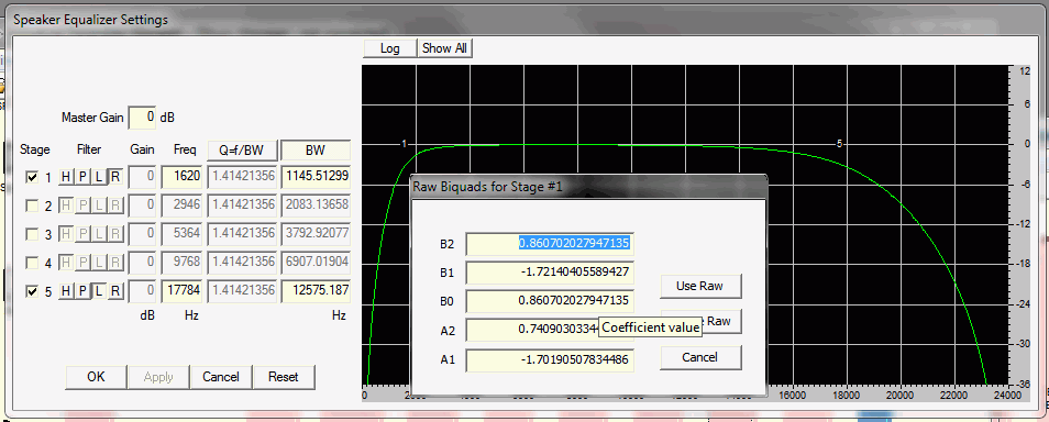

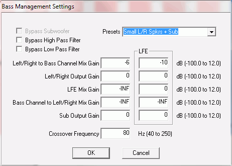

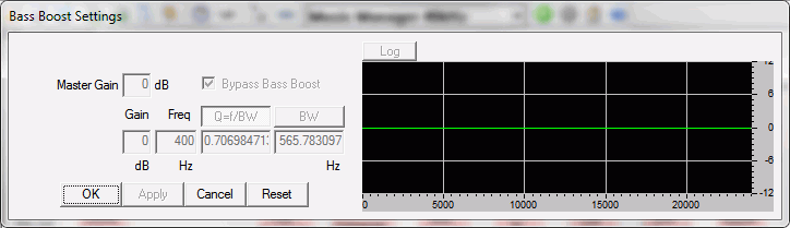

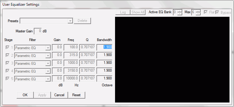

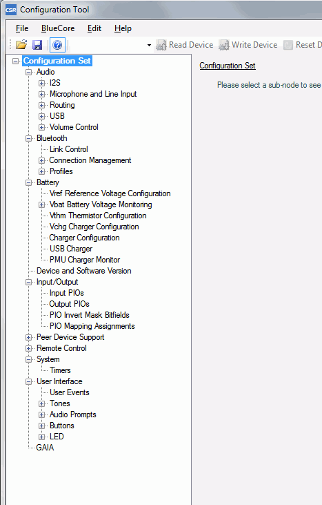

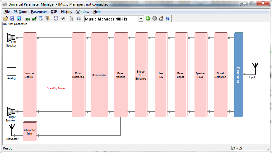

Aptx is supported by by OSX, AAC by IOS.

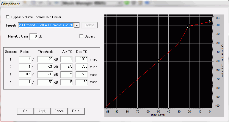

I hadn't any trouble changing keys in the firmware. AAC/APTX everything worked fine after modifications.
(As long as you stay with the configuration tool and music manager)
Who needs 30m range? 🙂
SBC is "low grade" for sure, but will you hear it, when people stream their Spotify/Soundcloud stuff encoded in low nitrate MP3/AAC? The source quality is "low grade" as well. 🙂 And what about those MP3 via SBC?

Configurable I/O pins?
Hi, I am working on a headphone with multiple I/o pins which control not only playback but a few other functions of the smartphone.
Can you tell me if these modules available on aliexpress, ebay etc can be programmed to have different functions from these input pins?
Also, the led needs to be more than just red and blue.
What is the question?
The CSR Bluecore mainly is a SoC with/without DSP-Engine build in. To change/reverse engineer/programm those chips, you'll need the ADK (Audio dev kit) from CSR, which is not available to the public. (NDA stuff)
There exist some software tools on the web you may start with anyway.
https://github.com/lorf/csr-spi-ftdi
Jernej's blog: USB programmer for CSR Bluetooth chips
https://github.com/Frans-Willem/CsrSpiDrivers
You may find some tools in china.
I wouldnt consider investing time in this "old" module but rather get a newer Core revision..
2 pcs 2015 New CSR8645 4.0 Low Power Consumption Bluetooth Stereo Audio Module Supports APTx in Funktion1. Art:F-31882. Bluetooth-Spezifikation:V4.03. Spannung😀c3.3v- 4.2v4. bluetooth-protokoll:HFP v1.6/a2d aus andere elektronische Komponenten auf
Those are the modules i want to use in the future. 🙂
