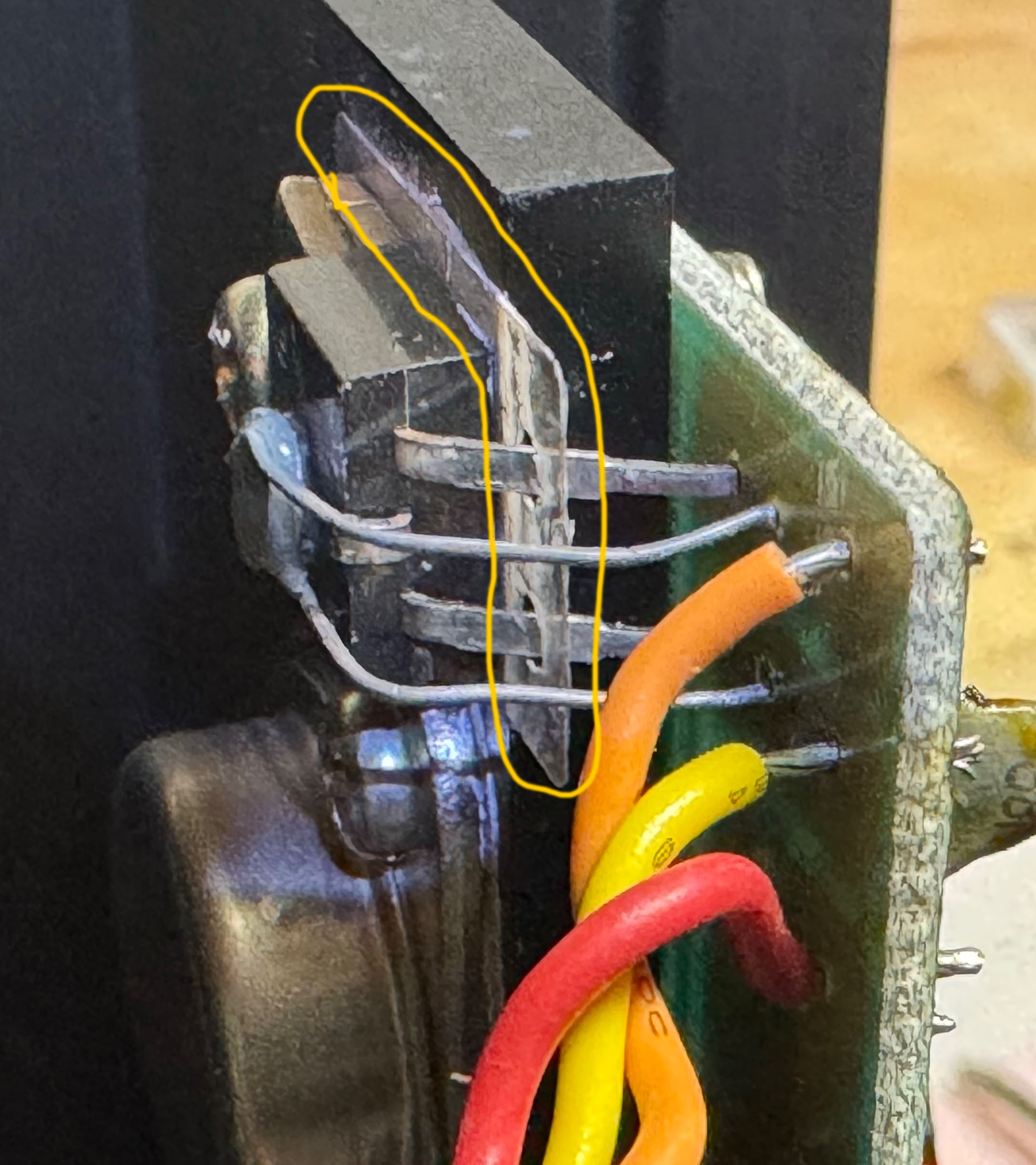

dickiedoo Member Joined 2024 2025-01-01 5:23 pm #1 2025-01-01 5:23 pm #1 Happy new year. Quick question, attached pic. Replacing/refitting components. Can I reuse the clear thermal sheet (circled in yellow)? Attachments IMG_0899.jpeg 682.9 KB · Views: 139 JonSnell Electronic Member Joined 2012 jonsnell.co.uk 2025-01-01 5:33 pm #2 2025-01-01 5:33 pm #2 If you don't damage the mica wafer taking the component off, yes you can. Use fresh heatsink compound (Thermal paste) and reuse it. Reactions: dickiedoo jean-paul Member Joined 2002 2025-01-02 9:04 am #3 2025-01-02 9:04 am #3 Best done when warm/heated up. Clean carefully with isopropyl alcohol, let is dry and reuse like previous poster said without issues. Always measure if the isolation is still OK. Reactions: dickiedoo Stuey Member Joined 2006 2025-01-02 10:33 am #4 2025-01-02 10:33 am #4 Note that it's very brittle and should not be bent. Reactions: dickiedoo M Mark Tillotson Member Joined 2018 2025-01-05 11:27 am #5 2025-01-05 11:27 am #5 Not sure its actually mica - but yes easy to reuse either way - clean and check for damage like anything else you reuse. Reactions: dickiedoo A altec9440 Member Joined 2019 2025-01-05 12:10 pm #6 2025-01-05 12:10 pm #6 Check for Short circuit after reassembly 😉 Reactions: dickiedoo You must log in or register to reply here. Share: Facebook X (Twitter) LinkedIn Reddit Pinterest Tumblr WhatsApp Email Link
