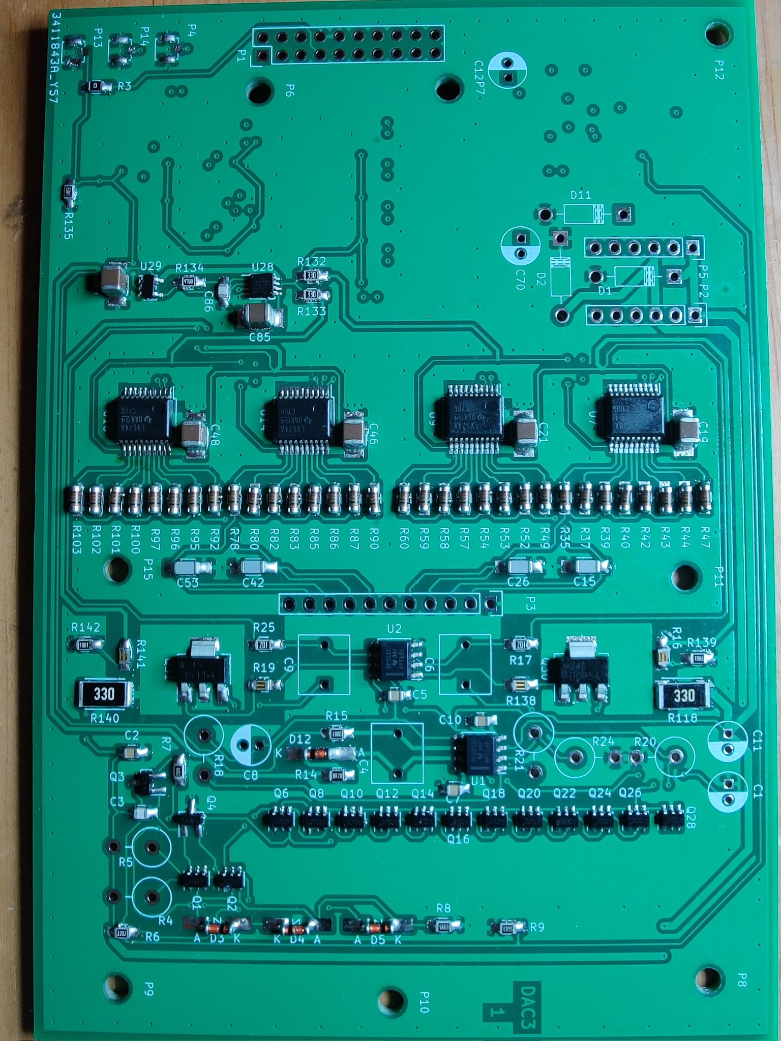

It is hard to imagine how I can improve on the excellent sound I am getting from my RTZ DACs (both of them), however, I am embarking on building one more DAC board so that I can test out some more of the ideas put forward in this discussions so far. Plus I really enjoy building! (That's probably the real reason!)
This time I've ordered the stencil too so that'll be a new experience for me and hopefully make the application of the paste more uniform and have more reliable joints.
I didn't want to play about with my two currently working and completed DAC boards so having a 3rd board is great to be able to make changes and slot in to one of my DACs and A/B compare the results (since all other factors are the same) Plus once I'm finished I will have a complete spare DAC/Filter that someone else could benefit from. Seems a win-win.

Thanks! I used the stencil this time. In fact I didn't scrape off quite as much as I should've on this side of the board but managed to recover the bridges with solder wick. The 2nd side turned out a little better with the benefit of experience.Perfect soldering job, well done.
Apparently the soldering wasn't quite perfect, lol. 😱

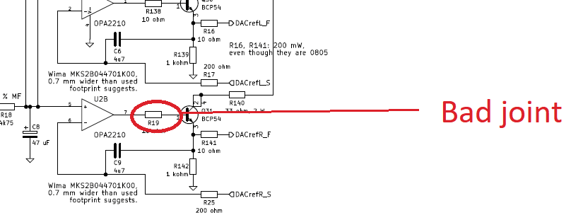

I've had a nice diagnostic session lasting quite a few hours. Ironically, the part I had expected to be trouble was the transistor stack in the reference but that worked perfectly first time. No, this time I got a nice 4.96v on the output of U1A but then only 1.6v on the clock supply. Ultimately traced (after assuming it would be the excess solder causing a short somewhere) to R19 having a bad joint. (As can be "clearly" seen in the above photo, if you know where to look. D'oh!
So, #3 DAC up and running! Hurrah!
