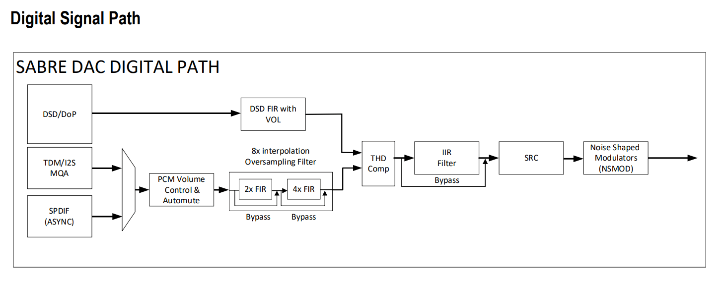

For ES9039Q2M, the digital path for DSD is shown as somewhat different from PCM:

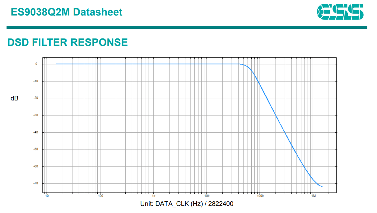

For ES9038Q2M the output filter for DSD is shown as:
Whatever ESS does with DSD does seem to be different from what it does to process PCM. Also, it is shown in the attached paper that a FIR filter can be directly applied to a DSD stream. More info on that in a PhD thesis at: https://kclpure.kcl.ac.uk/ws/portalfiles/portal/2925464/387587.pdf

It looks to me like they simply low-pass filter the DSD, thereby changing it into high sample rate PCM, and then pass it through the normal signal path except for the two interpolating filters in the bottom left corner. So apparently it is not the modulator then, but the filters in the bottom left corner?
Maybe so. IIUC some people have bypassed those filters and used HQ Player to do the upsampling/interpolation for 16/44 tracks.
Also could be that the processing in the lower left corner is clocked with BCLK and or LRCK, which if jittery may couple some clock noise into later processing. Maybe that's why some people say master mode sounds best?

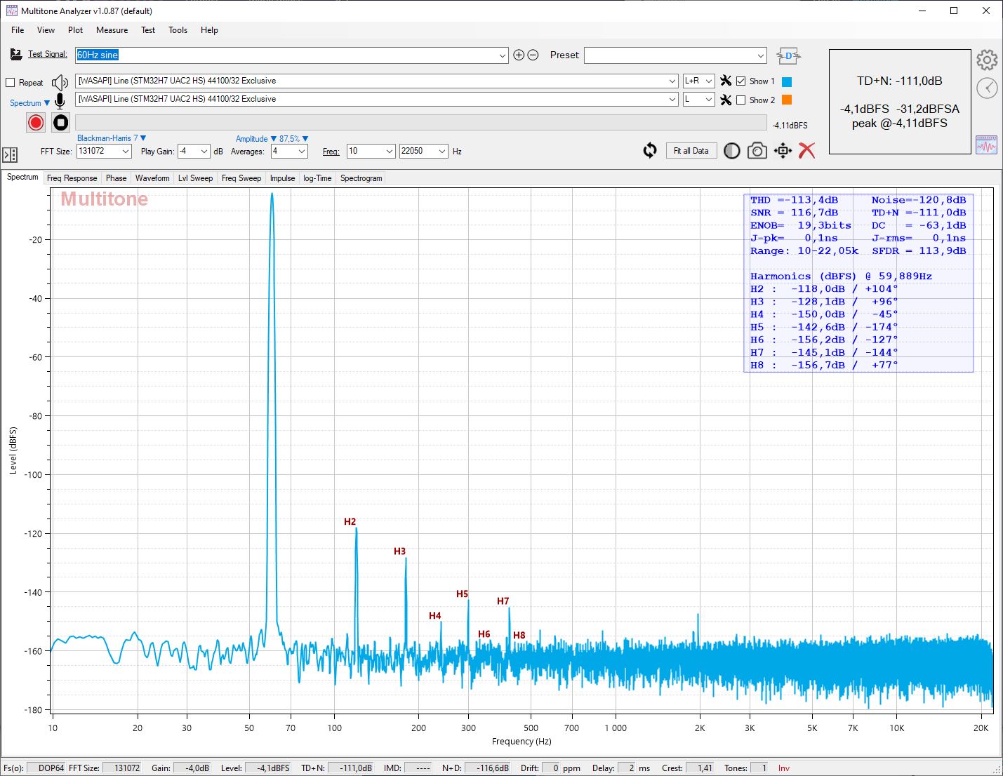

This may well be to reason. Anyhow the difference is quite clear as shown in attached measurements.It looks to me like they simply low-pass filter the DSD, thereby changing it into high sample rate PCM, and then pass it through the normal signal path except for the two interpolating filters in the bottom left corner. So apparently it is not the modulator then, but the filters in the bottom left corner?
