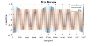

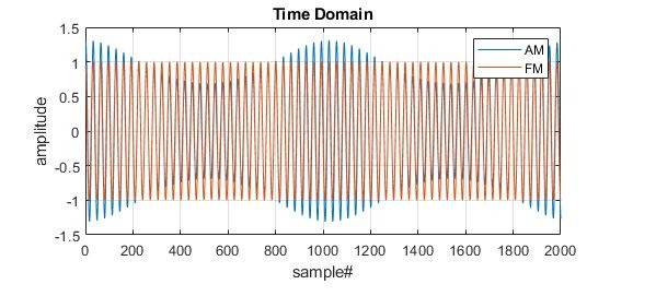

Besides, you said you did go to the Purifi website and listen to the two files that had the FFT spectrum yet sounded different. If you can hear that, you should be able to hear what I'm talking about in this case.
Once again this silly stuff. As I have explained several times already the reason for those 2 files sounding different is simply that the amplitudes are not the same. Human hearing is very sensitive to amplitude changes. In this case the amplitude variation is about +-3dB. If you have trouble hearing such variation then I guess you should not really be doing any listening tests.
Some people have reported the frequency modulation to be equally audible. Depends on the person. At least we aren't getting arguments that the files have to be listened to double blind, nor arguments that people claiming to hear a difference must be doubted. Why not such arguments? Most likely its because the skeptics can hear the difference themselves. If they couldn't, then they would demanding double blind from everyone else. It suggests the skeptics believe only they perceive reality as it truly is, its other people who aren't objective. That type of belief has a name, its called "Naive Realism."
Quotes?
As I said the amplitude difference is +-3dB. That is well above hearing threshold for normal people if not for you. So nobody but you would question this.
