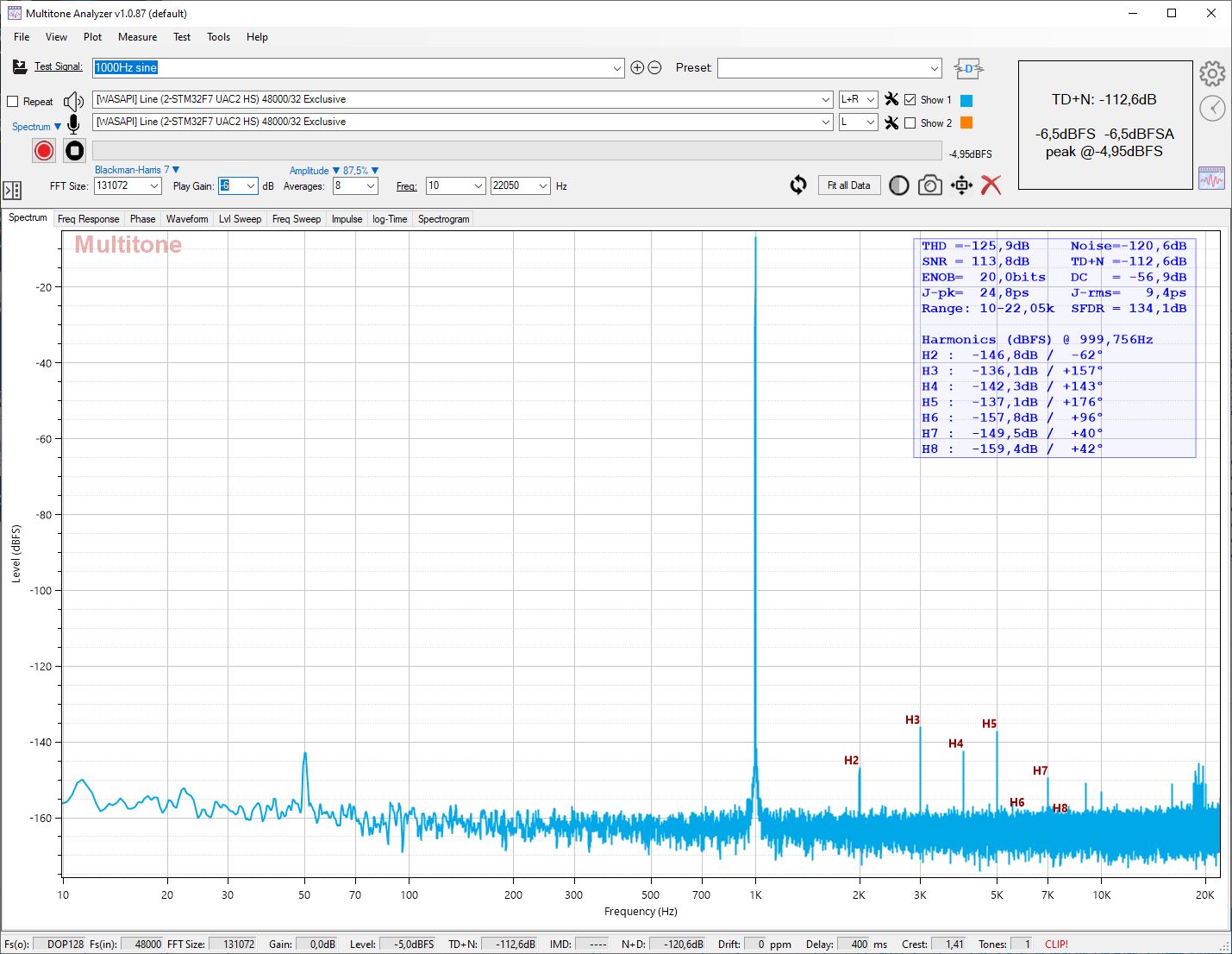

Return-to-zero shift register FIRDAC
Mark,
Fully understanding and appreciating your aiming for the best possible sound, but I can’t remember you ever tried Fifo PLUS buffer/reclocker but WITHOUT Se/Diff in NON RTZ mode, and letting Marcel’s board do the clock doubling and RTZ logic, am I correct ?
The way the shift registers are being fed now have too little ressemblance with the original design to make any possible SQ judgement on Marcel’s clever digital design.

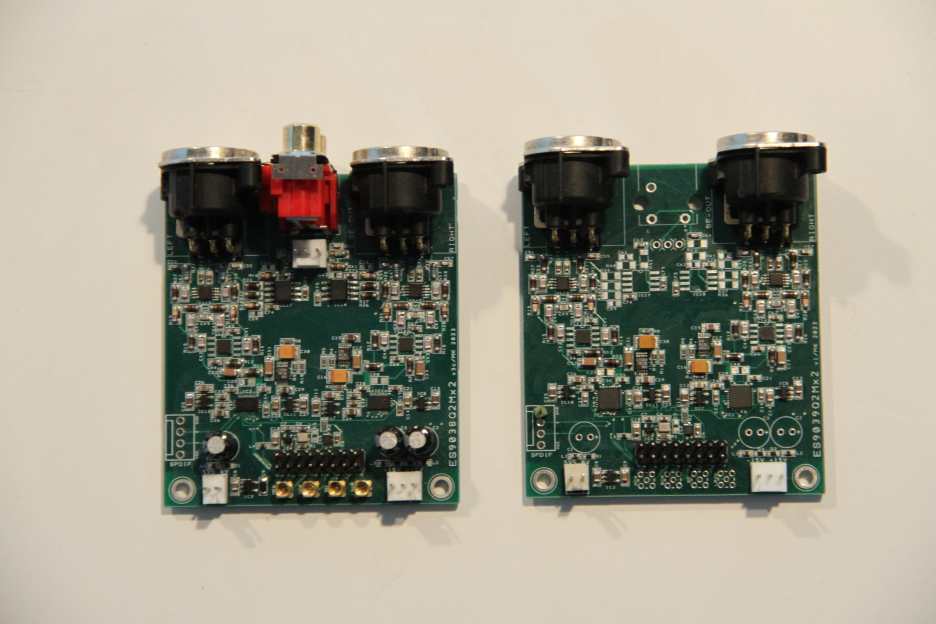

I already posted a measurement of my ES9039Q2M board in that thread. Other than that I have no reason to pollute this thread with ES9039Q2M stuff.
Here is a picture of the board next to my earlier ES9038Q2M board. To make it apples to apples comparison I made the ES9039Q2M board more or less identical. However I discovered that simple dual mono scheme by paralleling dac chips as in ES9038Q2M does not work with ES9039Q2M so I have used only 1 channel from each chip. That is why I'll later replace the board with single chip version.

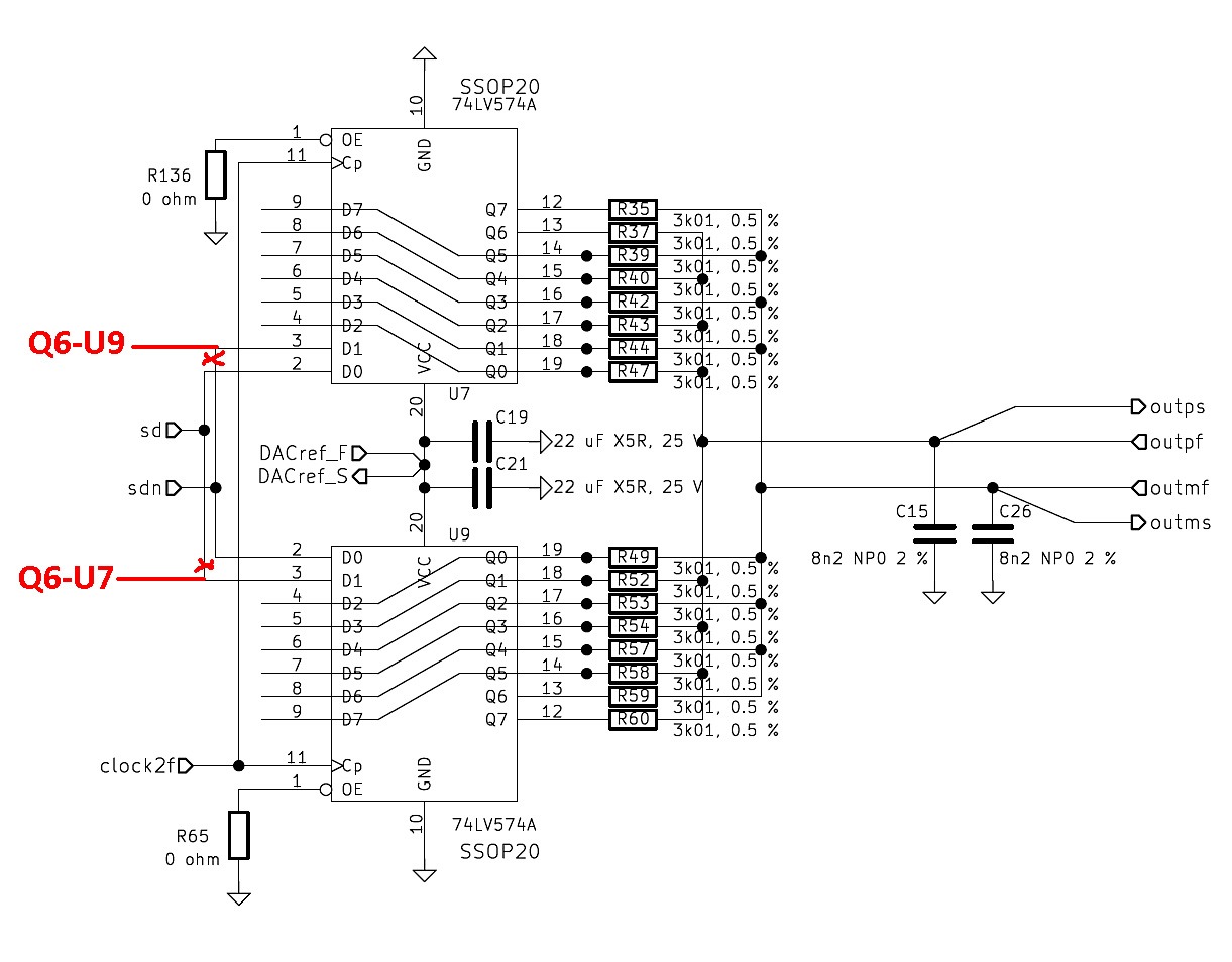

Hi Mark,
Its your obvious decision to proceed with your current setup, driving the shift registers with an external clock.
As a next step you have planned to change the resistors.
But before doing that, you could still try a very simple change, by changing the 4x4 shiftregisters into 2x8.
That takes only 2 wires, output from one shiftregister as input to the other.
An idea worth testing ?
I am impressed by your creations, thank you. Yes, these are some of details that are useful. Can you also post side-by-side comparison of the plots of this chip dac DSD vs RTZ under similar conditions? Of course your listening impressions posted earlier are noted🙂

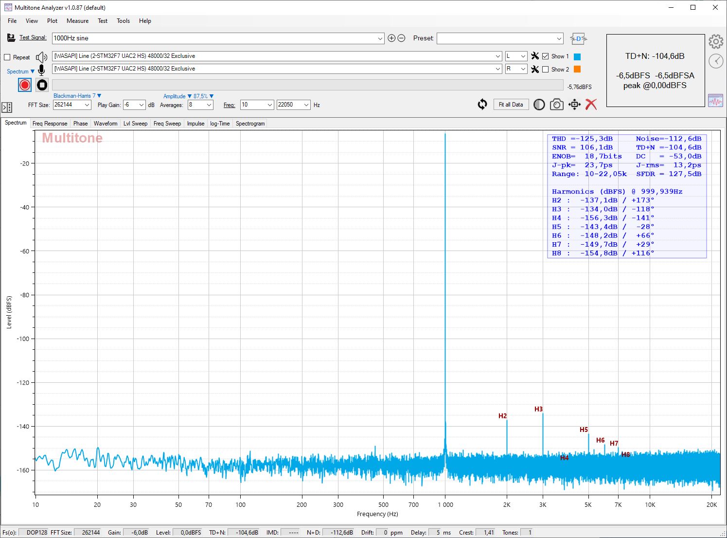

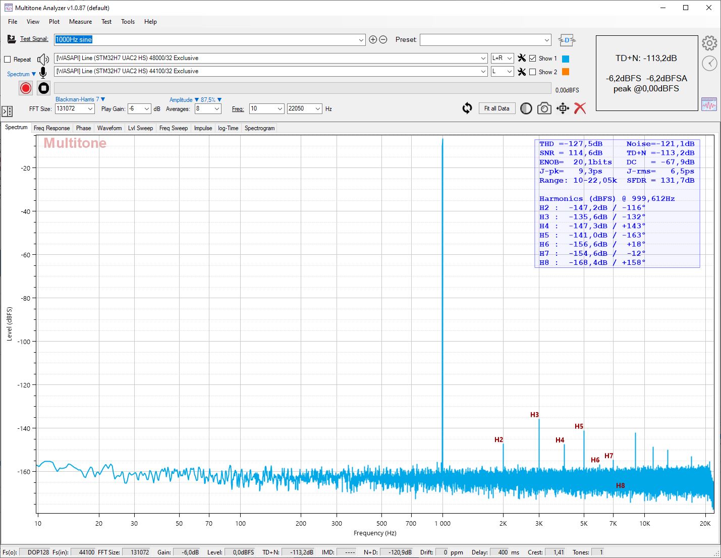

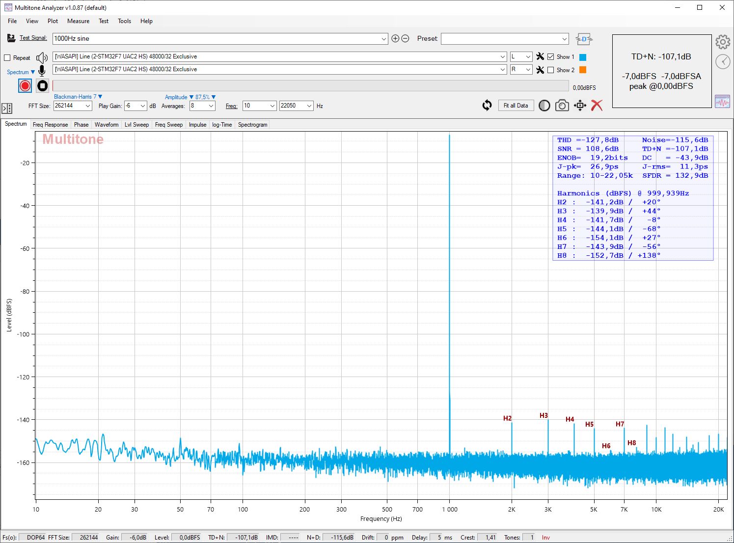

Here are plots that I have posted earlier on ES9038Q2M, ES9039Q2M and RTZ with DSD input but unfortunately conditions are not exactly the same (RTZ with DoP64 and ES9822PRO as ADC, ES903xQ2M with DoP128 and AK5394). As I said in my posting on another thread ES9039Q2M has lowest noise but some high order crap.
One important thing to note is that both ESS dacs need THD compensation to reach low THD. RTZ reaches lower THD without any such gimmicks. While ESS THD compensation is nice for the "numbers game" it unfortunately is fs, frequency and level dependent. Although slightly less so with ES9039Q2M.

Regarding the above plots I noticed that the first one (ES9038Q2M) is somewhat fishy as the noise is too high. Here is a fresh measurement that shows similar noise as ES9039Q2M.
BTW all these measurements were made with direct DAC-to-ADC loopback without a notch which makes them less reliable. I will redo these with a notch later.

Hi Hans,
You raise an interesting point. Just to see if I understand, let's see if I can describe it in my own words:
Since I am mostly using the dac in SE mode with a passive output filter, why not rearrange the shift registers to make two SE channels, each with more FIRDAC taps? Such a change can be done by wiring the data through pairs of shift registers sequentially and then paralleling the analog outputs of the shift registers that are in series?
On the topic of my preferred plans, I would like to fully modify the dac before unmodifying it. In fact I will probably end up suggesting to Acko that some of the changes be left intact. The main thing that will need reversing is to restore the original RTZ function. Simple matter of replacing 6 resistors which for now are saved in a little plastic bag.
Mark

Hi Mark,
This is what I meant
Hans
