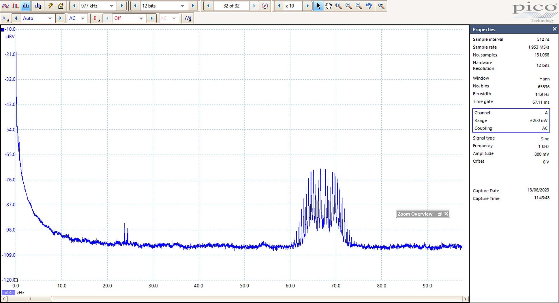

The FFT image below show the effect of extreme jitter of a SMPS supply
To do the same with the BCLK to show jitter in the low psec range, would need a huge FFT sampling in the GS/s range.
My scope goes in FFT mode just to 100Mhz with 0.25GS/s with 16.384 samples, giving a filter bin width of 6.104 Khz, completely inadequate for the job.
Hans
