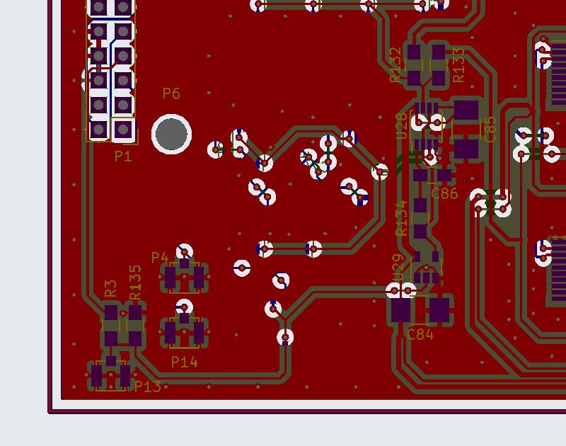

It would be nice if the three connectors could be aligned towards the board edge, maybe between P1 and R3, though I guess that may have consequences for theinner PCB layers?Could those of you who have experience with U.FL connectors tell me if this placement is acceptable?
For better or worse, u.fl is what I see other's use for this application. Iancanada uses u.fl
I bought maybe 100 little u.fl cables from ebay, so when I take my stack apart, I throw the cable away and use a new one every time so I don't worry about the connector.
You should also try and be as square as possible when you connect or disconnect, but its hard to do.

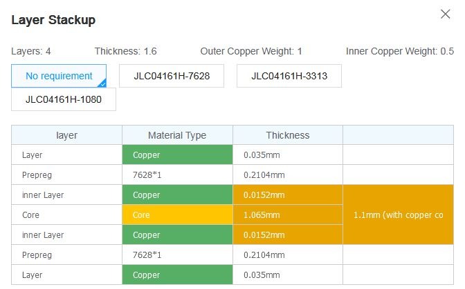

Yes, that's correct.Marcel, can I confirm this is the layer stack you've used?
It looks like it will fit when I shift a couple of resistors out of the way.

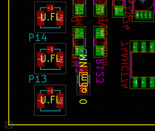

Alternative U.FL connector placement:
The upper one is P4, so the order is left DSD data, right DSD data, bit clock.

I believe it is 3.5mil Marcel - check out the PCB specs on the link I PM'ed you last Friday.@nautibuoy What is the minimum outer layer track width without increasing costs?
I did, and I read what their capabilities are, but not if those add extra costs. For example, at Eurocircuits, line widths down to 0.09 mm are allowed, but anything narrower than 0.15 mm will cost you extra money.
At the moment the minimum track width is 0.25 mm, but there are a couple of short tracks I would like to change into 0.15 mm. Hence the question.
I read the 3.5mil as an absolute minimum (and essentially the same as the Eurocircuits 0.09mm limit), but I couldn't see any reference to additional costs below a certain track thickness so I think the only way to find out will be to load up the finalised gerber files and get a price. I don't imagine any extra cost will dramatically change the overall pricing, but we'll see.I did, and I read what their capabilities are, but not if those add extra costs. For example, at Eurocircuits, line widths down to 0.09 mm are allowed, but anything narrower than 0.15 mm will cost you extra money.
