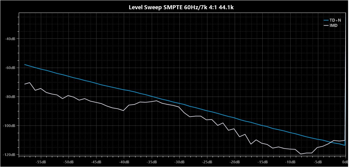

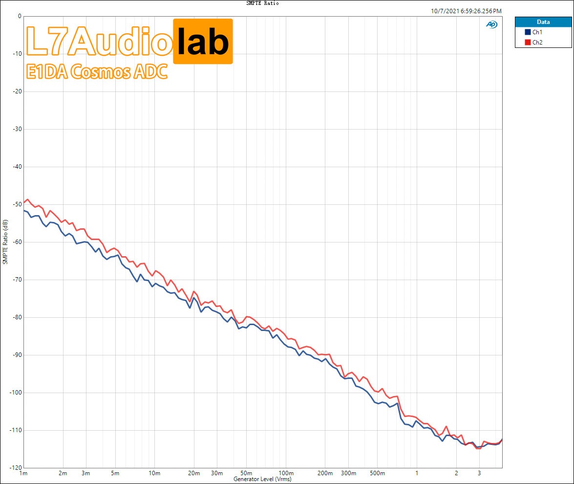

Most are aware of the ESS IMD hump of ES90x8 dacs. Unfortunately the same hump is also present in ES9822PRO adc. So something to do with ESS dac/adc architecture.

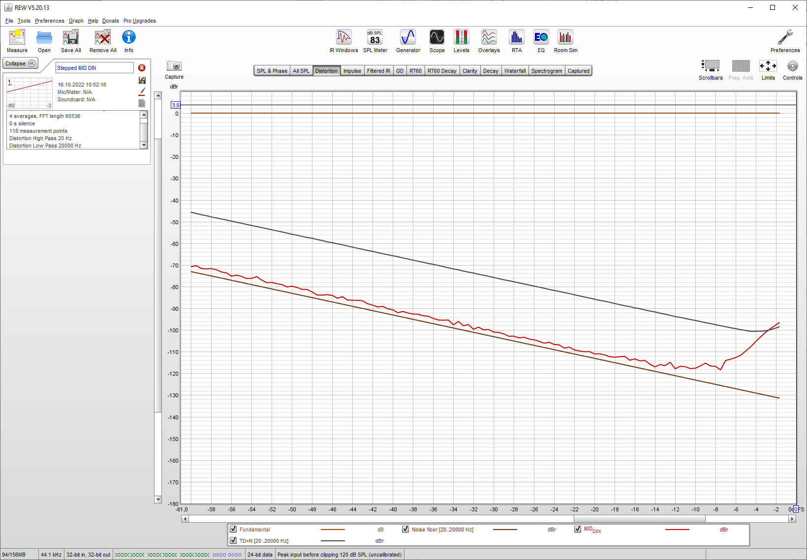

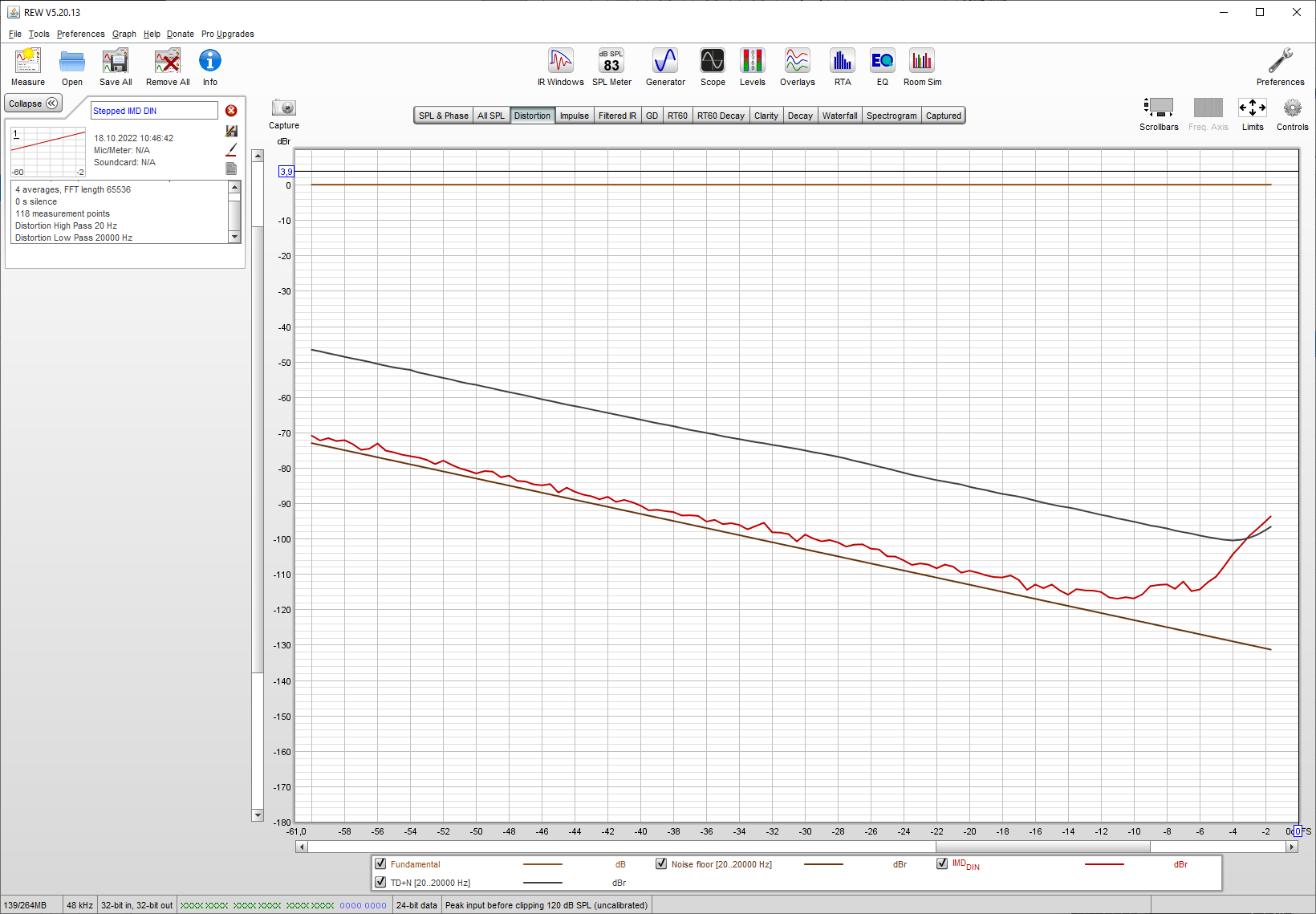

Here are 2 IMD vs. Level measurements of the same dac (AK4493SEQ) using ES9822PRO and AK5394. Should not be too difficult to guess which is ES9822PRO 🙂

Do you know if the rising distortion at the high levels is caused by the AK4493 or the ES9822PRO?

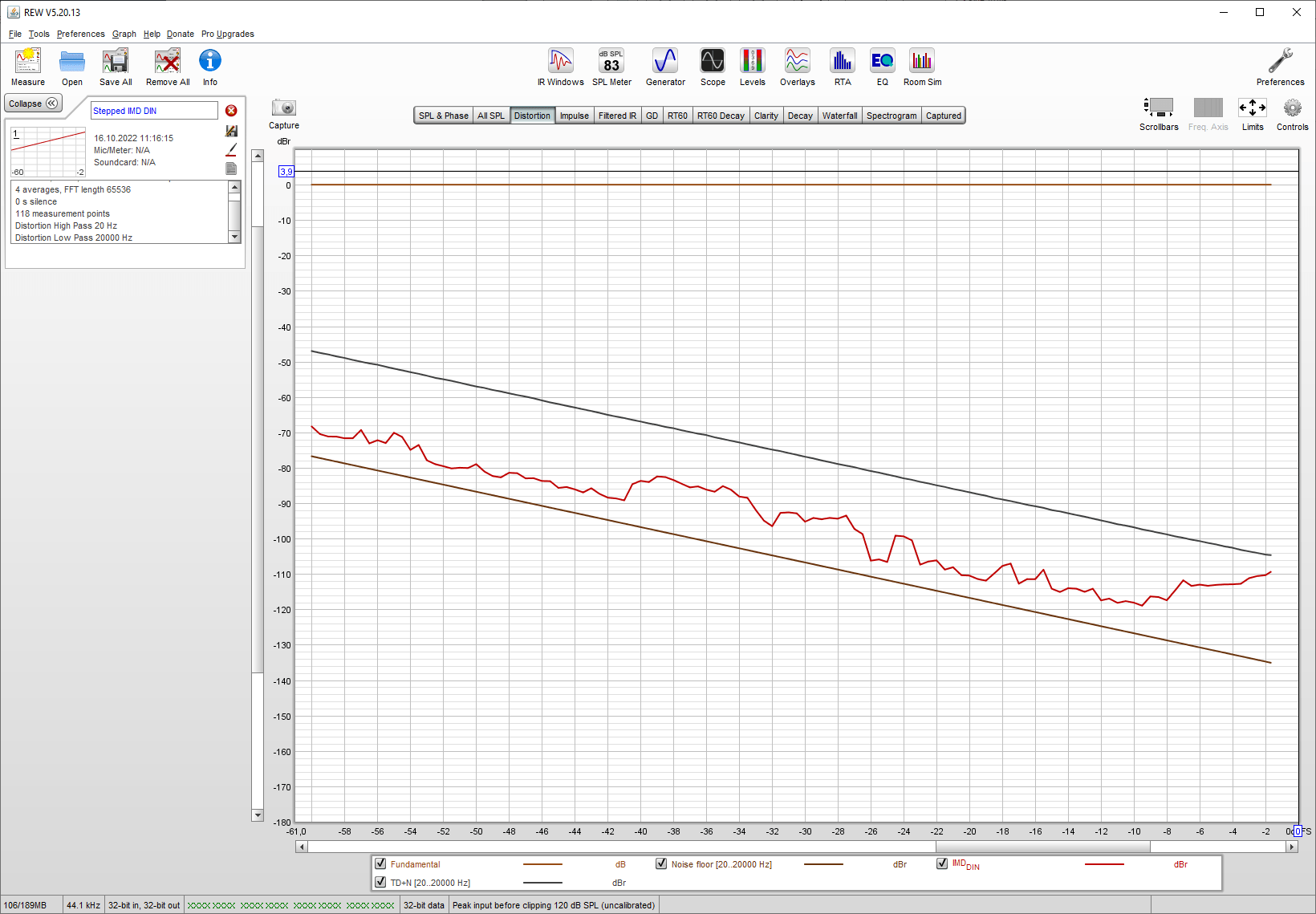

I'm not sure there is a real cure for this with ESS DACs other than hiding the hump by raising the noise floor (e.g. with lower MCK).
Rising distortion at high levels is probably due to both AK4493 and ES9822PRO (and AK5393 in the other graph). Although with ES9038Q2M the high level distortion rise is a bit smaller.
I'm tempted to think all ESS products, DAC's and ADC's, use the conceptually same delta-sigma modulator scheme and thus have that specific modulation artifacts that accumulate in a visible hump when the noise floor is low enough. Newer products will fare a bit better but it still is always there.Most are aware of the ESS IMD hump of ES90x8 dacs. Unfortunately the same hump is also present in ES9822PRO adc. So something to do with ESS dac/adc architecture.
Looking at the single tone distortion residual with massive time-domain averaging will expose the characteristic ripple in the transfer function quite well, but high resolution FFT spectra of single tones vs level (and vs DC offset) will also show the modulation patterns right away without time-domain averaging.
With the multichannel DACs there might be a way to reduce the patterns to insignificance by summing the channels, fed with just the right set of digital DC offset levels so that the modulation artifacts average out (or might even fully cancel for most of the signal range). If I had an Okto or Topping DM7 I could put that hypothesis to test but I don't own one.
For the ADC, I cannot think of any feasible solution, though.
I would think the ESS ADC is not a good choice to do detailed measurement of ESS DACs wrt their "humpiness".

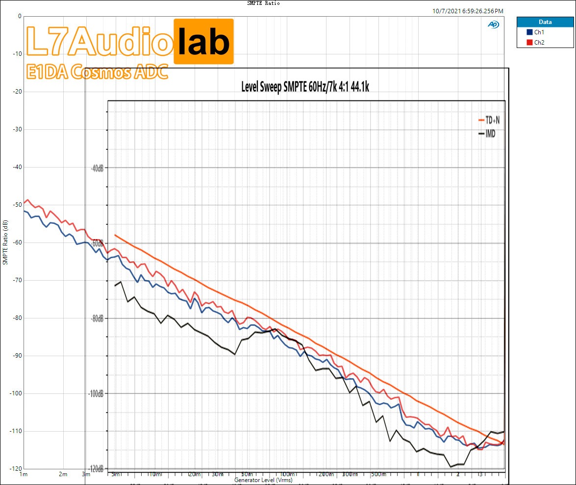

BTW the ES9822PRO hump in Cosmos ADC was already discussed on ASR last year: https://www.audiosciencereview.com/forum/index.php?threads/e1da-cosmos-adc.27038/post-1025410
