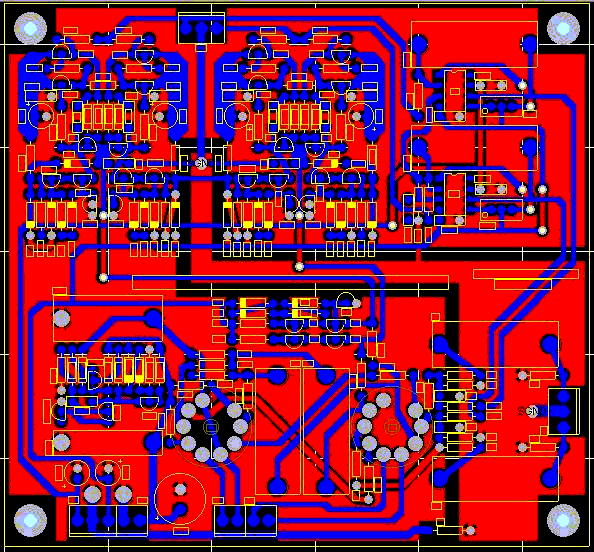

Build in dead bug form, PCB underway.....
G.Kleinschmidt said:Oh, and here it is again in my no holds barred "open loop" line stage 😀 😀 😀

PMA said:OK, eagle sch is finished...
Well I've finished mine. Mr Wurcer seems to have taken a holiday from his discrete thingie.......
