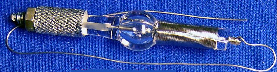

Now all i need to do is get a really bright metal halide lamp and reflector, point it at the colour wheel and i should have an XGA DLP projector for about £100! Not only only is it loads smaller than my original but it should have way better contrast and brightness, and should only take a day or so to make! :lol:
