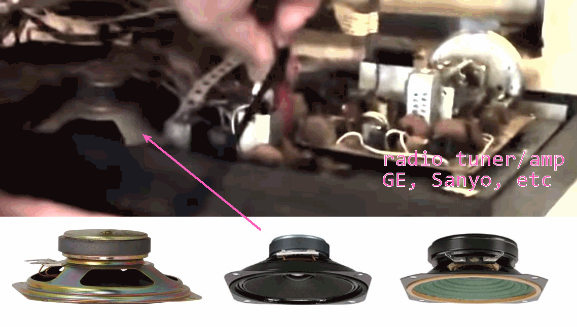

It "IS" a radio, slightly customized. NuTone faceplate of course. Input/output taps for remote speakers and sources, a "microphone preamp" so a remote speaker can be talked into. I would bet NuTone solicited bids from the major good radio builders (NuTone could have built the electronics but other factories would be better/cheaper by adapting existing products to NuTone's need).
"Driver" is a fancy name for a loudspeaker. That dim jerky video gives a glimpse. A 4", 5" or 6". I've handled many dozen of these things. That one looks a bit better than the battery Sanyo in my barn, a little less than the nice Sony in my garage-- not bottom-barrel but nothing special. Since the buyer never saw it, the magnet was not as large as usually seen on "raw" drivers.

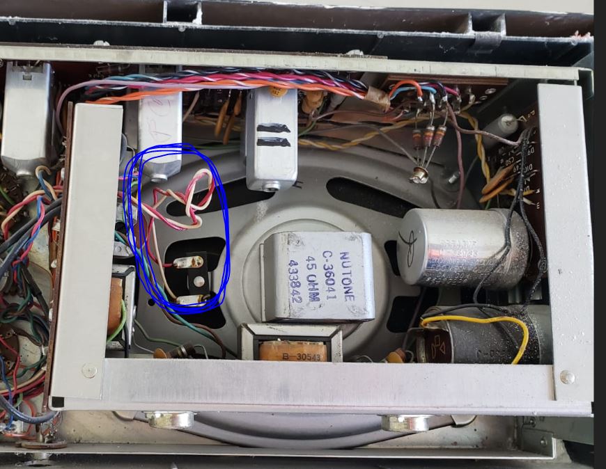

So I found out the unit uses a 6" X 9" 45 ohm shallow diaphragm speaker cone. Having a hard time finding drivers of the same size, I think i might just keep the original one for now and scrap the idea to keep the buttons functional.
I am deciding to get a used google home mini, and cut the output lines into the speaker of the Nutone (similar to this, https://www.instructables.com/id/Google-Home-Mod-Into-a-Vintage-Radio/, but for now I will use the original speaker. If that works well I may stop there, but if you have any suggestions for loudspeakers that could be a good replacement that would be helpful.

Thing is I have no value for the intercom system as a whole other units in the house have been removed by previous owners. I like the aesthetic of this unit, but would prefer something more functional.I am planning to cut the speaker as an output for a google home. I may keep the current internal components in tact for the ability to revert my modification. But not sure just yet.
6x9 is common in car radio rear decks. You can get very good "3-way" 6x9s. But all 4 Ohm. The 45 ohm eases using the speaker as a microphone. If all the other stations have been scrapped, no matter. However a "line transformer" 10 Watt 25V would come close to 45 Ohms.
But personally, I'd put Velcro on the faceplace and keep my whiskey in there.
If i were to swap to an 8 ohm full range driver, would I have any issues with the original wiring for the 45 ohm speaker? And in reverse, would a google home mini which has a 4 ohm speaker have a problem if wired to the 45 ohm speaker of the intercom?
I have been doing more research came with the an idea to retain the original device function. I am thinking using a 4PDT switch, wire the original radio/intercom and a google home mini to the 1 output speaker (maybe 2 speakers, but not sure if this will then also require an amplifier or some other things). In the image attached, thinking to just cut that line and add in the switch there and wire in the google output into the switch as well. There is a hole at the bottom of the intercom, and thinking to stick the switch out from there to have the flexibility to swap output. I will test using the current speaker I think but not sure if there is something I am missing here, and on the fence for changing the speaker as well.

Can you clarify which part is it's a bad idea and why? From what I understood it is acceptable to connect speakers of higher ohm load to an amplifier. So in the case of the googles 4 ohm default should be fine when hooking up to the intercom 45 ohm speaker right?
I can understand there potentially being an issue in lets say swapping the intercoms 45 ohm speaker to an 8 ohm as it is lower. In that scenario would it be possible to wire in an amplifier or some device to match them together?
