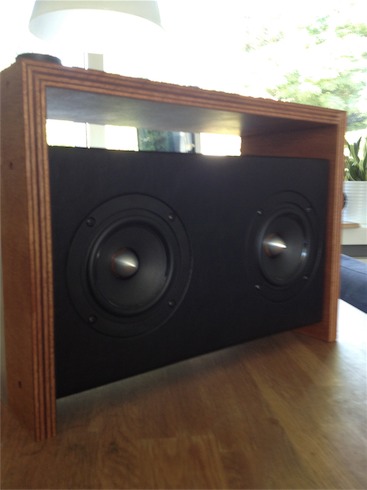

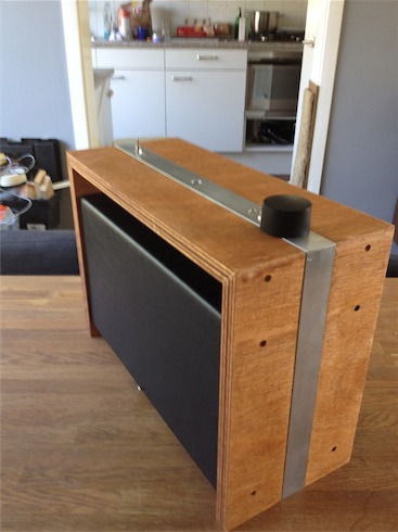

i have just finished my boom(ish) box it is build with
TA2020
Li-ion battery
Charger
Tang Band W4-655
Marmitek bluetooth module
it is a bit bigger than i first planned but it sounds beautiful

The dimensions for the actual speaker and amp are w, 35cm h, 20 cm, d, 15cm with the wood and controls the dimensions are w, 38,6 h, 27cm d, 16,5cm. The speakers are actually the ct-218 times two and a small place for the amp etc. in between. Because I can't calculate speakers I went for a kit with good reviews and that ment that the dimensions were more or less set. The complete amp costs (with trail and error) €220.
