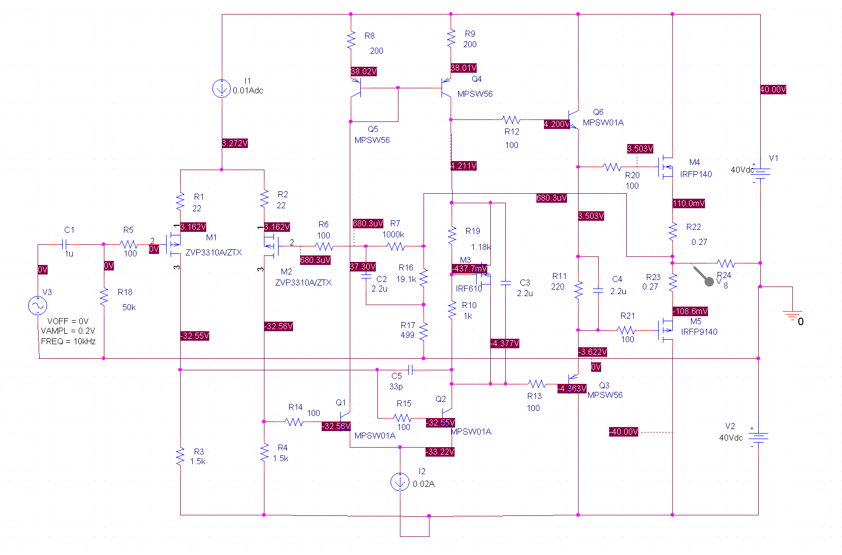

I've been tearing up the layout to add extra power devices, so the board will have a theoretical 100W capability. Somehow I don't really trust the double-die Exicon devices, and would prefer a design where I can apply a gate stopper to each device.
I don’t know about whether to trust the double-die devices or not, but I’m happy with your decision, because I have a small batch of K135/J50 pairs idling for a new design.
I have a small stash of the old Hitachi TO-3 devices, a couple of tubes of the Semelab BUZ TO-3s, and a small number of the Hitachi/Renesas TO-3P devices. I actually got the P-channel TO-3Ps from Electronic Goldmine a few years ago - I'll have to test them to see if the source pin is in the center like it should be. For that matter, I'll also need to retool the layout as well to make it so. It might make life a little easier for me.
Possibility of separating supply of the output laterals would probably be desired. As it is the design can output 28-30 Vp, while the laterals would dissipate ~70-84W more than needed at peaks.
Right now, I'm separating the supplies for the driver stage and the output stage to make a boost supply possible.
