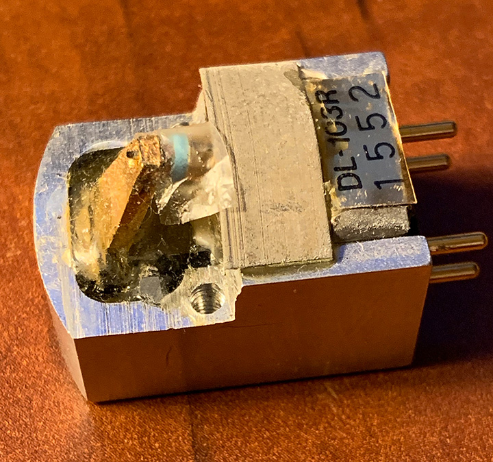

Here are two photos to show you two of my most successful cartridge bodies. One is modified aluminum one(I cut the front part to leave the coil area exposed and the other is DIY Africa black wood.

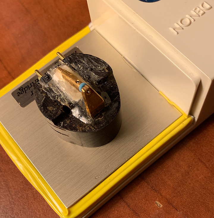

From the picture of your diy African black wood, it seems like all the wiring is covered with epoxy? When you say «leave the wires loose enough», do you move the wires? Sounds risky to me.
Did you use the lead-pieces to center the cartridge in the body? Your alu-body looks the same as mine.
Thanks for the detailed instruction The cartridge is almost new, and I don’t plan to retip before the tip wears out.
Re-tipping is definitively an improvement over the stock cantilever. As I said before, you may like the sound after potting. In that case, I don't see the need to re-tip especially if you listen to rock and jazz. All my re-tippings were done by Sound Smith. I won't recommend ruby cantilever, but I highly recommend boron cantilever.
All wires are loose. There are about 4 mm long from the coil to epoxy. I potted my cartridge in two processing. This why the flexible suspension filament area is covered with epoxy, too.

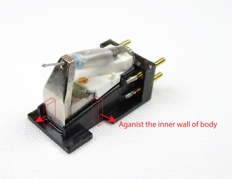

I don't use the lead pieces to center the cartridge. The naked cartridge should fit the body without extra space around the cartridge. Please see the photo.

Success, I think! I removed the plastic in front and both sides of the front part, and potted with epoxy, and also added 5 lead shots. The weigth ended up at about 15g. The difference is easy to hear, a fuller sound, and deeper bass. So far I have only played two records.
