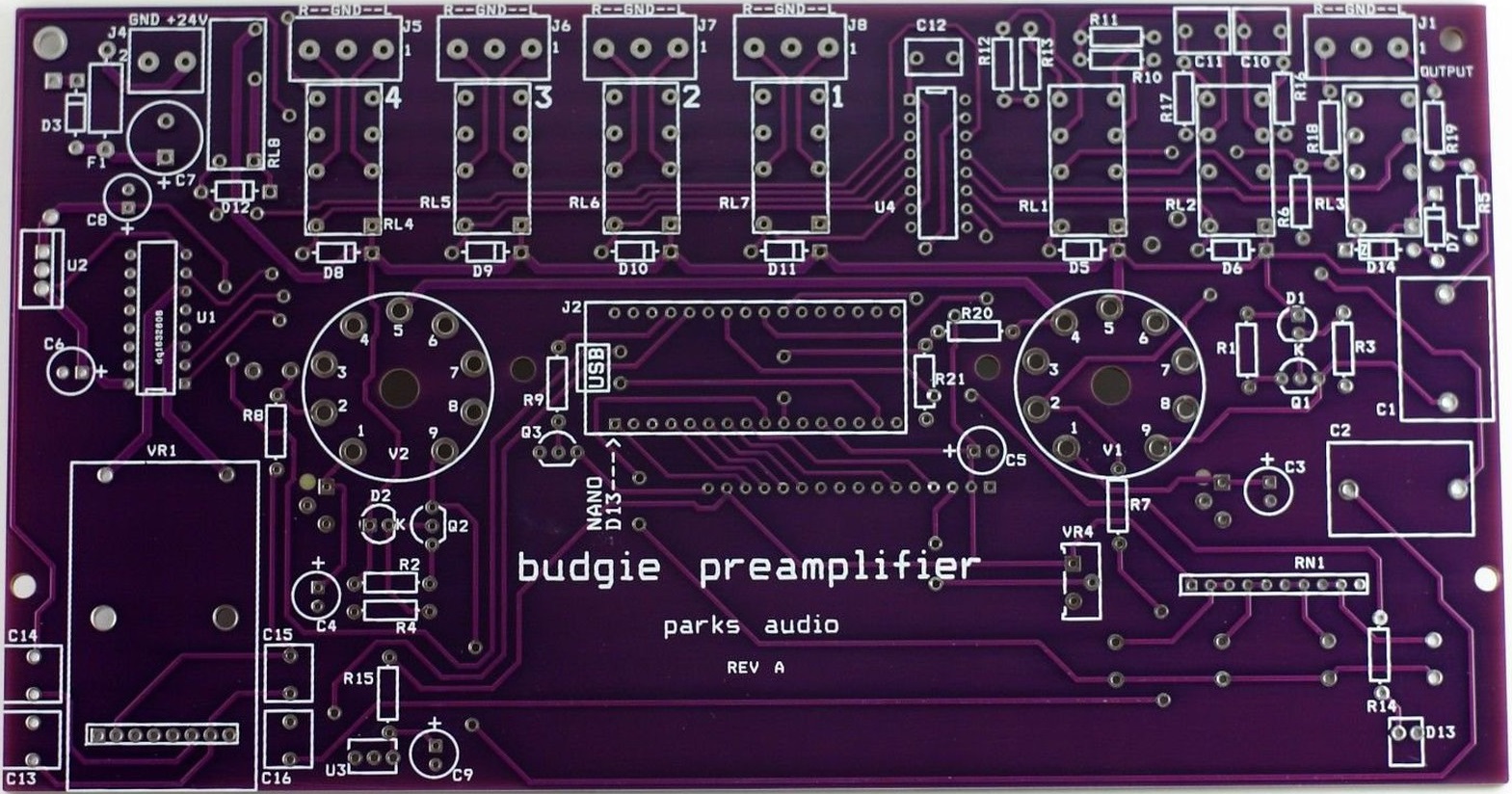

Hello,
I created the board using a special software based on the schematics and PCB photos that were published !
Shannon Park (diytube.com) Unfortunately, his website and forum have been taken offline,
but I saved everything I need (firmware for the Arduino Nano, for example).
To protect the tubes and fingers, these things are available at aliexpress:hot:

the top of the original pcb served as a template and that was still relatively easy,
the back was more difficult because there is no decent photo of it
and the back also serves as a ground plane,
so you have to look at the circuit diagram again for each component!
Bravo! The designer is a nice chap but when I tried to get hold of the PCBs that was not possible anymore. There was no way of getting the gerbers or a board so the project was more or less killed. It is quite strange that the use of Arduino in good audio circuits is/was not more popular.
While you are at it you can modify some things. If you are interested here are some suggestions and sharp opinions that may be taken with a grain of salt:
- The bass boost and 0/6dB gain relays can be omitted as bass boost does not belong in serious audio and gain is not needed in 99% of cases in this day and age. If gain is needed then one will not switch it with a relay now and then 🙂
- PSU B+ is quite low and could be upped to 48V and included on the board. Only the transformer being a separate part. When SMPS can be avoided many will do so. A separate linear 48V PSU board is also an option. Relays should be the 48V versions then. Challenge is where/how to create the 5V.
- When a linear PSU would be added both the 24V DC for the heaters and a voltage doubler for around 40V B+ are possible with a 20 ... 22V transformer.
- When a multiple secondary windings transformer with the "right" voltages is used things become more easy. Then 100V B+ is an option.
- it can be rewarding to include pads for other types of motorized potentiometers/volume control.
