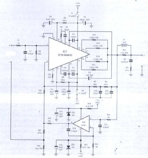

I just modified a LM3875 local amp kit using standard components with mostly-based-on-carlos's snubberized PS (Mk II).
Then, I dig out my old 150W amp that sittting idle for many years. It's a kit of STK4048XI with DC servo (attached) using metal film res, Wima and Elna cap. Standard PS (10,000 + 470 + 0.1 per rail).
=STK4048XI vs LM3875 25W=
With my system ( 90 dB speaker and small room), the snuberized 25W LM3875 significantly give cleaner, more details and more muscial for pop, acoustic, classical, vocal & light music and R&B. I also most enjoy listen some Jazz music with the LM3875. However, STK4048XI give more (& deeper) bass on rock & dance music.
