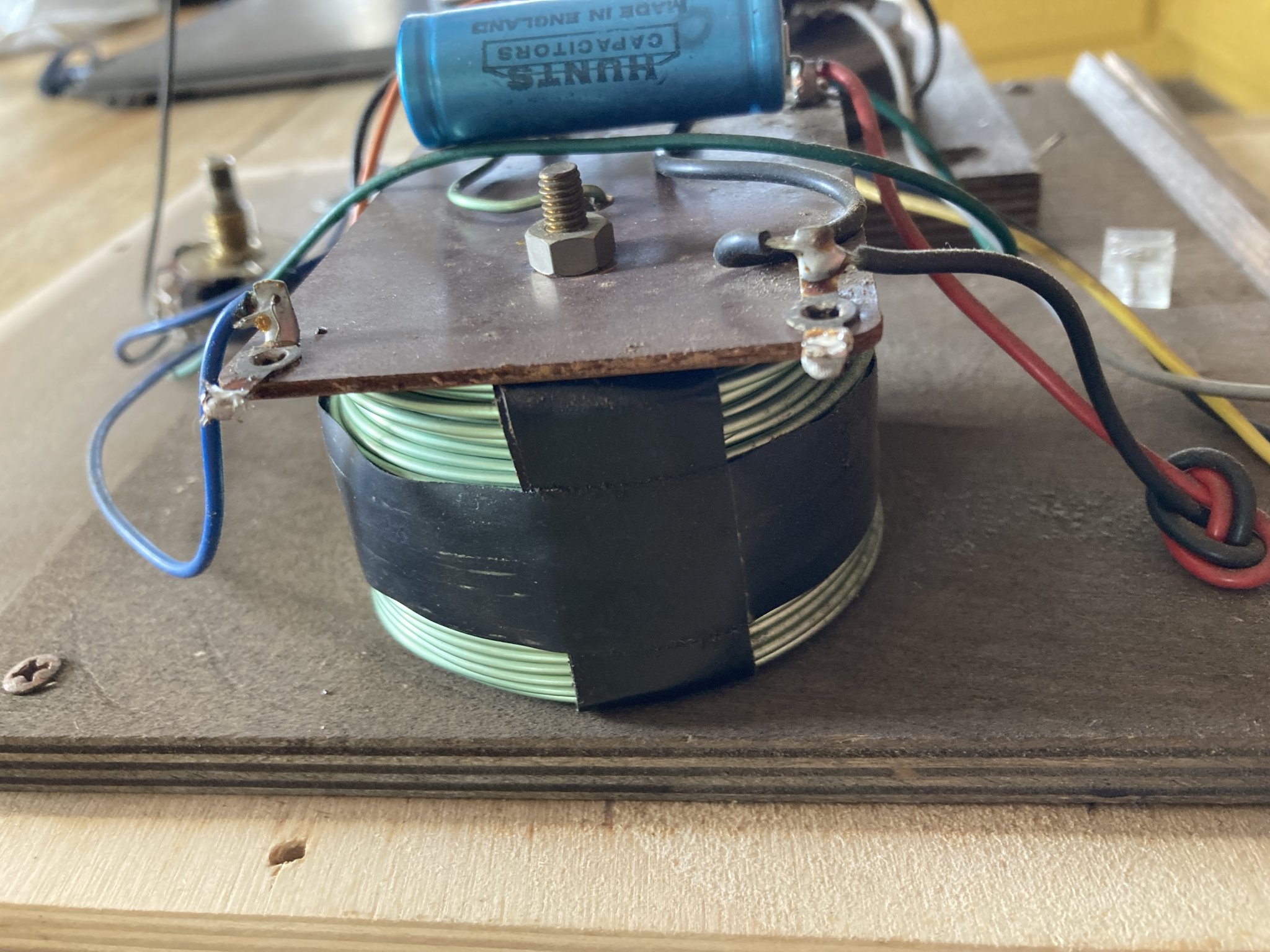

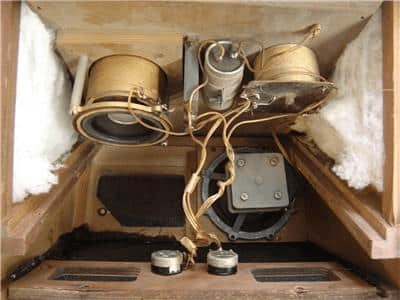

Normally it's a lower risk assumption to keep them [inductors] as is.
You may have observed that the 2.5 mH inductors in the W3 are wound with thick aluminium wire.
I presume Wharfedale would have been focused on keeping costs down.
It would be advisable to avoid disturbing the attachment points at each end of the coil because I assume they will have been specially terminated.
Any comments on the use of aluminium wound inductors AllenB? Copper replacements would be quite costly.

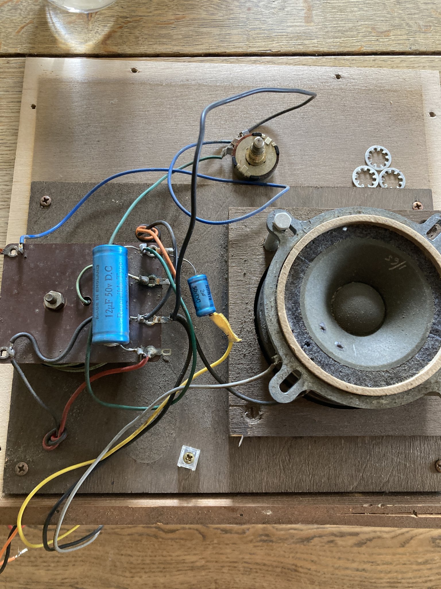

Here are a couple of pictures of the crossover in the W3's I have. As Galu commented the coils are aluminium. I'm about to refelt the tweeter and mid driver and would welcome any advice on how best to do this. I've never stripped a driver down and I'm anxious about making errors that might cause damage. Any advice about the sequence I need to follow would be very very welcome.
I'd caution against replacing the felt surrounds unless absolutely necessary.
Some local patching up of holes may suffice. The last thing you want to do is risk damaging the paper cones.
I believe the felt surround doesn't contribute much in the way of support for the cone - most of that is provided by the rear suspension.
The way the 5" and 3" drivers fire into free air, as shown in the image below, reinforces my opinion that the felt surrounds need not be perfect.
You certainly wouldn't strip the driver down in the sense of taking it to bits.

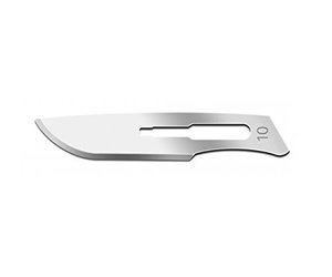

You may require the help of a rounded No.10 scalpel blade (pictured below) to separate the felt from the rear circumference of the paper cone, being extremely careful not to damage the cone in the process. Separating the felt from the speaker basket would be less problematical.

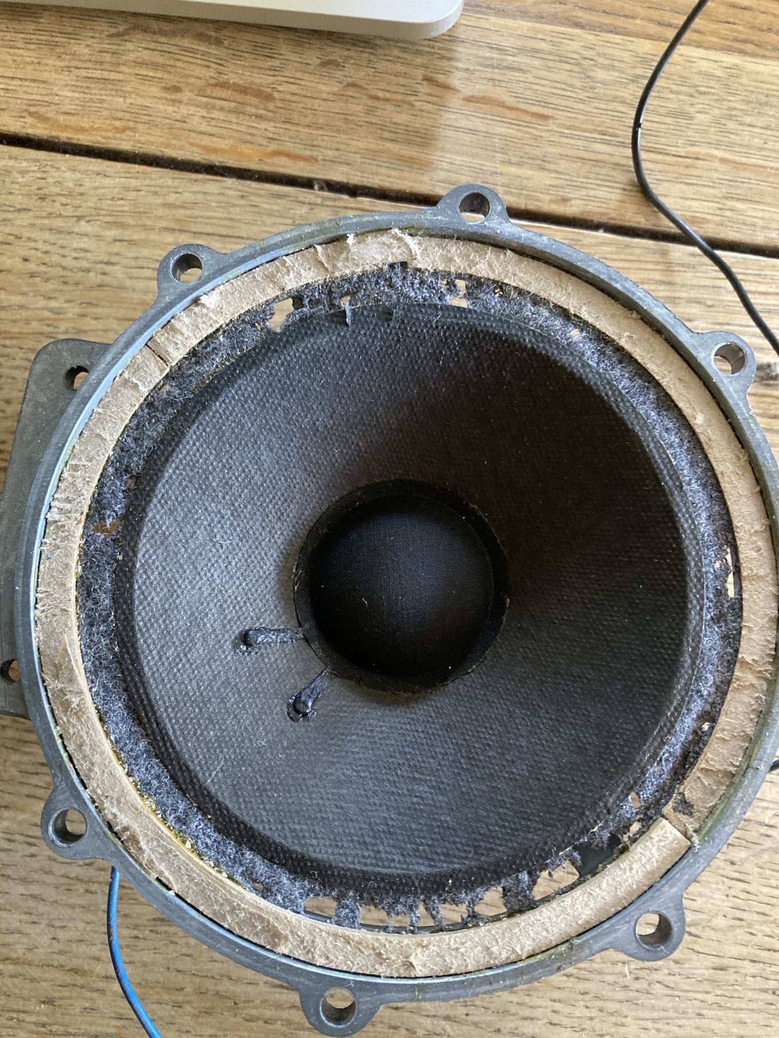

Thanks Galu, as you can hopefully see from the picture the felt is shot on the 5"'s. If I understand you correctly you are advocating cutting away the old felt with a scaple andglueing new felt in it's place. Do you suggest I do this with the cone in place? I think I can comfortably trim the old felt off, howver getting it off the paper cone may prove difficult. I might just trim the felt around the cone and then glue the new felt onto the remaining old felt which is attached to the cone. What do you think? Ideally, I'd like to clamp the new felt while the glue sets and aim to fashion some a jig out of 6mm ply.
Absolutely!
On no account try to remove the cone!!
I was suggesting using the scalpel to separate the felt from the cone, but you could just trim the felt off round the edge of the cone as you suggest.
If you use the tacky PVA glue I recommended it will grip the felt and paper cone fairly quickly and you may require nothing more sophisticated than maintaining light pressure around the circumference for a while with your fingers.
A jig may prove handy for the felt to speaker basket interface. I just use modelling clamps.

Another thought!
At present, the felt is stuck to the rear of the cone's circumference.
You could equally stick it to the front of the cone giving you a fresh felt/paper interface and allowing you to apply light pressure while the glue sets.

Your main concern would be attaching the cone off centre or in a deformed state.trim the old felt
Just a quick thought, is there any advantage to removing the old felt support? Would simply gluing the new felt over the old felt work?
Maybe, it's hard to say whether it's worth worrying about. The differences might include the effect on natural cone flexure changing breakup, as well as whether it imbalances each side. Then the concern of asymmetrical cone balance leading to rocking modes. You also have the simple mass differences which would alter the main resonance.
