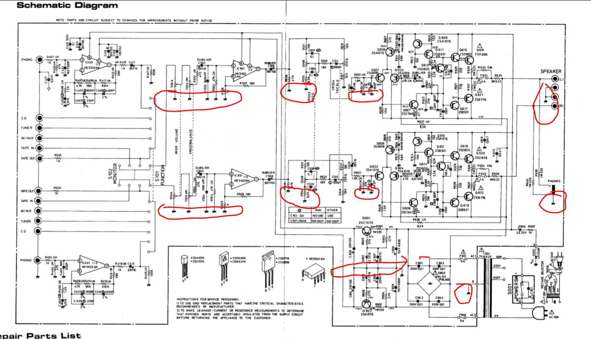

Actually do you have any suggestions on how to mute the speakers with phones in?
I'm just looking at the RA810 diagram now. That's nuts in it not having a switched output.

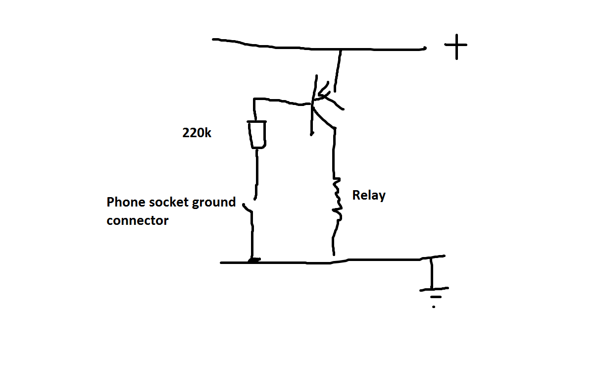

Just thinking aloud... so a normal headphone socket of the kind you get anywhere has 6 terminals with the audio and ground feeding into one side, and with nothing plugged in they carry across to the other side. Insert the plug and the 'other side' contacts are isolated.
So you could have say a PNP darlington driving a relay and with the base tied through the ground pin on the socket via say a 220k. Insert the phones and the ground is lifted and the PNP device turns off isolating the relay. Remove the phones and the transistor is on pulling the relay in.
Two components at a basic level plus a relay. Transistor could be bolted to the chassis.
220k is probably a bit optimistic, something nearer 22k to give a couple of milliamps base current.

You need something that can withstand the supply voltage of one rail (so at least 60 volt for a good margin). The resistor needs to be low enough to fully turn on the transistor so that there is no power loss. The relay needs to have (ideally) a 24 volt coil (higher voltage the better). You would add a series resistor to get the coil voltage correct. A diode (1n4004 type) across the coil to absorb back emf and that's it. Purists would add a further resistor (say 47k) across B and E of the transistor to ensure the base isn't floating such as would happen when 'phones were plugged in.

In your doodle you drew a normally open contact. The switched jacks available are mostly normally closed.
Also, I believe the ground plane in this amp is -37V, do I just treat this like a conventional ground?
EDIT: I reread what you posted, so the switch is indeed normally closed and the phone jack opens the contact. Got it. Working on this now. So the relay is energised when the speakers are on. That is, headphones out. Still need an answer on that negative ground.

Anyway, Neutrik have a big range of switching options, so i could even make it so the coil energises when the headphone are in. They have a jack where the sleeve contact makes on insertion.
If i did the above, so that the coil is energised when the phones are in, will that mess around with the ground of the headphones being connected to the resistor and transistor? Or should I go with the original plan so the coil is energised when the phones are out?

That basically correct. We would just use one rail for this, the plus 37 volt one and the main audio ground. Nothing connects to the -37 volt rail.
You only have a 20 minute or so window to edit posts.
Ohhhh, so there's an actual 0V ground. I suppose I should buzz out the circuit and find it. Well I think I have enough information for now. I'm going to research those smaller film caps and see if I want to pony up the money for them. I might even have a 24V relay here so i can start fiddling around with that while the rest of my parts arrive.
EDIT: The most cost effective film caps are polyester. Polyprop are so prohibitively expensive. Will I get away with Polyester, or should I just stick to the electrolytics?
Definitely a ground 🙂 It is the speaker negative, which connects to the junction of the two main reservoir caps in the power supply. You would use the existing headphone ground point as that should ensure the best ground point to avoid hum and noise.

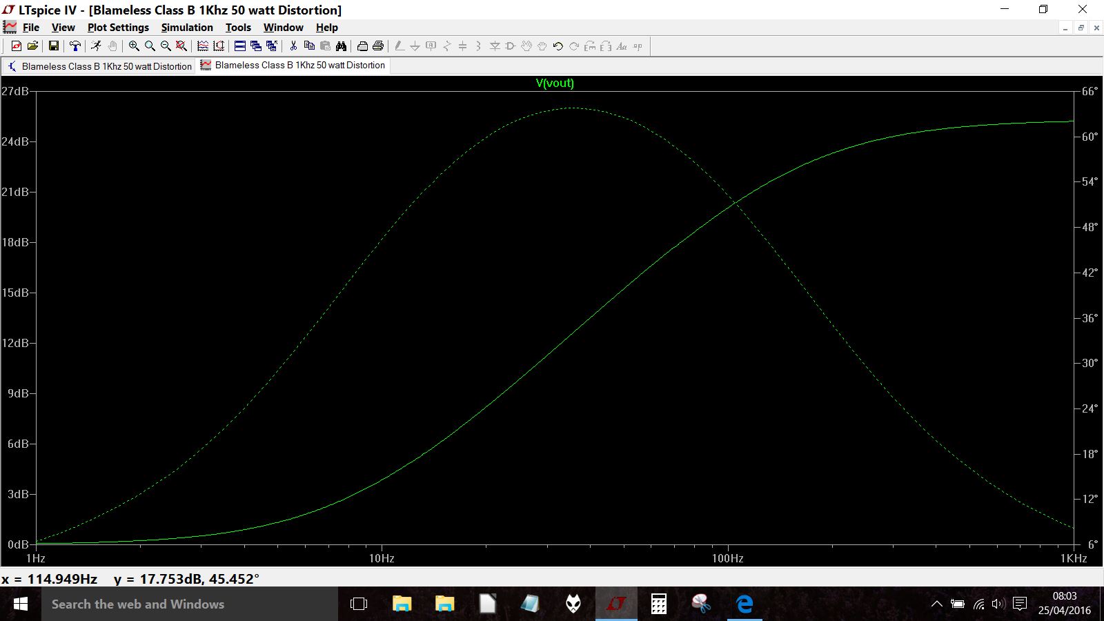

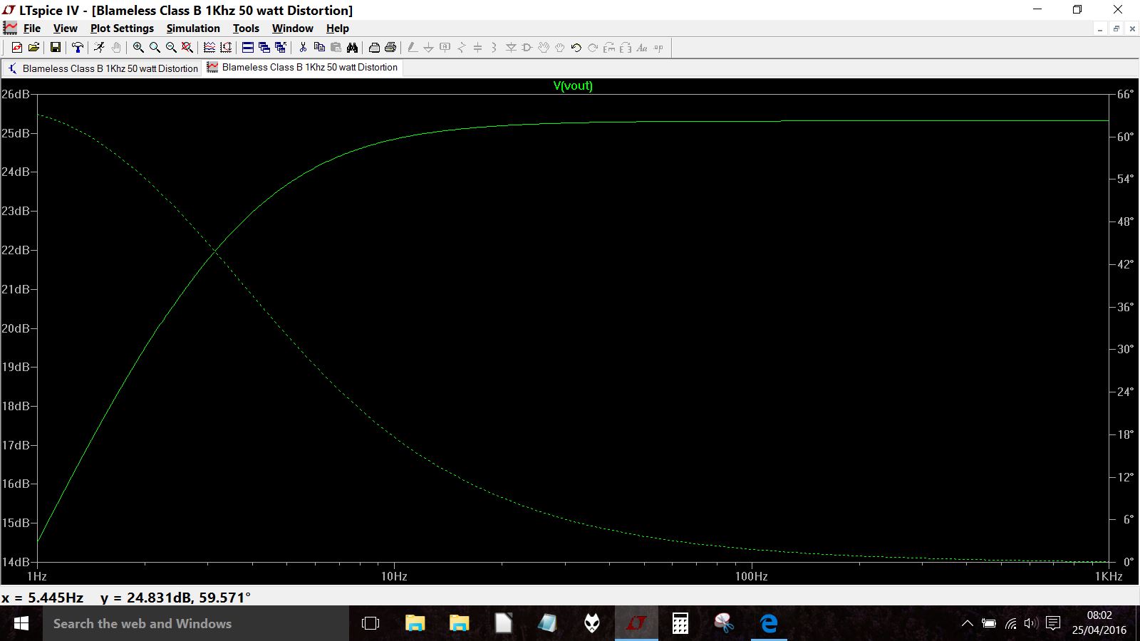

I personally wouldn't change the couplings caps to a lower value. Its not just the response below a certain point that is affect, it also affect the response above the nominal roll off point as well. C505 is 100uf because the opamp has to drive the variable impedance of the tone network. C605 is also 100uf.
There is nothing wrong with electrolytics used (correctly) as coupling caps.
This shows the effect on response (on an amp with your feedback network values plugged in) of going from 100 uf to 2.2uf for just C605. This shows response from 1Hz to 1kHz.

So I'm working on this headphone switching circuit and I managed to find a BD682G PNP in my parts bin. I'm having trouble calculating the base resistor.
If the supply voltage is 37V, maximum emitter-base voltage is 5V, so if I work on 3V (saturation is at 2.5V) and calculate thus:
37-3=34V drop across the base resistor
Say, on current for the base is .02A
R=V/I
R=34/.02
R=1700
so I should be able to use a 2k resistor for the base resistor. If I calculate power, I'd need about a 1W resistor.
Or do I have this monumentally wrong?
