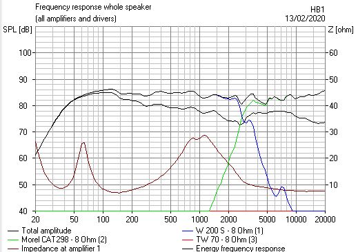

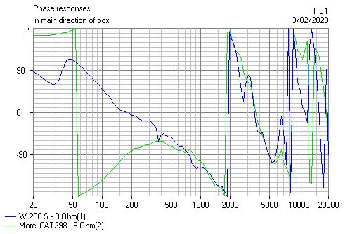

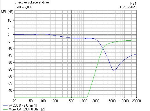

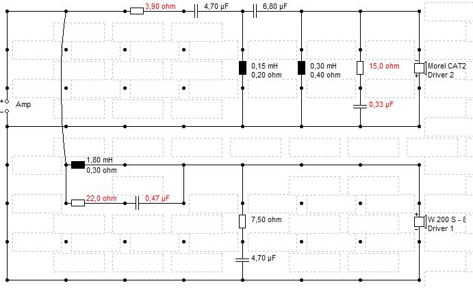

Having established you can do all sorts of things with these 8" bass speakers, including adding Monacor HT22-8 cone tweeters with a simple enough circuit, I want to update adding the 94mm Morel CAT298 soft dome. If you can only find the 104mm version, a bit of woodwork is required.
Some of the red components are optional, but certainly add something. The main event is we have to take down the more efficient Morel CAT298 by changing the 2.2R input resistor for the SEAS 19TAF/G to 3.9R. However you do the circuit, simple or complicated. That's a couple of decibels, and just stops it shrieking or getting overly intrusive.

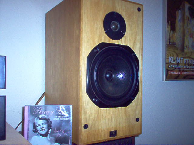

This project of mine is finally starting to happen. I’ve started to refurbish the boxes and will also redo the grills. I have ordered a pair of 19TFF and are planning to use the original bas drivers. After reading on the forum and looking at different crossover designs, I’m a bit confused and wonder if you cold confirm which of the designs will fit the original bas driver and the seas 19TFF? This would be very helpful!
Well done, Jonb87. Do your friends call you Sloop John B? 😀
Did you say the SEAS 19TAF/G metal tweeters were missing? I patched mine up with new ferrofluid from Blue Aran. Some models came with a similar soft dome.
Here's the original factory Monitor Audio crossover:
If I was doing this now, I would use this one:
I wouldn't worry about the exact bass coil value. 1.6mH to 1.8mH is nothing. You could probably reuse the 0.3mH too. Shouldn't make a huge difference, or you unwind it about 20% of the turns. I model with different but similar drivers quite often. Sheer laziness really. 😱
