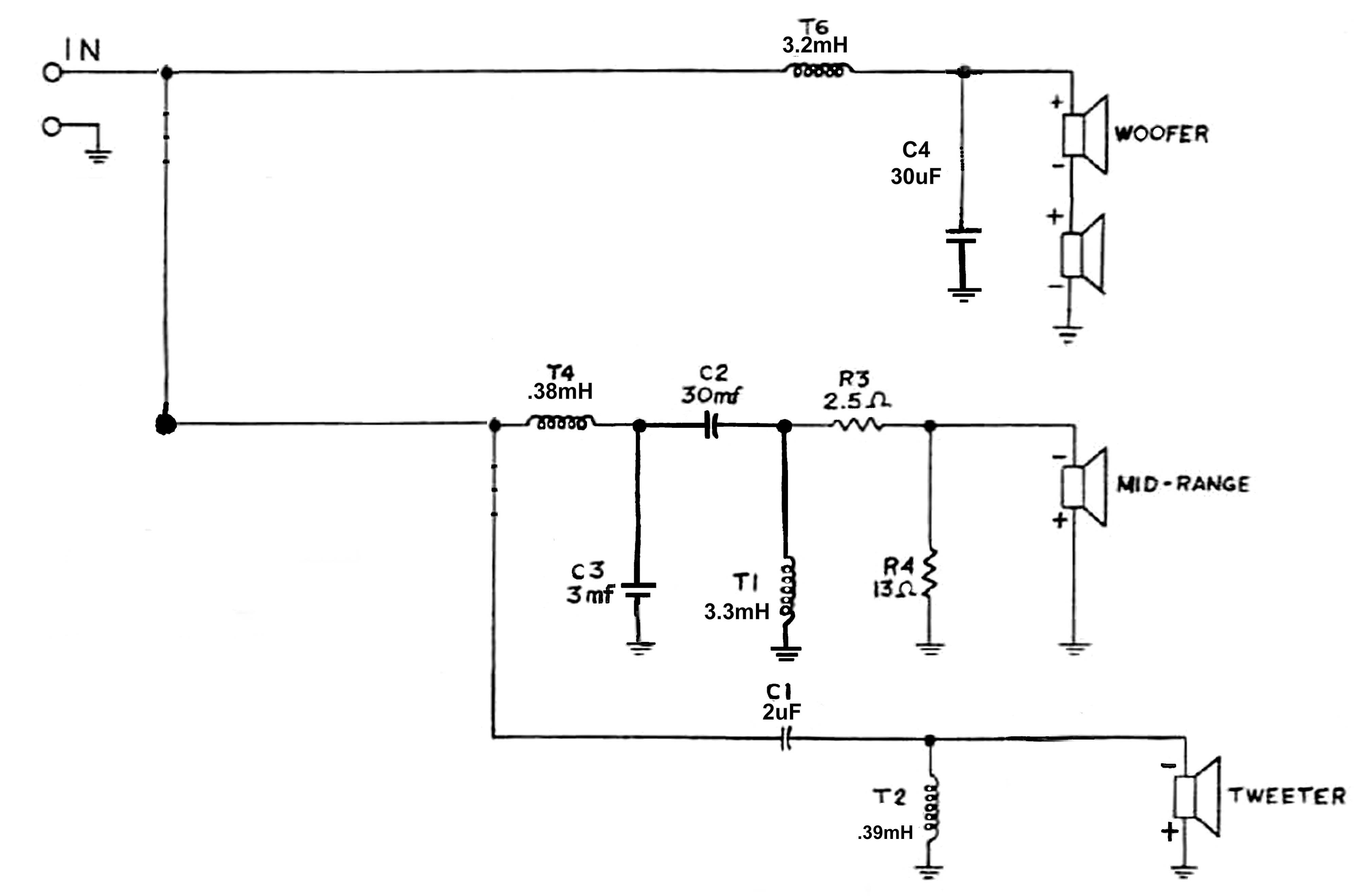

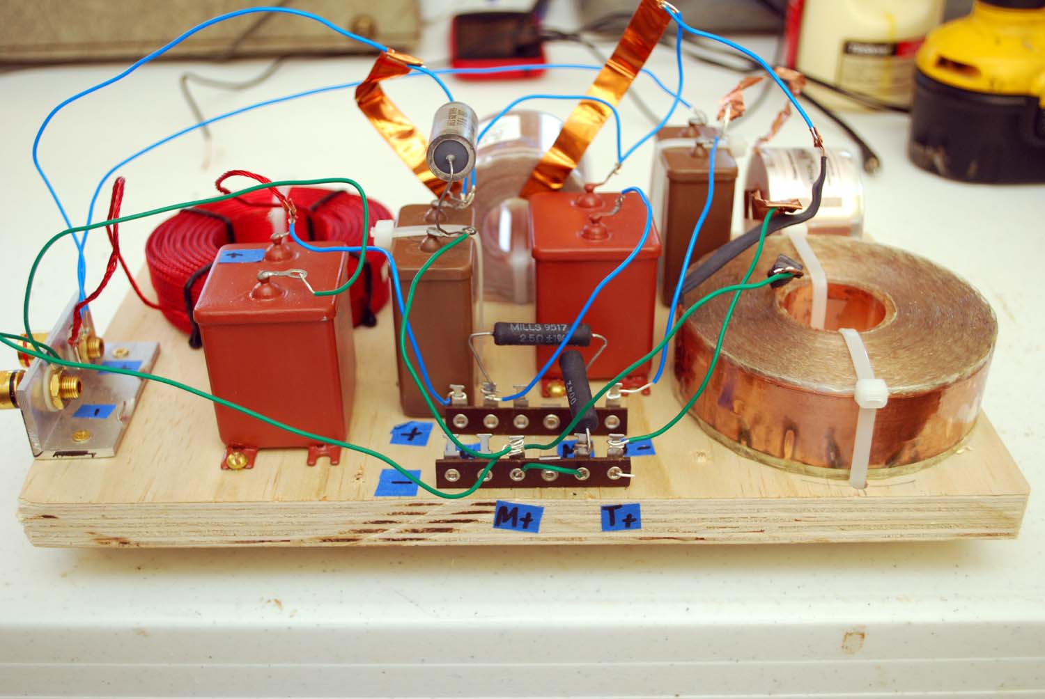

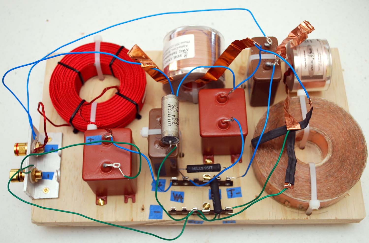

The crossovers are still a work in progress. Listen, rudimentary measurement, tweak. I am working out component values, size, layout. The current iteration sounds quite nice, and is a major improvement over the stock crossover with the caps replaced, even with minimal burn in, so maybe getting close. (The stock crossover is still in place, so it is a simple switching of wires to compare!)
I am trying to keep the crossover pretty simple, minimalist. Every time I try to get too complicated, I don't like the results. The finished crossover will take the place of the stock crossover enclosed under the mid horn.
I think this schematic is pretty close to what I am listening to now.

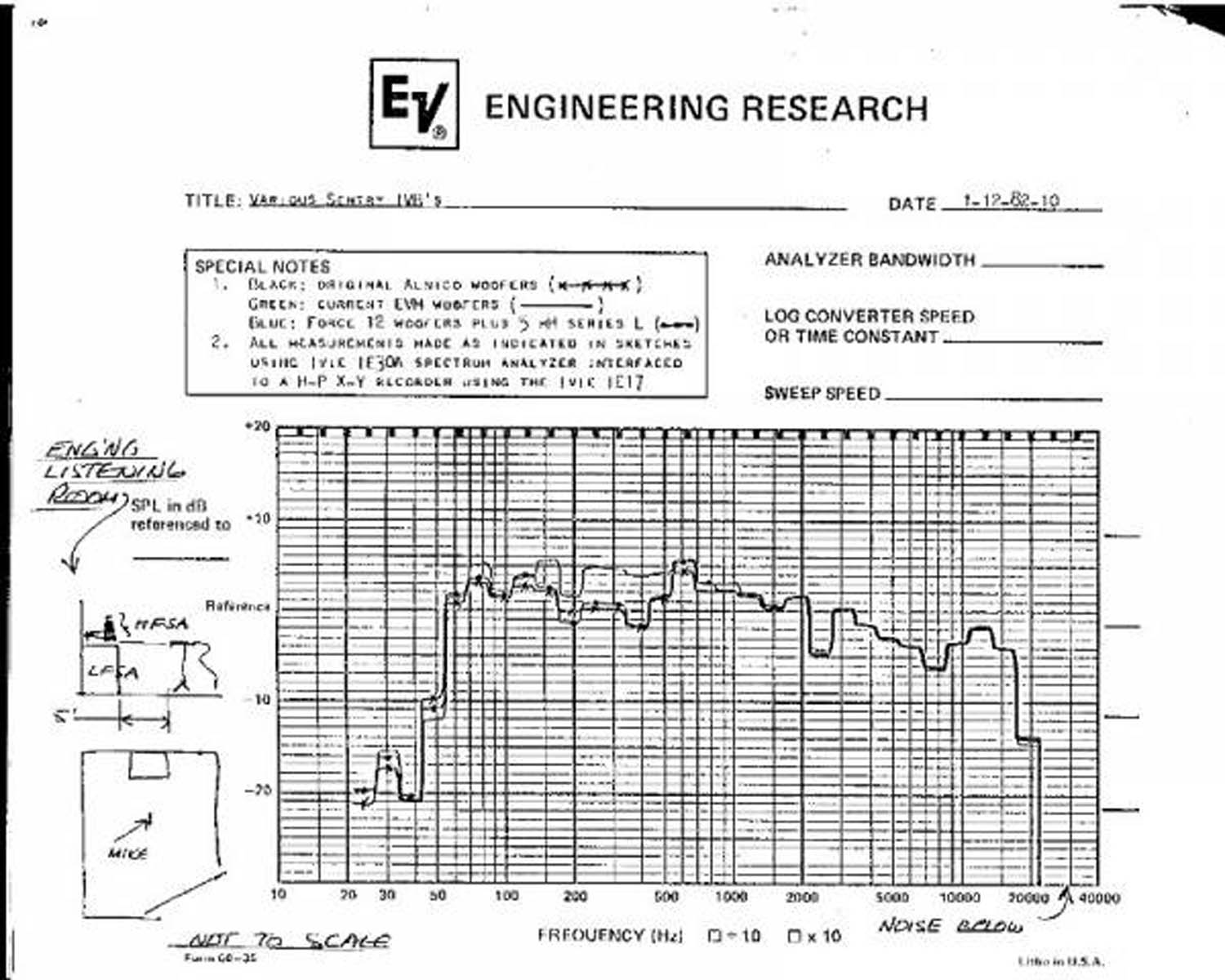

Here is an EV engineering frequency plot with three different woofers in the Sentry IVB:
Gefco, (Alnico)
EV ELM12
EV Force 12
Geary
(i uploaded that a long time ago -info came from Jim Long) - those are MBGO(?) - is that bass inductor nicer sounding than say a steel-core ERSE?
I may have pinched the freq plot from you! The 30uF caps are MBGO, the 2uf caps are KBG, the 1uF are Good-All PIO. The bass coil is Solen. I don't know how it would compare to the iron core Erse. I am running such low power, (45 & 2A3 SET's), that saturation is an unlikely issue.

I think that I am close to where I want to be with the crossover. I moved the tweeter high pass back to 4750Hz with a 3uf cap. This improved the treble presence which was a bit lacking with the tweeter crossed over at the 6750 with a 2uF cap. This is the schematic of where I am today.
I am going to play around with the 1uf cap paralleled with the 2uF caps for the mid and treble. I will then bypass the mid 30uf cap with small value film or PIO cap. (Thinking .22 or .33 uf).

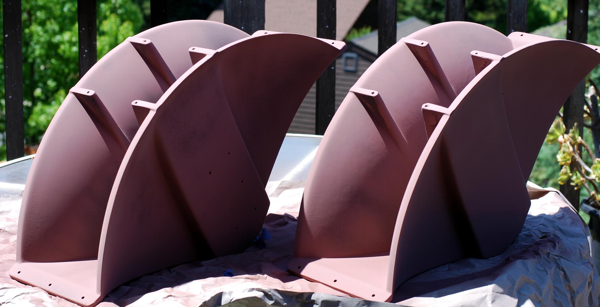

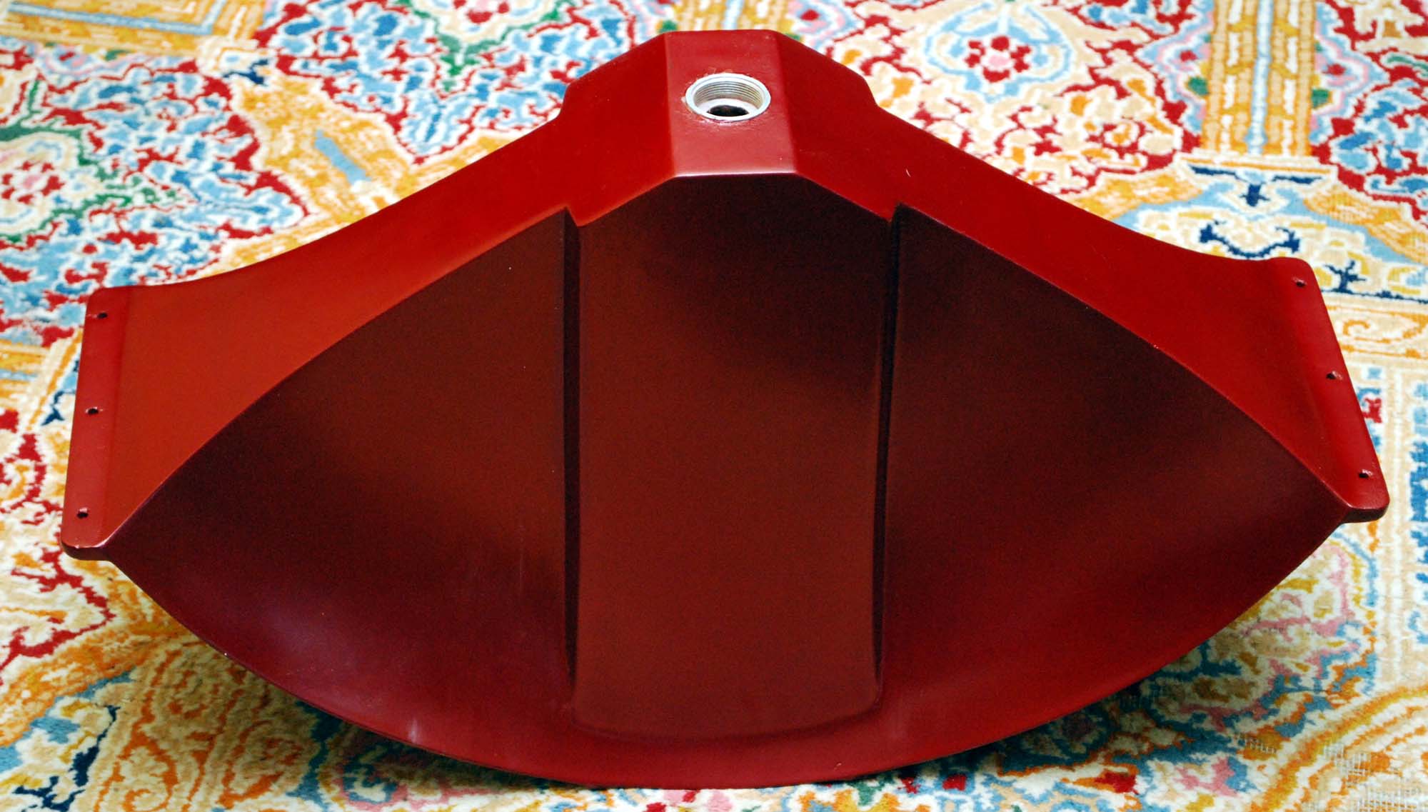

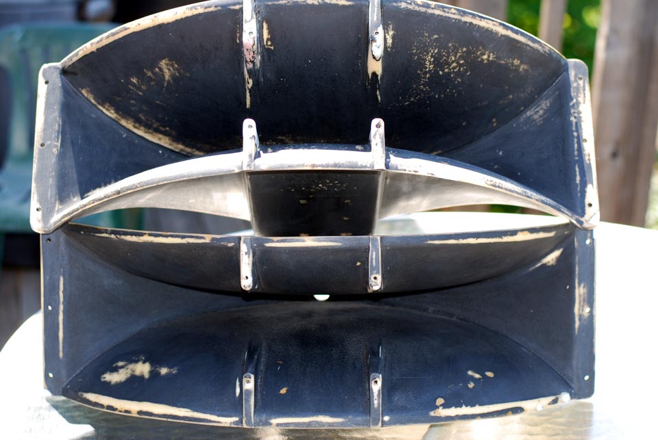

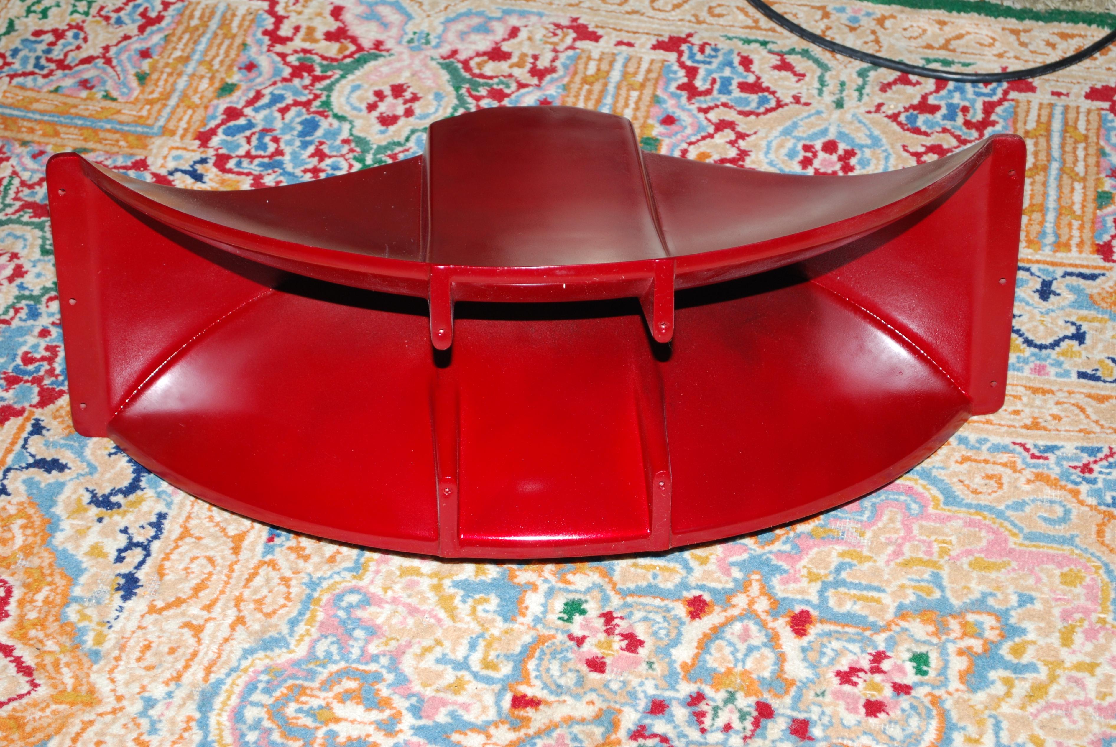

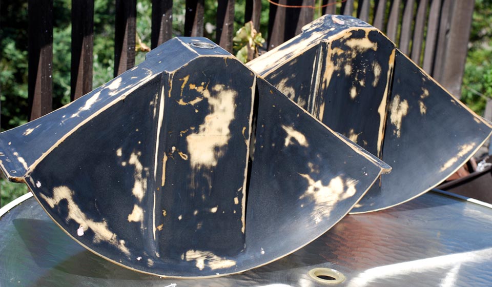

I have sanded down the mid horns and repainted them a 2 stage automotive cherry metallic. Just seems proper that 60/70'ish horns would be Cherry Red Metallic! 😱 There IS a REASON that EV splatter textured these horns. OMG there was no end to bumps, dropouts, pin holes and other blemishes from the molding process. Satin Black over heavy texture makes them disappear. Sanding the texture off, well....Every blemish I sanded and or filled made three more stand out proud!!
Here are some pics of the horns...

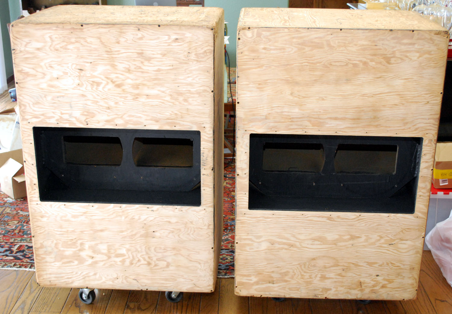

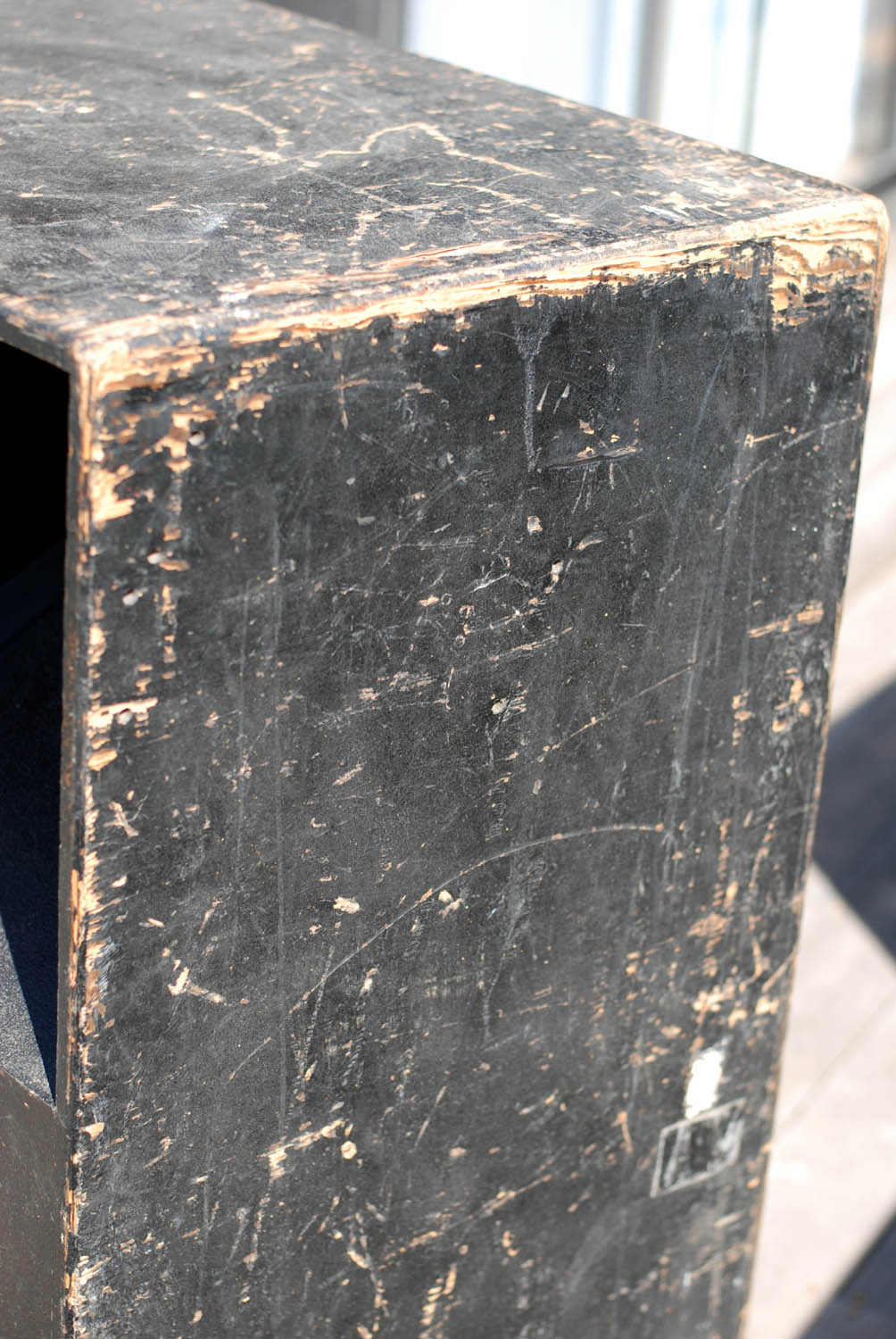

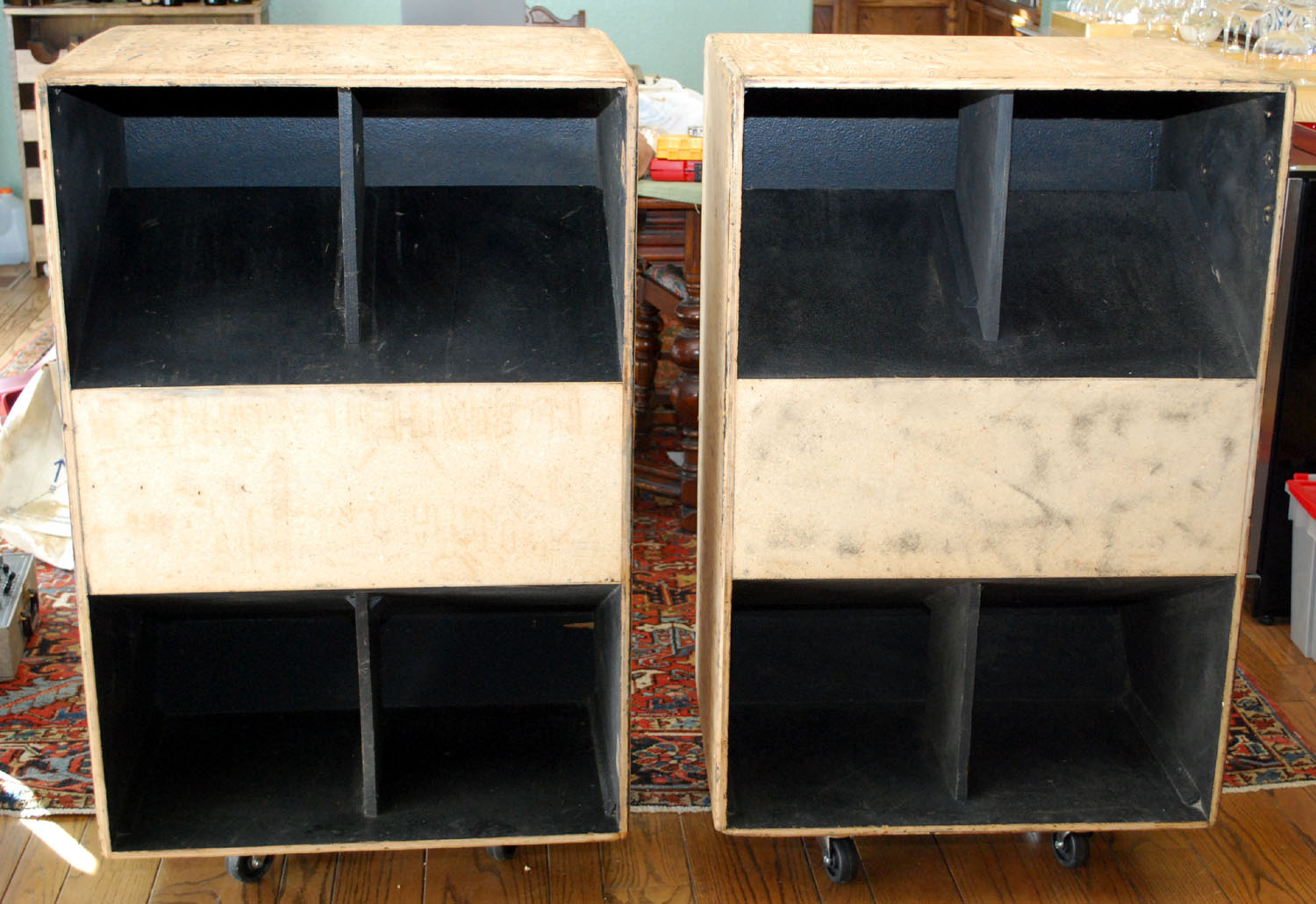

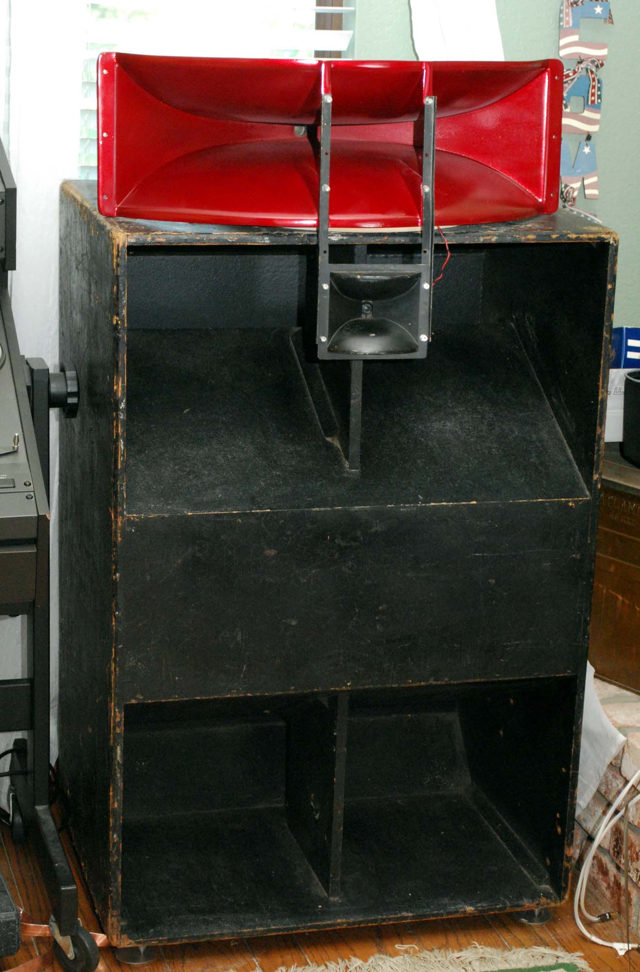

Stripped, Glues & Screwed!!

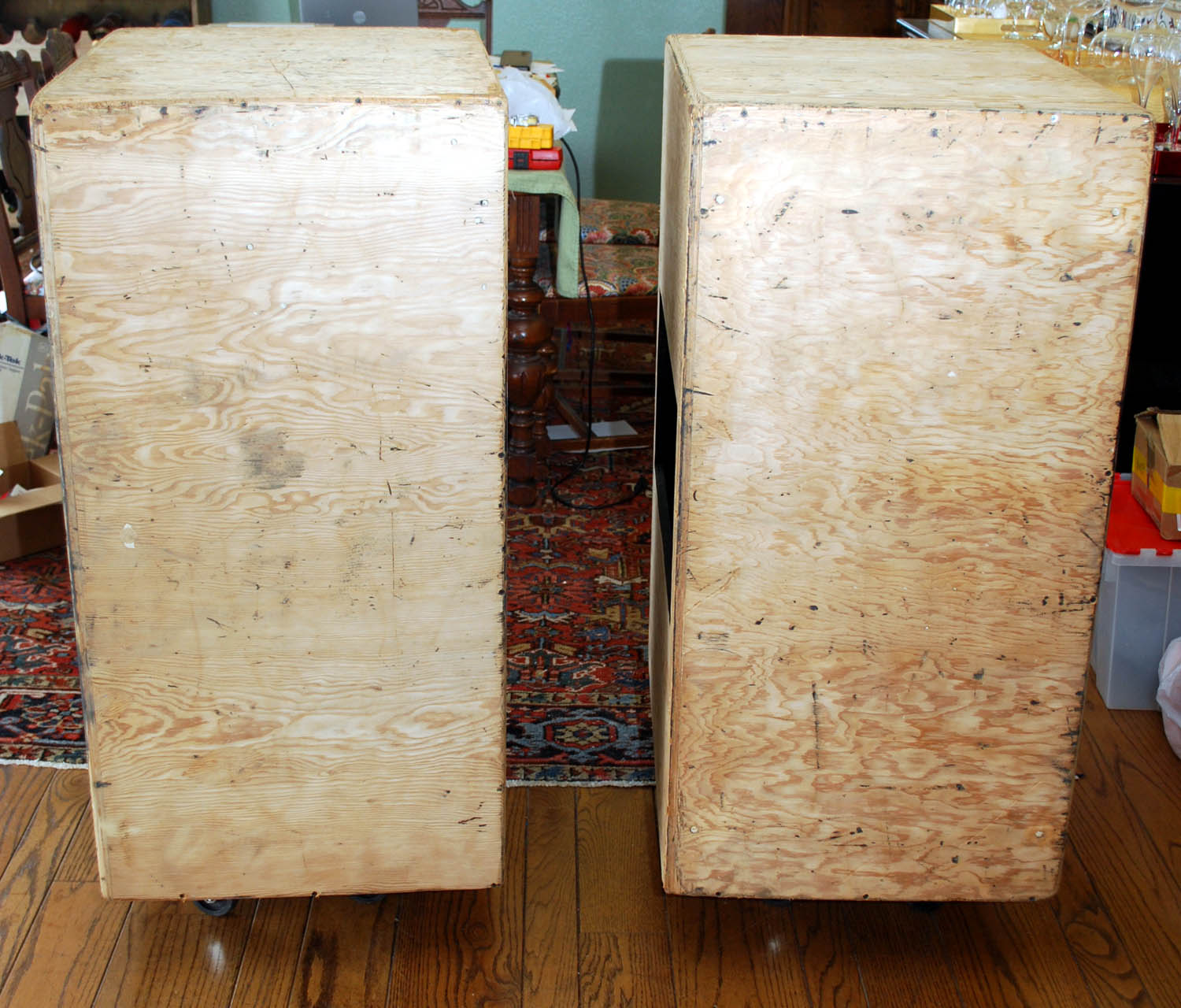

I have finished stripping the bass bins. Started with my belt sander. Not a chance. The EV finished gummed the belt almost instantly. Tried coarser belt, still not good. Had to drag out the 7" grinder and get sanding disks to fit. 80 grit and lots of changing disks, but worked. The factory coating was tough stuff!
I had to fill quite a few 1/4" and 3/8" holes in the sides. Must have been used to mount something(s)!? Dowels and glue, good to go!
The entire bass bin was stapled, mostly held up well except for the seems at the corners, (well all of the abuse occurs!). I glued and screwed the entire perimeter. I still need to fill the the countersinks holes and a few gouges and then sand again. Nice improvement in the "knuckle knock" test. Everything is and sounds solid. I will pick up the BB ply and cherry stock and start prepping to convert from beasts to beauties!
I air blasted the sanding dust and blew out the folded horns. I cannot believe the amount of crap that came flying out of the bins. Hell, that's got to improve the bass just having clean soundways!!!
